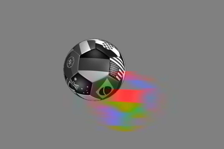

  12. Originally Posted by Okiba View Post
    I can see color bleeding.
    Here's a colorful ball on a grey background:
    [Attachment 54946 - Click to enlarge]
    Here's the same ball with the chroma shifted to the left and down by 100 pixels:
    [Attachment 54947 - Click to enlarge]
    The colors are still sharp but they are in the wrong location. Obviously, that's a much bigger shift than in your cap.
    VHS has another problem: chroma (colors) are saved at a much lower resolution horizontally, than the luma (grey scale signal):
    [Attachment 54948 - Click to enlarge]
    That causes the colors to bleed horizontally and small colored objects become desaturated.
    Here's the chroma both blurred and shifted so you can more easily see how blurry the chroma is:
    [Attachment 54952 - Click to enlarge]
    I was doing some research about Avisynth and post-processing, there was a way to shift pixel
    ChromaShift(), ChromaShiftSP().

  14. The colors are still sharp but they are in the wrong location.
    Thank you Jagabo for the detailed explanation of what Chroma Offset is! Is Chroma offset happening because the setup I'm using? or because the source? (the Video Camera?). Also, will I see the identical offset in all the footage I have been converting? (taking in mind it's all coming from the same Video Camera and being captured with the same setup)? If so, I wonder if I can take all the videos I have captured so far and correct them all at once.
    What about "Bleeding"? Is this again happening because of the Setup/Source I'm using? Can you fix that also like you can fix an Offset?

    I still need to understand if the problem with the Chroma offset identified by Lordsmurf happening because the video camera/setup. Because if it does, I can probably apply the same correction values to ALL the videos I captured. But if it's per footage, I will postpone that too for now.
    Are your final encodes for DVD video spec? You can go higher on the bitrate in Mpeg2 video if you dont plan on encoding to DVD video specs etc.
    No, I do not plan on using DVD at all. Once the restoration process is done, I'm assuming I will get rid of the loseless form and encode it to a smaller file. Following one of the guides - the original plan was to use Avidemux and set video output to be Mpeg-2 with constant bitrate (I don't know what the recommended bitrate if I'm not specifically going for DVD spec. I know it's 1500kbps for DVD). Interlaced TFF. The Audio to be AC3 with bit rate of 384 and the output format to be MPEG-PS. But this guide was specifically for DVD. I might need to check Hybrid as mentioned above, or tweak the Avidemux settings. While I do want to encode it to a smaller file - I don't want to hurt the quality.
    By the way. The original question for this post was answered. It sound to me like we talking about restoration now? perhaps I should open a dedicated topic there?

  25. Don't forget: everything you see on a modern TV screen is progressive. So your interlaced video is going to be deinterlaced one way or another when you watch it. The question is whether QTGMC is superior to what your player/TV can do. In most cases it is. Most TV's I've seen do something like Yadif.
    QTGMC isn't perfect -- no deinterlacer ever will be. But maybe someday TVs will get better than QTGMC (probably not soon, and probably not significantly) -- so save your interlaced source.
    Actually, I wasn't aware of that. I was sure modern TVs CAN display Interlace. So they do the conversion to progression on real-time?
