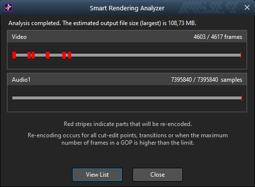

I ran it through TMPGEnc mpeg smart Renderer, does this help?
[Attachment 54931 - Click to enlarge] -
Oh yeah that's in sync and stuff. I probably should've added the section where the tape drops out, but it would've been a while until there would be someone on screen talking and that would make it more than 100mb.
Gonna try this software out on the full file. Is there a way I can output it without transcoding it? I really don't want to lose a lot of quality.Last edited by ENunn; 17th Sep 2020 at 17:25.
Ah, welp it ALMOST 100% fixed it!!!
It's out of sync at the end but it's in sync at the beginning. (through mpeg2source + dshow or ffaudiosource). I need it in sync for the whole vid.
