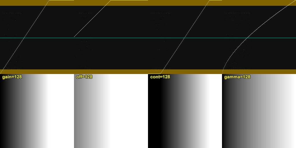

    Regarding ColorYUV(), put this in an AVS file and view the results:
    function GreyRamp()
       black = BlankClip(color=$000000, width=1, height=256, pixel_type="RGB32", length=512)
       white = BlankClip(color=$010101, width=1, height=256, pixel_type="RGB32", length=512)
       StackHorizontal(black,white)
       StackHorizontal(last, last.RGBAdjust(rb=2, gb=2, bb=2))
       StackHorizontal(last, last.RGBAdjust(rb=4, gb=4, bb=4))
       StackHorizontal(last, last.RGBAdjust(rb=8, gb=8, bb=8))
       StackHorizontal(last, last.RGBAdjust(rb=16, gb=16, bb=16))
       StackHorizontal(last, last.RGBAdjust(rb=32, gb=32, bb=32))
       StackHorizontal(last, last.RGBAdjust(rb=64, gb=64, bb=64))
       StackHorizontal(last, last.RGBAdjust(rb=128, gb=128, bb=128))
    function AnimateGain(clip vid, int gain)
    	ColorYUV(vid, gain_y = gain)
    	Subtitle("gain="+String(gain))
    function AnimateOff(clip vid, int off)
    	ColorYUV(vid, off_y = off)
    	Subtitle("off="+String(off))
    function AnimateCont(clip vid, int cont)
    	ColorYUV(vid, cont_y = cont)
    	Subtitle("cont="+String(cont))
    function AnimateGamma(clip vid, int gamma)
            gamma = gamma < -255 ? -255 : gamma
    	ColorYUV(vid, gamma_y = gamma)
    	Subtitle("gamma="+String(gamma))
    #ImageSource("grayramp.png", start=0, end=512, fps=23.976)
    GreyRamp()
    ConvertToYUY2(matrix="PC.601")
    v1=Animate(0,512, "AnimateGain", -256, 256)
    v2=Animate(0,512, "AnimateOff", -256, 256)
    v3=Animate(0,512, "AnimateCont", -256, 256)
    v4=Animate(0,512, "AnimateGamma", -256, 256)
    StackHorizontal(v1,v2,v3,v4)
    TurnRight().Histogram().TurnLeft()
    ConvertToRGB(matrix="pc.601")
    [Attachment 54919 - Click to enlarge]
    Things to note:
    1) With gain_y 0 always remains at 0. The rest of the values are multiplied by the same amount.
    2) With off_y the same values is added or subtracted from all Y values. The slope of the line doesn't change.
    3) With cont_y 128 remains at 128. All other values are multiplied by the same amount. Note the slope of the line is the same as with gain_y, just the mid point changes. Any cont_y value can be achieved with a combination of gain_y and off_y. For example, ColorYUV(cont_y=256) gives the same result as ColorYUV(gain_y=256, off_y=-128).
    4) With gamma_y 0 and 255 stay where they are. Between those the line is bent to increase or decrease shadow detail.
    5) In all cases the final output values are clamped between 0 and 255.
    I got an error when I loaded that script:
    "Script error: Invalid arguments to function 'animate'.
    line 48
    I was able to fix it by adding "last" to each animate function. It appears to now be doing what you intended.
    v1=Animate(last, 0,512, "AnimateGain", -256, 256)
    v2=Animate(last, 0,512, "AnimateOff", -256, 256)
    v3=Animate(last, 0,512, "AnimateCont", -256, 256)
    v4=Animate(last, 0,512, "AnimateGamma", -256, 256)
    I'm not sure why it didn't work for me if it worked for you but I have you to thank for even knowing to try to put "last" in there With that, one thing I don't understand is why I can use "last" every time, and in each case it's still referring back to the original GreyRamp rather than the line above (i.e. why doesn't v2 line refer to v1 as "last")
    Anyway, this is extremely helpful. You should be a teacher. Thank you!
    The script specifies a name for the output of each call to Animate(): v1, v2, v3, v4. So the output of each Animate() is a new stream. Last remains unchanged.
    Just to be sure... are you seeing animations like in the attached video?
  11. Yup! That's exactly what I see when I run it. I'm using AviSynth+ 3.6.1. Syntax for Animate shows it needs a clip as the first argument... maybe your version assumes last for clip if it's not there, and mine doesn't.
    I get what you're saying about "last" remaining unchanged if you assign a new name for outputs that come after it. Originally I just thought it referred to the last thing in the line above what you were doing even if you had given it its own name. Thanks once again.

    /* Color correct and fix levels, temporarily enable histogram for checking */
    Tweak(bright=0.0, hue=0.0, cont=1.0, sat=1.0, coring=false)   #bright=blacks, cont=whites
    #Levels(16,1.0,235,0,255,coring=false)                        #stretch black and white points out from input to output   ex. 16 down to 0, 235 up to 255
    ColorYUV(gain_y=0, off_y=0, cont_u=0, cont_v=0, gamma_y=0)    #analyze=true to display values

  13. Some very old players had troubles with superblacks and superwhites -- rendering them with grossly incorrect colors (a superblack might show as white, and vice versa). I haven't seen any modern player do that. I would leave coring=false, especially if you are going to follow up with more levels adjustments.
    Oh, when appending clips with audio you should use ++ instead of +, to assure A/V sync.
    intro.fadeio0(30)++last.fadeio0(30)
  14. Good to know! I revised my script above to include the ++. THANK YOUUUUUU!
