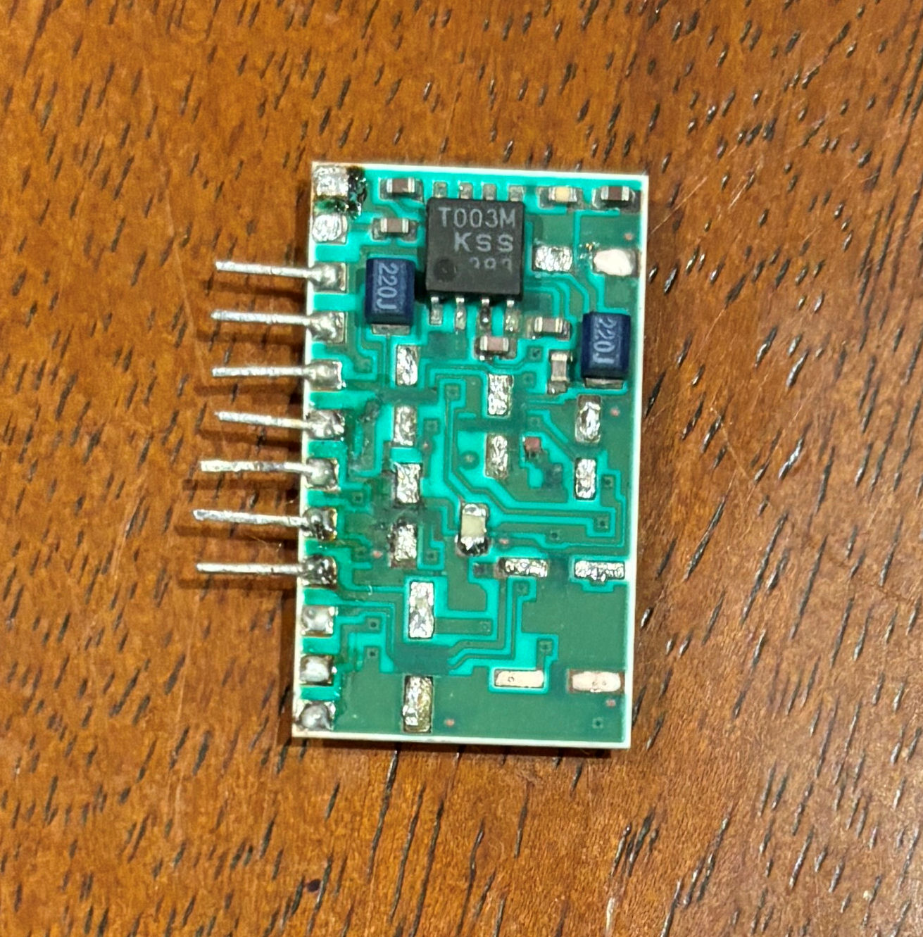

    On the AG-1970's there is a small surface mount board which is made out of glass, trying to heat or replace capacitors on this, is very hard. No matter how good you are. There is a very good chance this board gets wrecked and the only way you are getting a replacement is another unit.

    My thoughts are after 30 years I am willing to bet your AG-1970 does not run properly. You can just do a simple test and press play and press stop over and over and just watch how the color levels dramatically changes and same with turning the TBC on and off. The tighter the color levels the better the work that was done to the machine and since nothing has been done to your machine the levels will be off.
    Other than this glass board in the AG-1970 and the Y/C card it is a similar to the AG-1980. The power supply for the most part in the AG units are pretty good but again it is this glass board that if one starts messing with well it is easy to crack and you have a 50/50 success rate on the job itself.

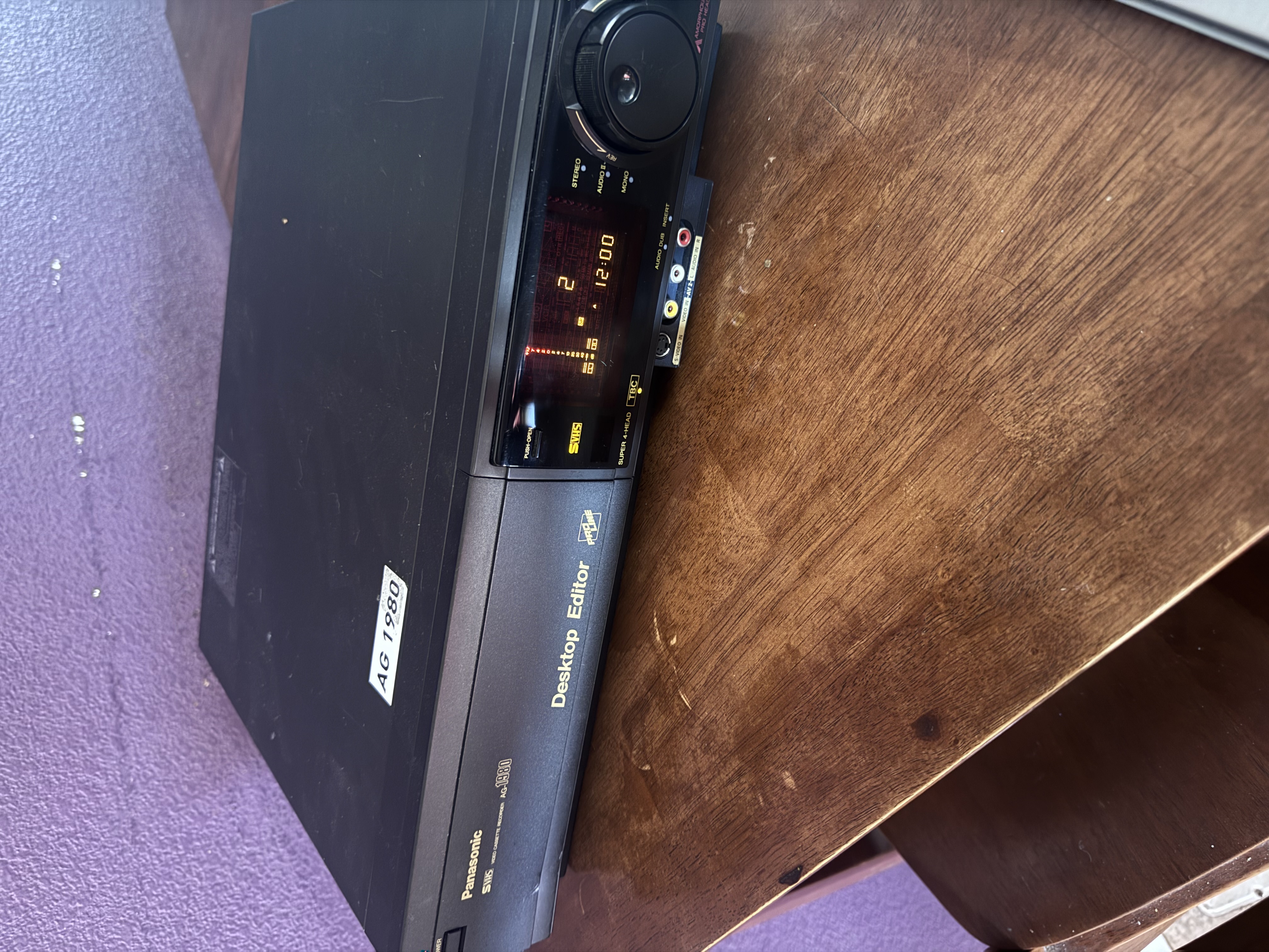

    Jun 2025
    Hello, I’m fairly new to this whole VCR restoration scene. I came across your thread post and I am interested in getting a Panasonic AG 1980 P fully restored it already works. I have noticed though even after cleaning the head and doing basic cleaning on the heads, there is still some artifacts that ripple, and there is a consistent strip at the bottom that is fuzzy. I tried reaching out sending you a message but because my account is so new it’s not letting me. I hope that I can get a hold of you. I am really trying to get this thing fully restored. Please reach out to me. I am very interested in sending this over and getting it worked on👍🏻
