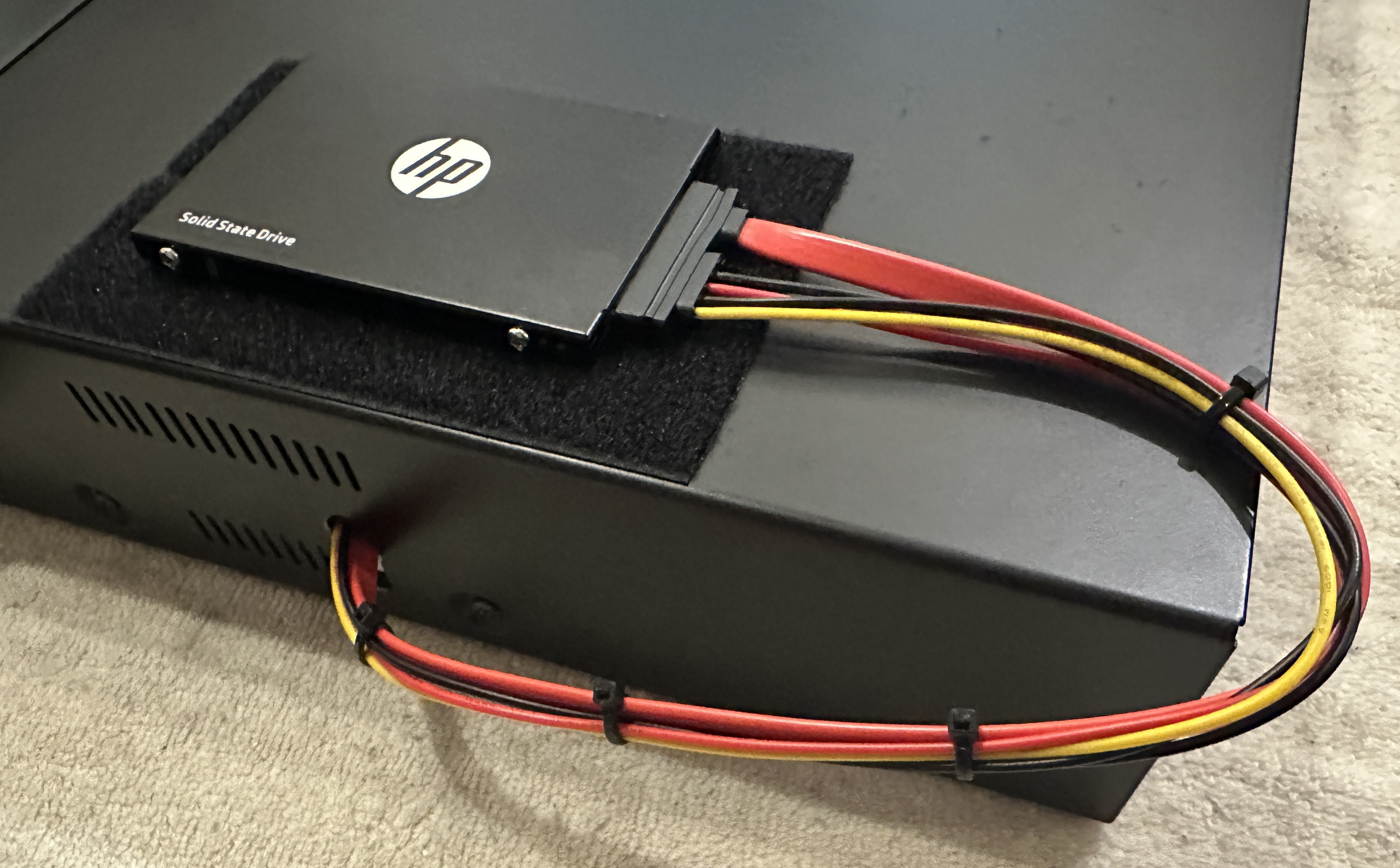

  27. I do think MPEG2 is an interesting format mainly if you want something viewable with relatively small file size and limited steps after capture and if you treat it as its more of a space saving/delivery format. Jwillis84 used to post quite a bit about various DVD/HDD recorders and how he was rather impressed with the quality of certain machines. Since I value his opinion quite a bit, I've been diving into that rabbit hole recently. One of my main curiosities is how some of those HDD recordings do against say a lossless or ProRes422 capture that is then later converted to MPEG2 in software. Either way, I could see doing simultaneous captures with an HDD recorder at the same time as doing the more bitrate-intensive captures since there's really no harm.
    I made a post yesterday on the topic over at digitalFAQ based on a capture from 2006 that someone did on the machine I acquired: https://www.digitalfaq.com/forum/video-capture/15077-hdd-recorders-quality.html
    The sample there takes up roughly the same space as what an elgato video capture would. My guess is that viewing-and-listening-wise the HDD MPEG capture should look a lot better though.
    Eventually I'll post comparison captures of the highest bitrate the XS34 can do (it's 8000kbps or 9200kbps depending whether using digital audio or not) against lossless, ProRes422, ProRes422 converted to MPEG2 at the same bitrate, and the Elgato video capture just for fun.
    I hadn't really considered HDD recorders before because it sounded pretty annoying to have to go get files off of the IDE HDDs inside, but I came across some other threads that showed they often can be converted to using SATA drives or even IDE to SD card adapters in some cases and those are much easier to relocate outside of the case like the attachment shows.
