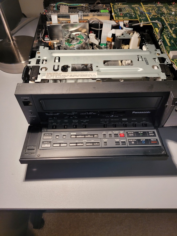

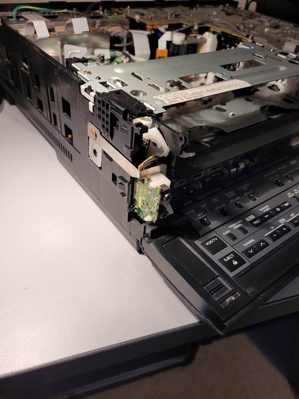

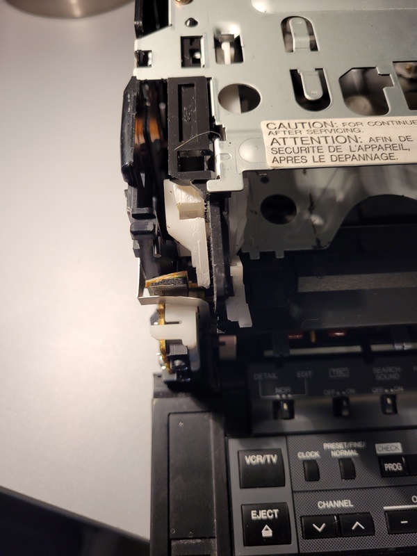

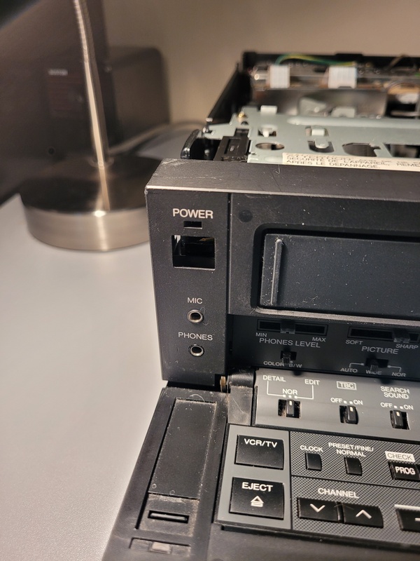

  4. Member Deter's Avatar
    Dec 2007
    So you do all this work and ship the unit back and the shipping company breaks the machine than you file an insurance claim and they never pay. Had two spare units but used these parts on other machines. This is really not that hard to fix but with no extra parts it is impossible. FedEx did this twice last year on these front panels, the 1st one was worse than this but I had the parts.
    [Attachment 63880 - Click to enlarge]
    [Attachment 63881 - Click to enlarge]
    [Attachment 63882 - Click to enlarge]
    [Attachment 63883 - Click to enlarge]
    What carrier, what insurer?
    Fedex for both?
    Part of the problem is packaging. You have to package decks understanding that hamfisted goons handle boxes. Those Lowe's heavy duty moving boxes are pretty good. You can also double box, and the larger heavy duty boxes from Sam's Club outside the Lowe's box. I've had to do this several times, especially shipping USA>Canada, where the contents are both larger and heavier.
