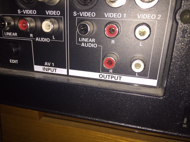

    If the audio board was not connected the s-video port wouldn't work either so you wouldn't get a picture. That is why this is 100% fishy to me.
    What is you audio hooked up to? An Amp? Do you have it set to the correct ports? If an amp is the amp set to the correct output for playback? I know the Pioneer amps the older ones can be a pain. I use a Yamaha receiver.
    Try another set of RCA cables
    Try both ports as shown in this picture
    Than set the audio meter up on the front panel. Than hook like a CD player or DVD player up and try to run the Audio through the unit and see if you hear noise.

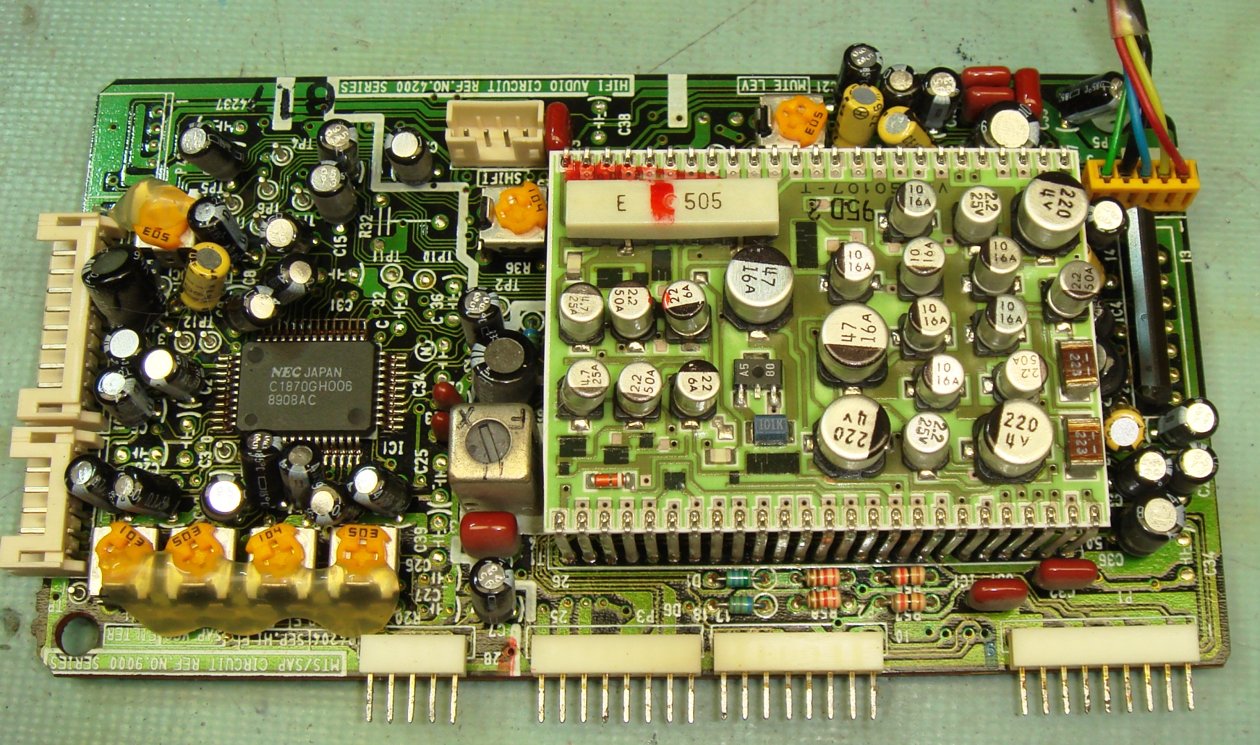

    What I can say about this unit someone worked on just the Y/C card before but other than that this machine was an absolute train wreck and a giant mess. The loading was all screwed up, the jog wheel and it had a lot of internal damage. When I ran the unit the audio was fine. Whatever the case I will fix it but try these things first.
    [Attachment 60708 - Click to enlarge]
    [Attachment 60709 - Click to enlarge]

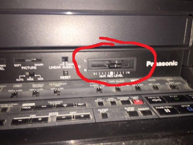

    I tried connecting three devices to the 1980 inputs: a vinyl player with phono/line out (tried both), and a Zoom F8 field recorder and Behringer UMC404HD audio interface with a variety of RCA/TRS/XLR outs and levels. I tried two sets of RCA cables, first into one of my other 1980s to ensure everything went through properly, then on this unit. I tried both the front and rear inputs. Still no luck unfortunately.
    Correct me if I'm wrong: doesn't the HiFi REC Level Control only apply to recording to tapes? I did try it at 5 (which I assume is unity gain?) as well as 10 anyway with no effect.
    Thanks for all your hard work and for presenting possible solutions here. If there are no other suggestions I'll send it back to get the audio fixed some time this week.

  30. Originally Posted by Tig_ View Post
    Yes and no.
    Officially yes, it only affects the recording level for the HiFi tracks when recording a tape (the linear track has its own separate ALC circuit).
    Practically, the level controls are useful for several other "off-book" purposes. They will boost or cut the audio level of all input sources passing thru to the outputs, at least on my examples, making the 1980 a handy external "audio level adjuster" when patched between a source VCR playing a low-volume tape and a capture device (like a dvd recorder) with no incoming manual level control. Why use such a kluge? Because a 1980 with properly functioning audio board boosts or cuts level much more cleanly/transparently than the typical muffled noisy budget Behringer etc mixer. Anyway, the point is the sliders and level meters should appear to operate regardless of whether you are engaged in record mode or not, or with no tape loaded at all.
