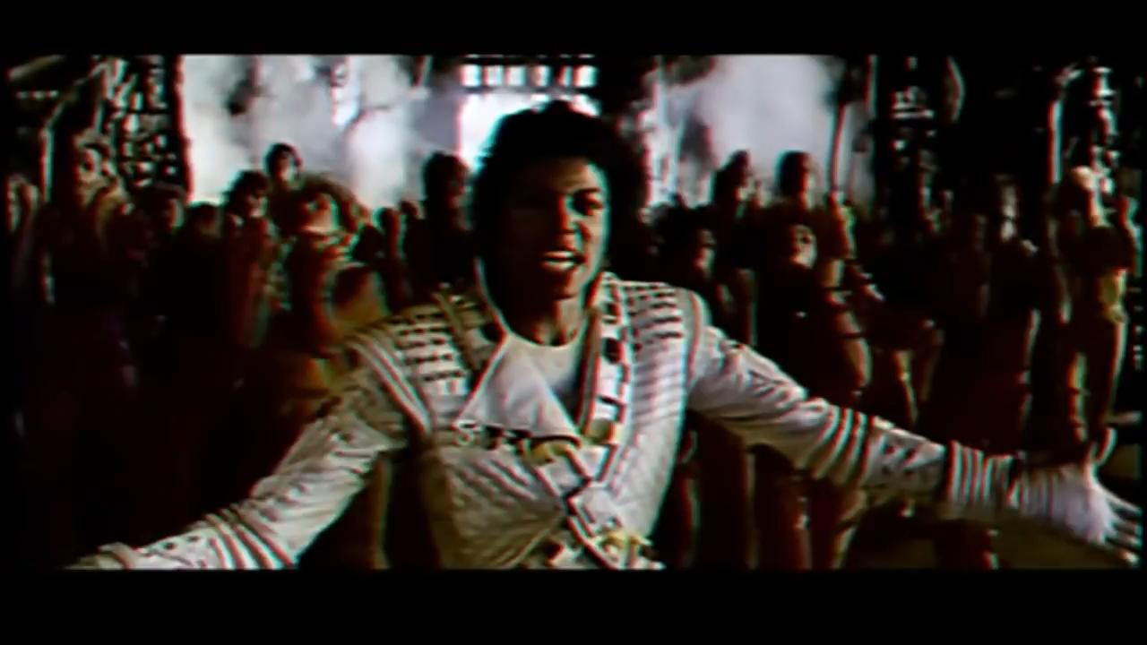

    As a reference here's the sample of the file you provided:
    [Attachment 54885 - Click to enlarge]

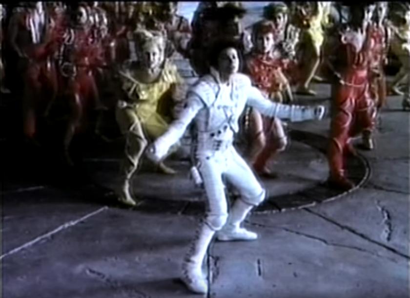

    And a similar frame from a normal 2d youtube video:
    [Attachment 54886 - Click to enlarge]

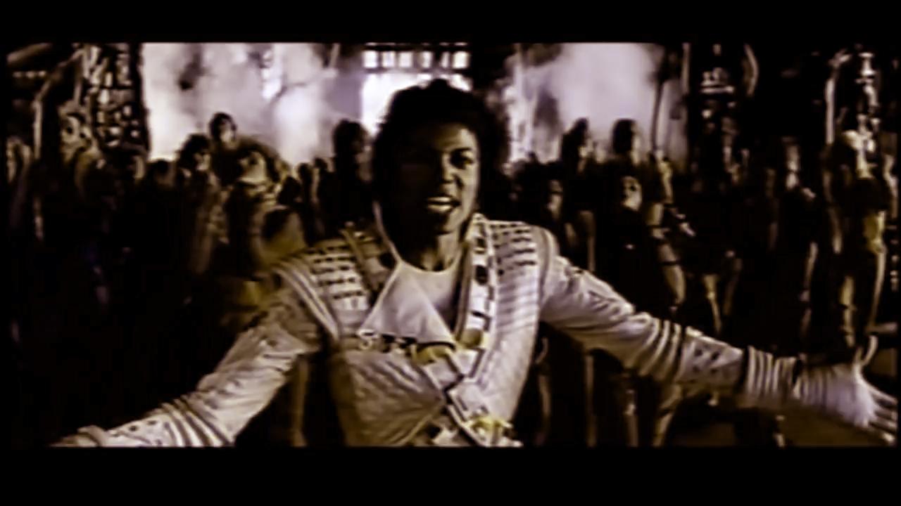

    [Attachment 54882 - Click to enlarge]
    Of course, the result is a greyscale video. But at least all the annoying colors are gone.

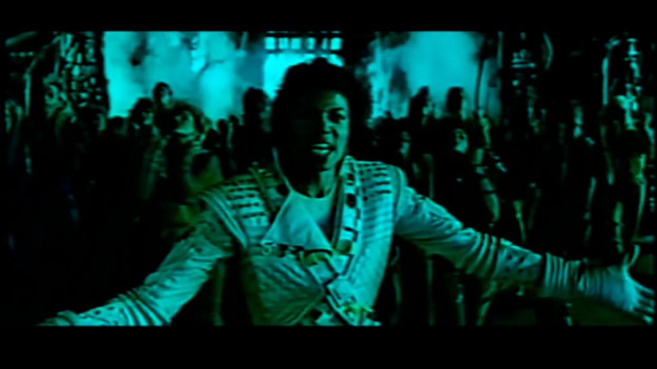

    You could just remove the red channel leaving green and blue. With a normal color anaglyph you would be left with only the right view, but with just shades of cyan:
    LWLibavVideoSource("Captain EO - HD.mkv")
    ConvertToRGB(matrix="rec709")
    RGBAdjust(r=0)
    [Attachment 54881 - Click to enlarge]

    Maybe try to bring out more color by manipulating the substituted red channel:
    R = ShowGreen().RGBAdjust(rg=1.3, gg=1.3, bg=1.3)
    G = ShowGreen()
    B = ShowBlue()
    MergeRGB(R,G,B)
    [Attachment 54884 - Click to enlarge]
