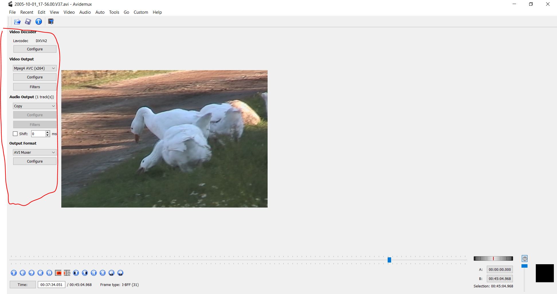

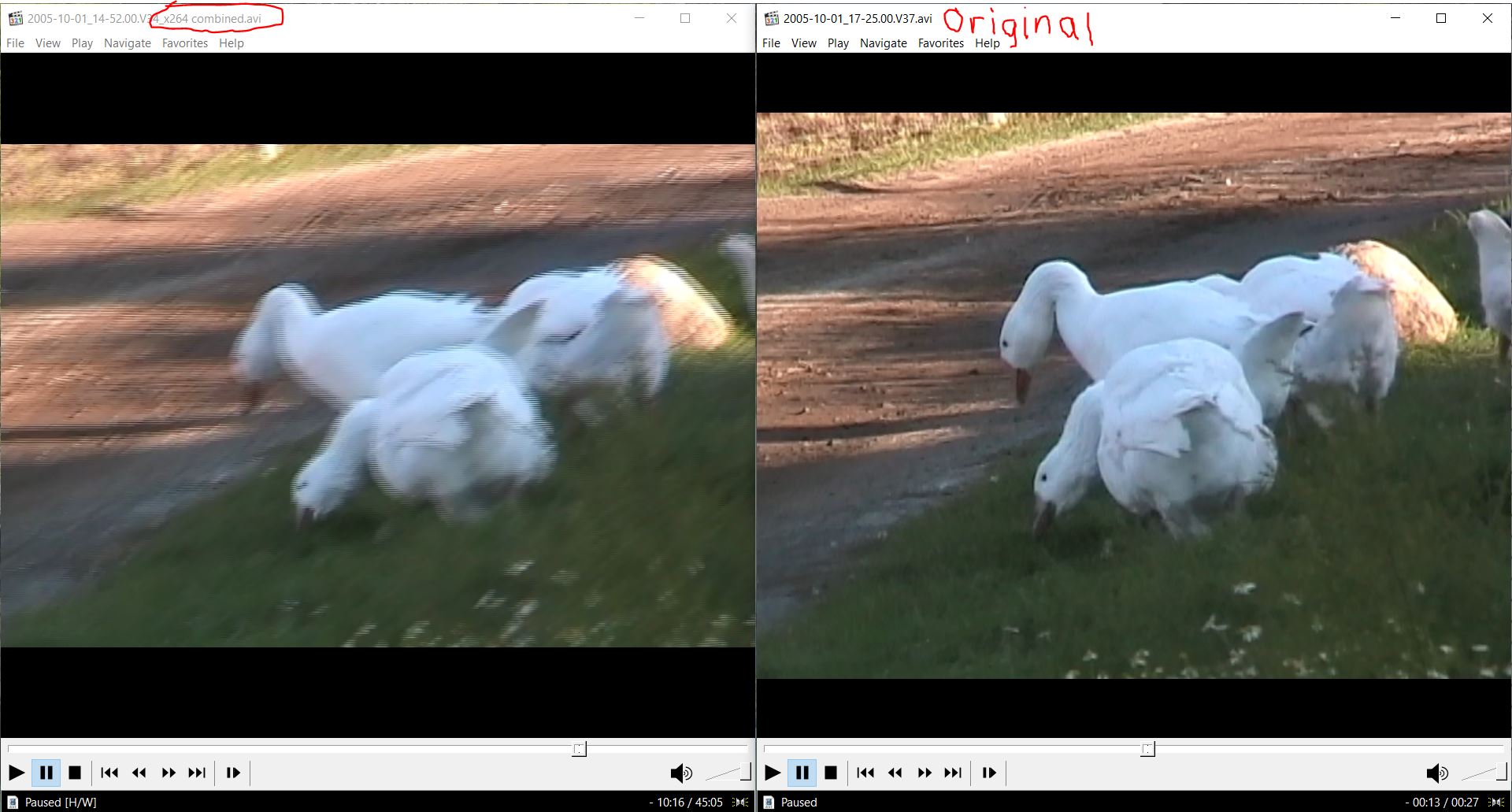

Thanks. I tried that (settings picture attached). But as you can see, the combined and compressed version has horrible aliasing compared to when I play the file that came straight from my minidv camera.
[Attachment 54853 - Click to enlarge]
[Attachment 54854 - Click to enlarge] -
Did you encode interlaced ?
For avidemux -
Push configure > frame tab > checkmark interlaced, bottom field first (DV is BFF by convention)
Also, AVC in MP4 container (instead of AVI container) will probably be supported by more software and hardware players
Also, don't for get to set the aspect ratio ( native DV is never "square pixel") . It's in the output1 tab in the configuration -

Im going to go with x264 in mkv container.
@poisondeathray solved my issue: I was not encoding as interlaced - BFF which was why videos had aliasing after (but not before) processing.
