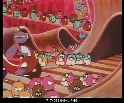

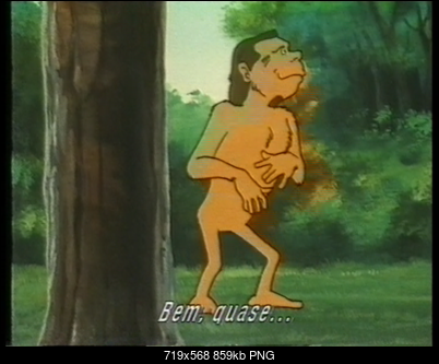

    Here's a few examples or interlacing artifacts I get using your first suggestion:
Name:	interlaced artifacts.png
Name:	interlaced artifacts 2.png
  12. Those are chroma artifacts from handling interlaced chroma as if it is progressive. I suspect a ConvertToYV12() without interlaced=true. Or maybe the problem is in the source (your sample video was very messed up by your capture method). Upload a sample with those frames. And your entire script.
