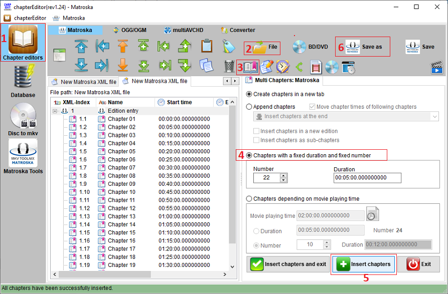

    With ChapterEditor you can get it 5 min chapters ...

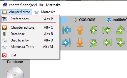

    Menu->Chapter editor ->preferences->External programs: Path MKVtoonix (32bit)
    In the image-> Chapter editor-> File->Multi chapters->Insert chapters->Save As..->and select the same input mkv
