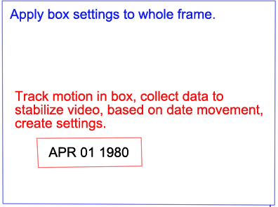

    This is the idea to restore the jittering video:
    - track motion based on the date
    - apply correction, based on the target track, to the entire frame
    I thought I'd been clear about this, but apparently not?
    There appears to be ways to target DePanEstimate, therefore stab(), with commands mentioned earlier.
    Or maybe it can be done with some sort of cropping, then somehow applying stab() to the entire frame, not just the crop box within that frame.
    I know this can be done, just not sure exactly how. Again, After Effects does it, just lousy.

  27. Originally Posted by lordsmurf View Post
    [Attachment 54829 - Click to enlarge]
    I quit tracking this thread, but came back and saw this.
    What you ask for, and what you show in the diagram is exactly what Deshaker can do. In the guide I wrote for it fifteen years ago, that was one of the things I highlighted. The guide used to be all over the Internet, but it's hard to find now so I've attached both the DOC file, as well as a zip file that has the doc AND the images.
    The short version is that you specify your box using the "ignore image area" settings in pass 1. You will want to ignore everything outside the date. This will force Deshaker to create stabilization vectors using only the information from the area occupied by the date. Deshaker saves this data in a LOG file after you do pass 1. The actually stabilization is done in pass 2 using the vectors in that LOG file. Before you actually run pass 2, you eliminate the numbers you put in the "ignore" boxes so that pass 2 affects the entire video.
  28. Video Restorer lordsmurf's Avatar
    But isn't Deshaker really, really, really slow compared to the stab() method used here?
    And doesn't it overlook the interlace aspect?
    So not quite the solution needed here.
    That said, this is good to know abut Deshaker, for potential future needs. I like Mercalli far more than Deshaker, but it's not possible (that I know of) to target. That Deshaker can target (something I may have known years ago, but forgot) is worth giving it another look.
    So thanks.
  29. Deshaker is not particularly slow. It is one of the better stabilization programs out there. I own Mercalli, and I still use Deshaker for some projects. It works with interlaced: if you took the time to glance at the image files that I uploaded in my last post, in the very first set of controls, you'll see that it is set for interlaced, bottom field first. In fact, it is one of the more "interlace aware" stabilization programs out there.
    Even if you don't like the workflow, I'd recommend at least trying it since, as I pointed out, it does EXACTLY what you asked for.
