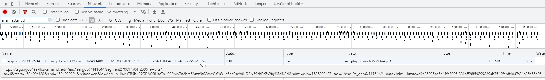

    I'm trying to download the video that can be found at this link: https://player.rts.ch/p/rts/livecenter?urn=urnwisstxt:video:rts:1690681
    Following the directions in this forum, I searched for "manifest.mpd" in Chrome and came across this link: https://srgssrgop19a-lh.akamaihd.net/i/enc19a_gop@141644/segment270817504_2000_av-p.ts...37f24e86b55a2f
    [Attachment 59828 - Click to enlarge]
    However, impossible to download it with the two proposed solutions, it downloads me instead a "segment270817504_2000_av-p.ts" of only 1.4 MB.
    Do you have any idea how I could download the entire video? It would be VERY GREATLY appreciated !!

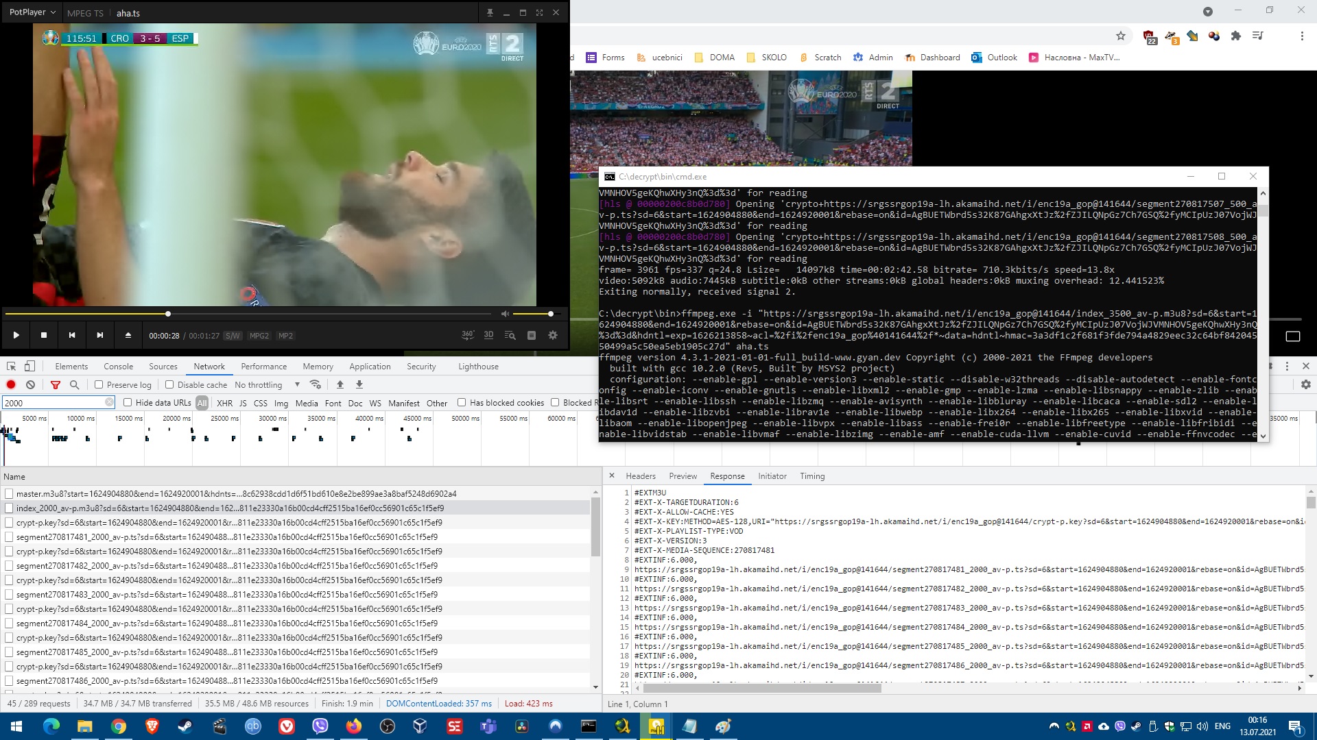

    ffmpeg.exe -i "https://srgssrgop19a-lh.akamaihd.net/i/enc19a_gop@141644/index_3500_av-p.m3u8?sd=6&start=1624904880&end=1624920001&rebase=on&id=AgBUETWbrd5s32K87GAhgxXtJz%2fZJILQNpGz7Ch7GSQ%2fyMCIpUzJ07VojWJVMNHOV5geKQhwXHy3nQ%3d%3d&hdntl=exp=1626213858~acl=%2fi%2fenc19a_gop%40141644%2f*~data=hdntl~hmac=3a3df1c2f681f3fde794a4829eec32c64bf84204550499a5c50ea5eb1905c27d" aha.ts
    [Attachment 59829 - Click to enlarge]

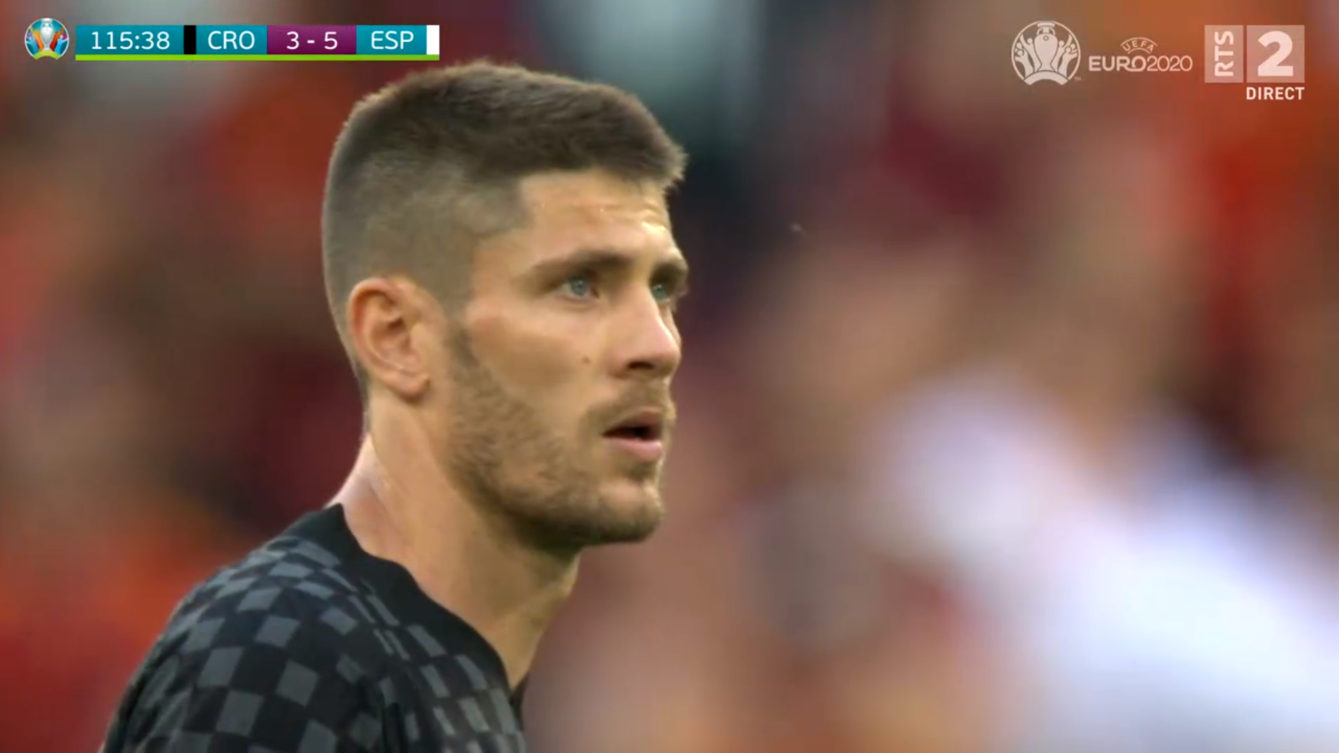

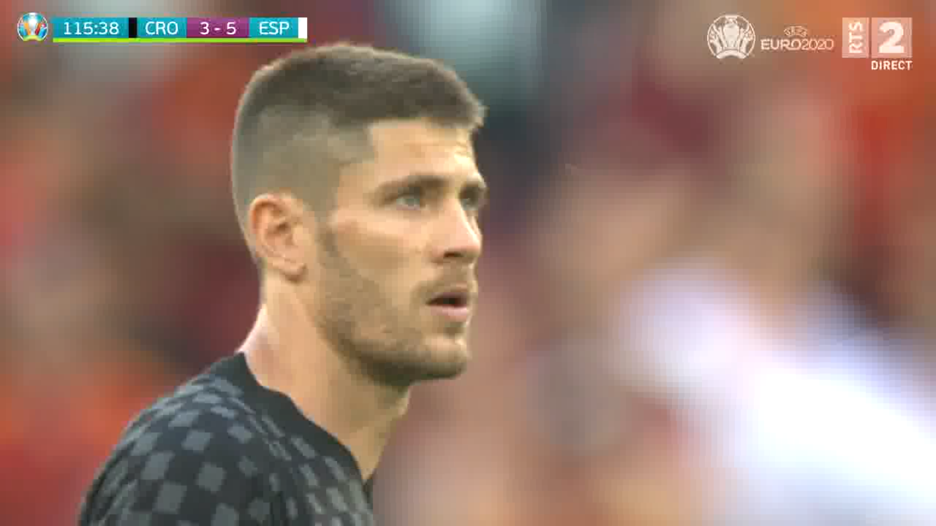

    Here is screenshots of :
    the online video
    [Attachment 59835 - Click to enlarge]
    and the downloaded file
    [Attachment 59836 - Click to enlarge]

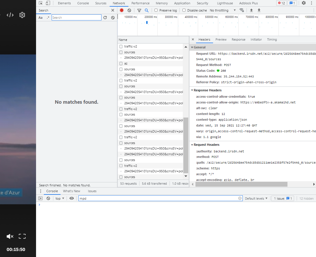

  10. Hi,
    I have the same problem to download
    https://embedftv-a.akamaihd.net/7420b197f99fcd6f4874adec3627e3a9
    I checked Network/Sources/Console but i can't find the mother Link
    [Attachment 60742 - Click to enlarge]
    Can you help me please ??
