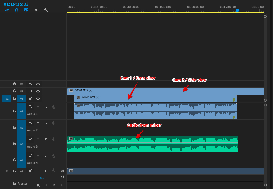

  3. The two video files are from different angles. So a project with multi cam. Audio was recorded by the mixer and must then be synchronized with the two videos (multi cam).

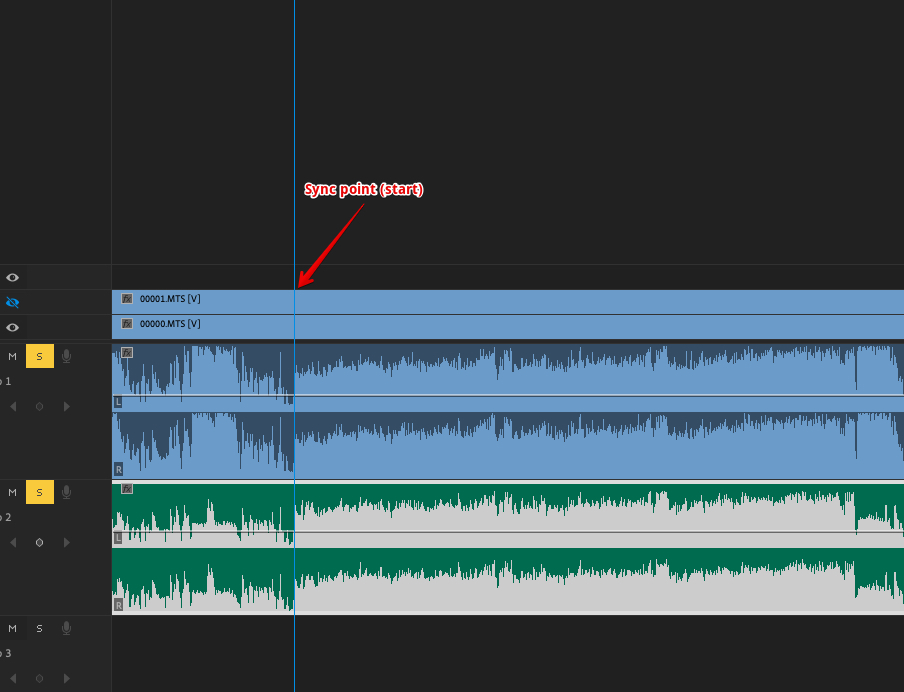

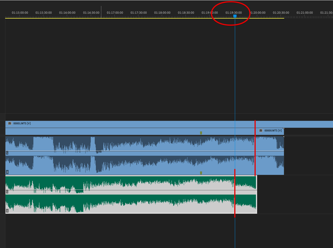

  5. Thank you for your message
    that's exactly how I did it. The beginning works perfectly. But after more than an hour, the two tracks are no longer in sync

  6. Your images indicate you're using Premiere. Use the rate-stretch tool to lengthen the audio until the waveform matches the video.
    Only rate-stretch your external recorder track. Leave the others alone.
    It helps to add an edit (razor tool) at your known sync point near the head so you are only adjusting the tail. You can go back and remove the add edit once you are in sync.
