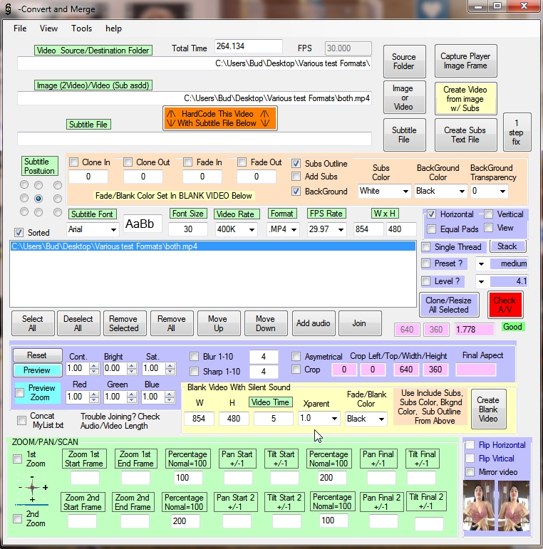

    Is this something like what you would like? It is still glitchy but I use it all the time fine because I know of the glitches. It is still time consuming but much less so than all manual because it takes much of the guess work out of cutting and splicing.
    1. Drag and drop a video anywhere on this form and it will obtain all the necessary information about the video.

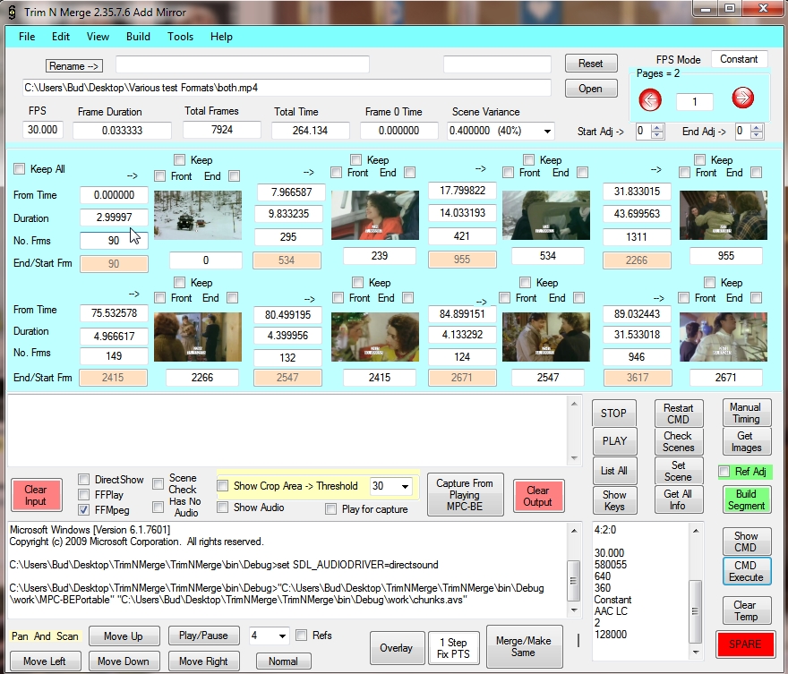

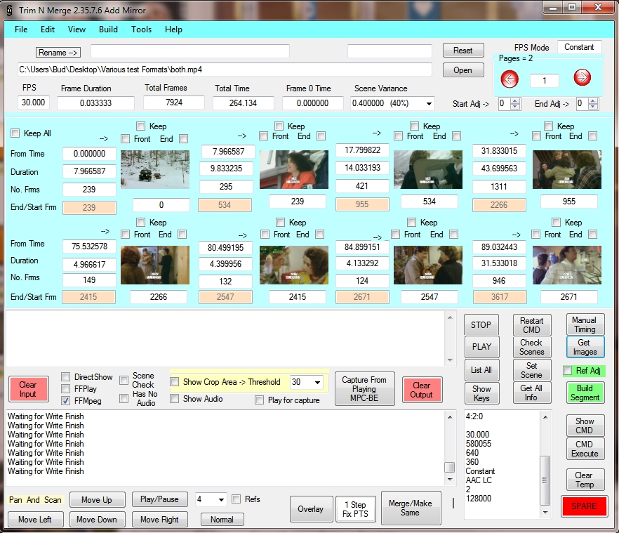

    2, Adjust the Scene Variance dropdown and then Click set Scenes Scene changes timing information will be loaded on the first page (multiple pages may result and shown by clicking The page arrows at the top.)
    [Attachment 54846 - Click to enlarge]

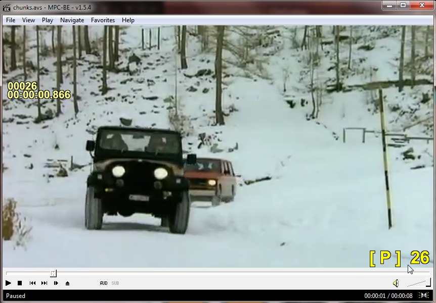

    3. Click show images to show images for each scene change 1st frame. These can be enlarged by LEFT clicking image.
    4. RIGHT clicking an image will play that segment for the duration shown to the left of the image.
    [Attachment 54847 - Click to enlarge]
    5. set each segment to the length (in frames) of the viewed area you wish to cut.
    [Attachment 54848 - Click to enlarge]
    6. Preview again for the cut length by again Right clicking.
    7. Click 'Keep' for each contiguous segment you want joined. I my case of setting the first segment to 3 seconds, I click Keep and End to terminate that segment after 3 seconds.

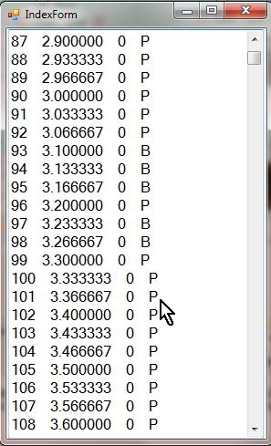

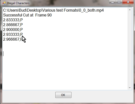

    It will also create a list of the final frames to make sure FFMpeg has not altered the last segment more than the normal frame interval (which it will do if you specify the wrong end point to stop on). This can be corrected by Clicking end adjust and adding frames or removing them.
    THIS is NECESSARY because although each segment will play correctly, if joined you may have a pause or frozen frame between segments.
    [Attachment 54850 - Click to enlarge]

    As i stated, this is still buggy but I know how to circumvent them until I correct the code. but it does some of what you are asking as well as editing functions others have asked such as:
    1. Cloning first or last frame for adjusted times.
    2. Creating and adding simple subtitles.
    3. Create fade in/out
    4. Adjust Subtitle background color, size and font
    5. Crop and adjust aspect if necessary. (Partially automation when changing one dimension
    6. Much much more even stack and I just added Mirror
    If this is something anyone would want in one package I will continue to debug and recode.
