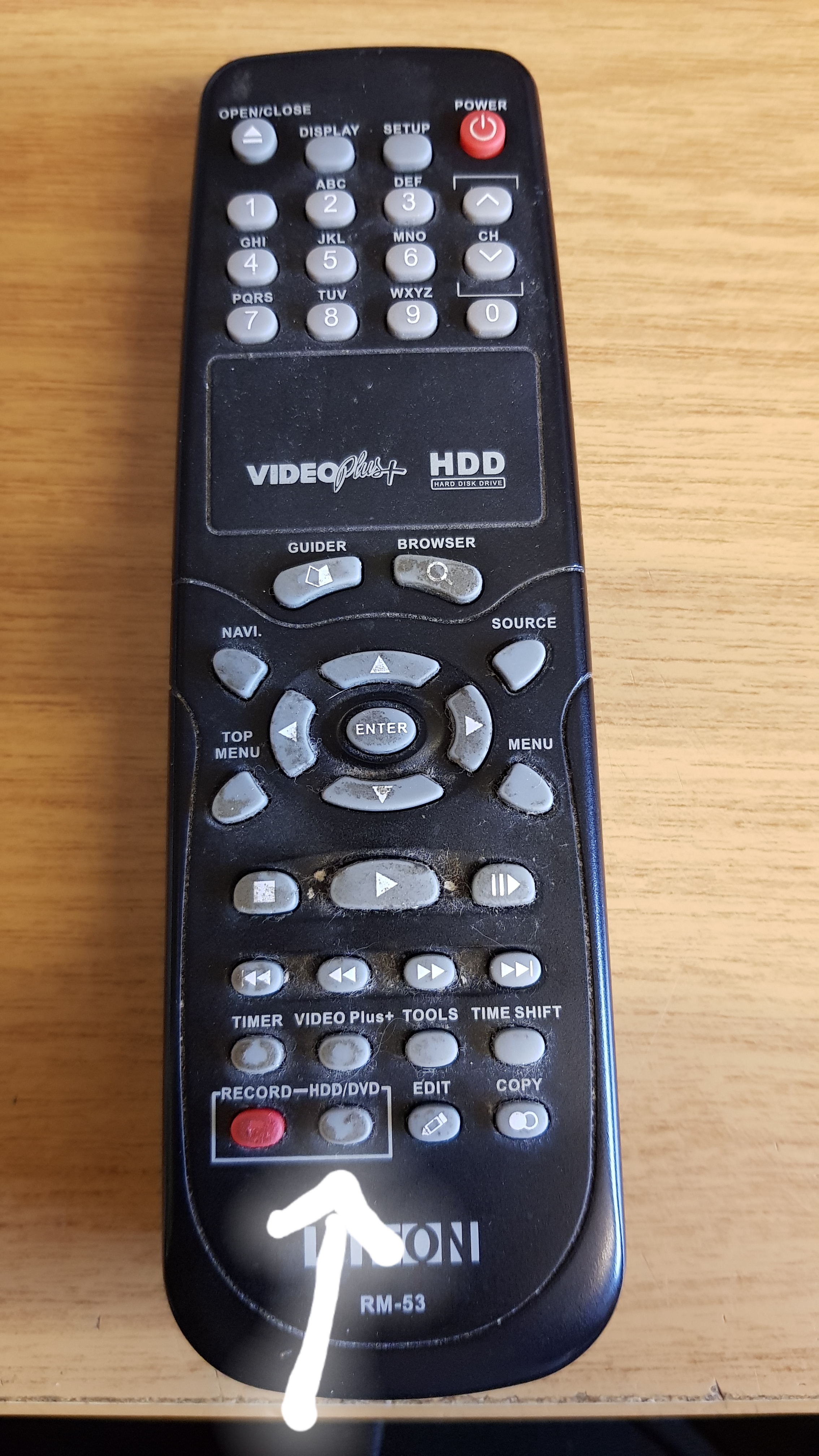

When you say press TARGET, where is that? I usually press the Guider button on the remote and play, then it says hard drive or DVD. Is that what you mean or is the target a button on the front?

TARGET should be a button on the remote at the bottom. It will move the indicator on the front display (DISC or HDD).

Silly mistake, but now I'll be more careful. I checked the remote and I probably have an old one because it doesn't have a button that says TARGET, but I'm assuming it's the button I have highlighted
[Attachment 54801 - Click to enlarge] -

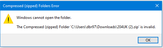

Now another issue. I downloaded the 204UK file again, but when I click on open it fails with a message saying windows can't open it.
I have PKZIP on another computer, so I'll try that. Either that or the ZIP file is no good

Actually none of the files 201,203 or 204UK would open, but the 197UK file did open so I'll use thatLast edited by dbr97; 7th Sep 2020 at 12:28.

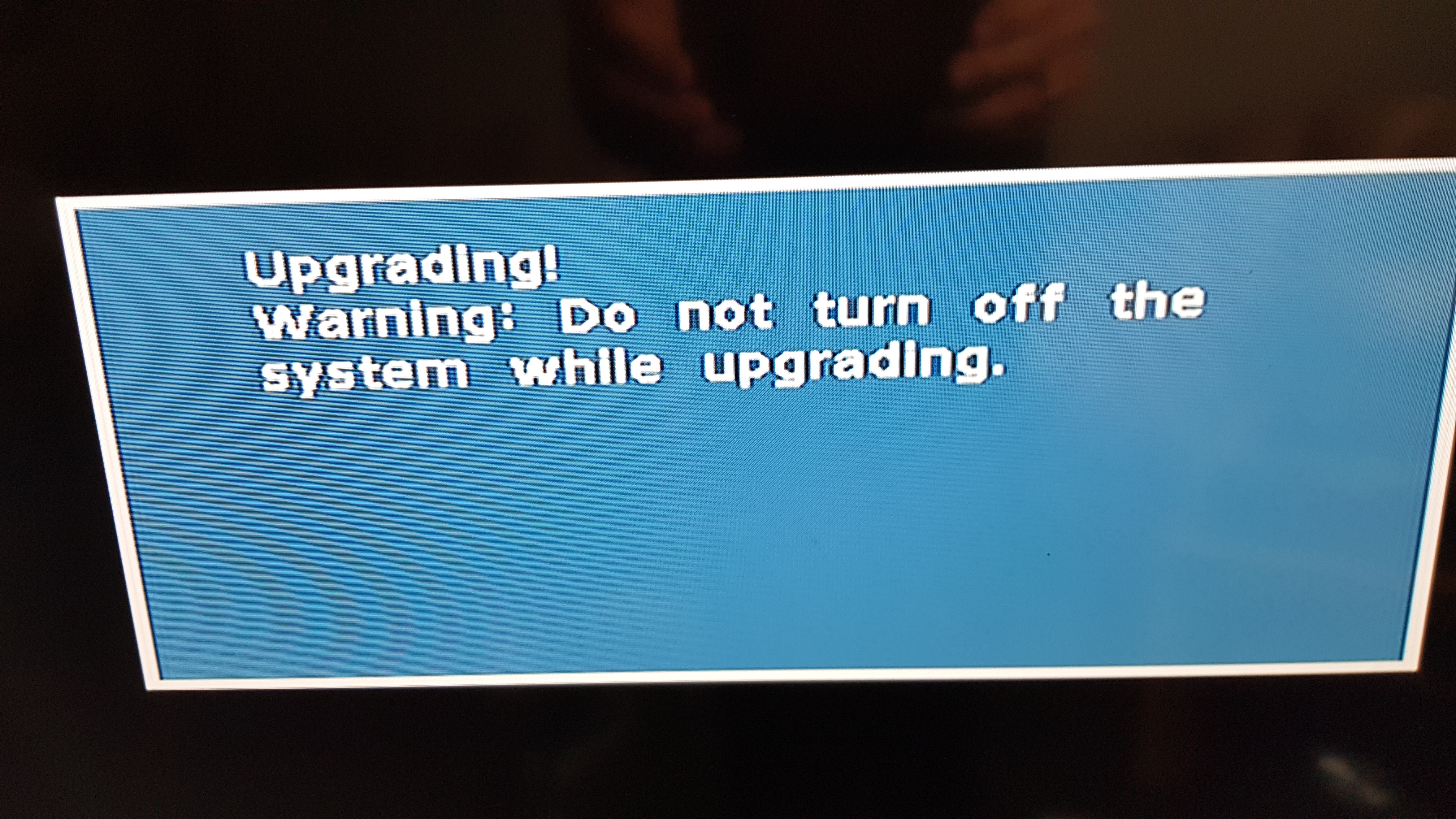

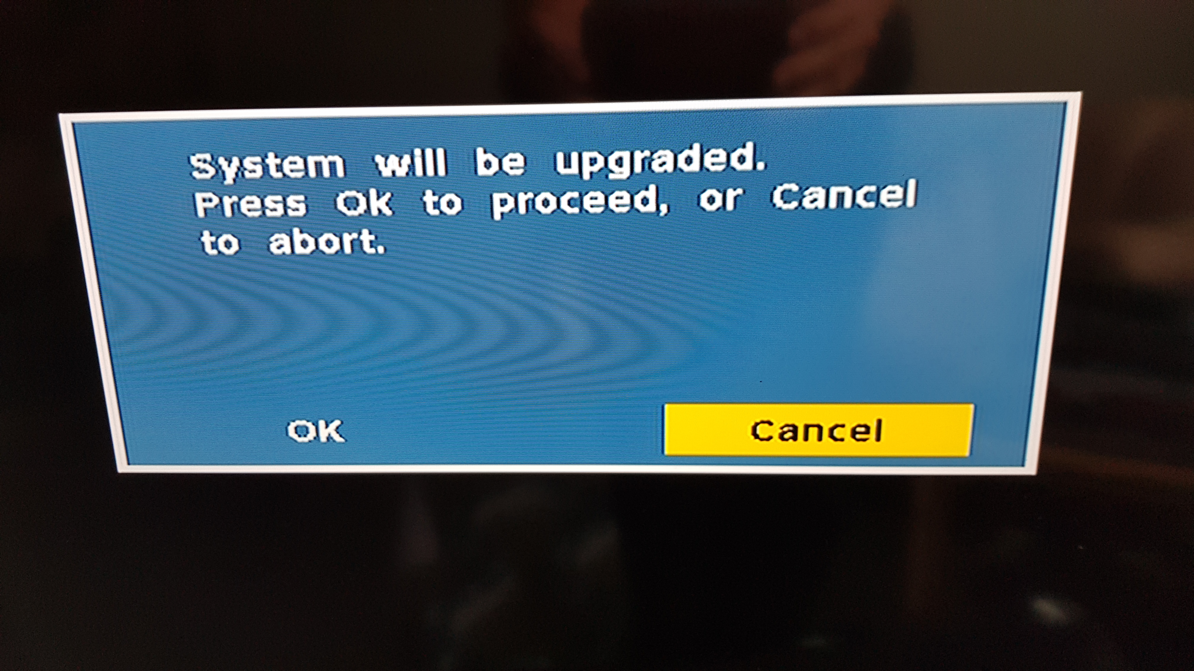

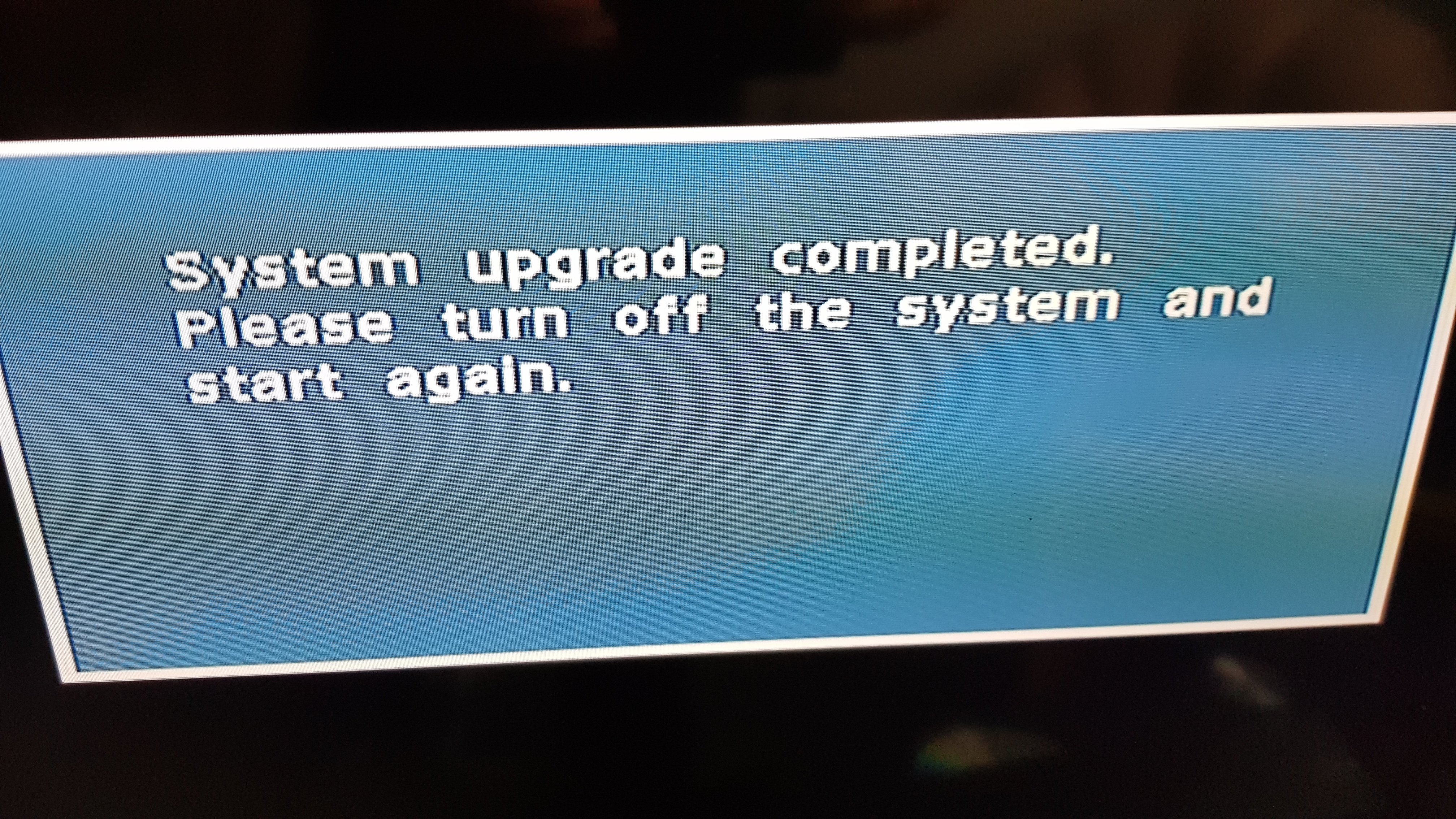

OK I have some progress to report. I have created pics to show what has happened.
[Attachment 54807 - Click to enlarge]
[Attachment 54808 - Click to enlarge]
[Attachment 54809 - Click to enlarge]

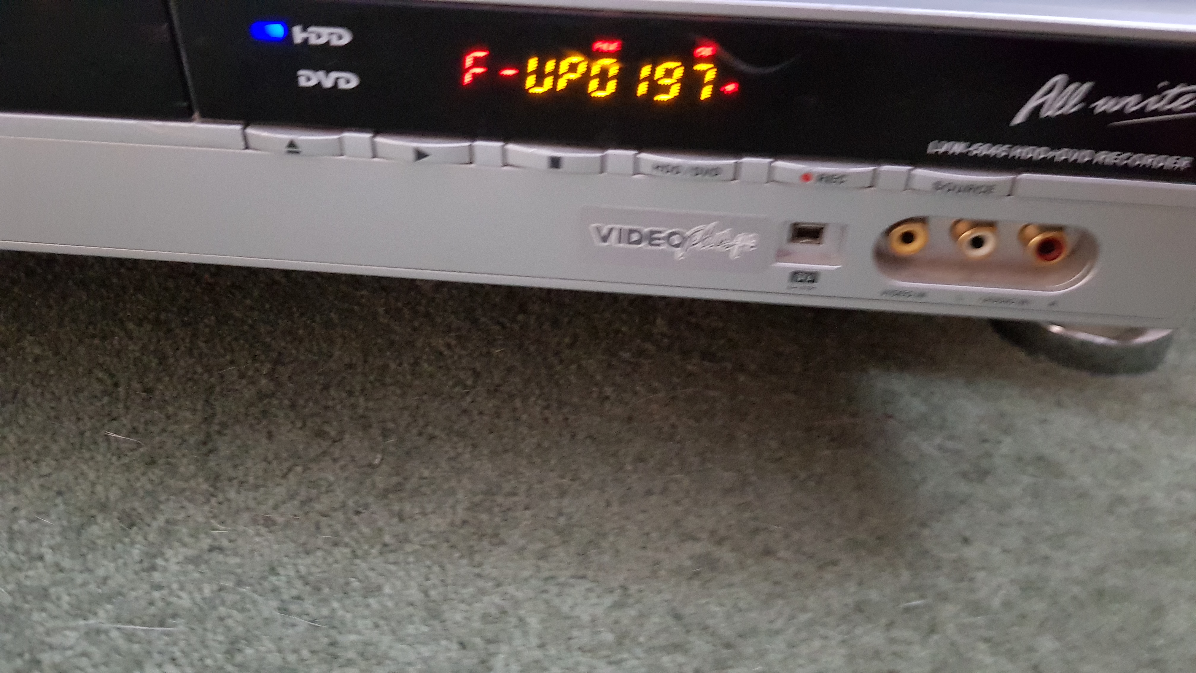

This is still shown on the Liteon unit and been like that for several minutes. Does the F mean fail?

Yes, that would be the right button, I was going from my ILO remote, just a different name. I'm using RAR as my unzipper and was able to open the 204UK zip file yesterday. The hacked 197 would also work for you.

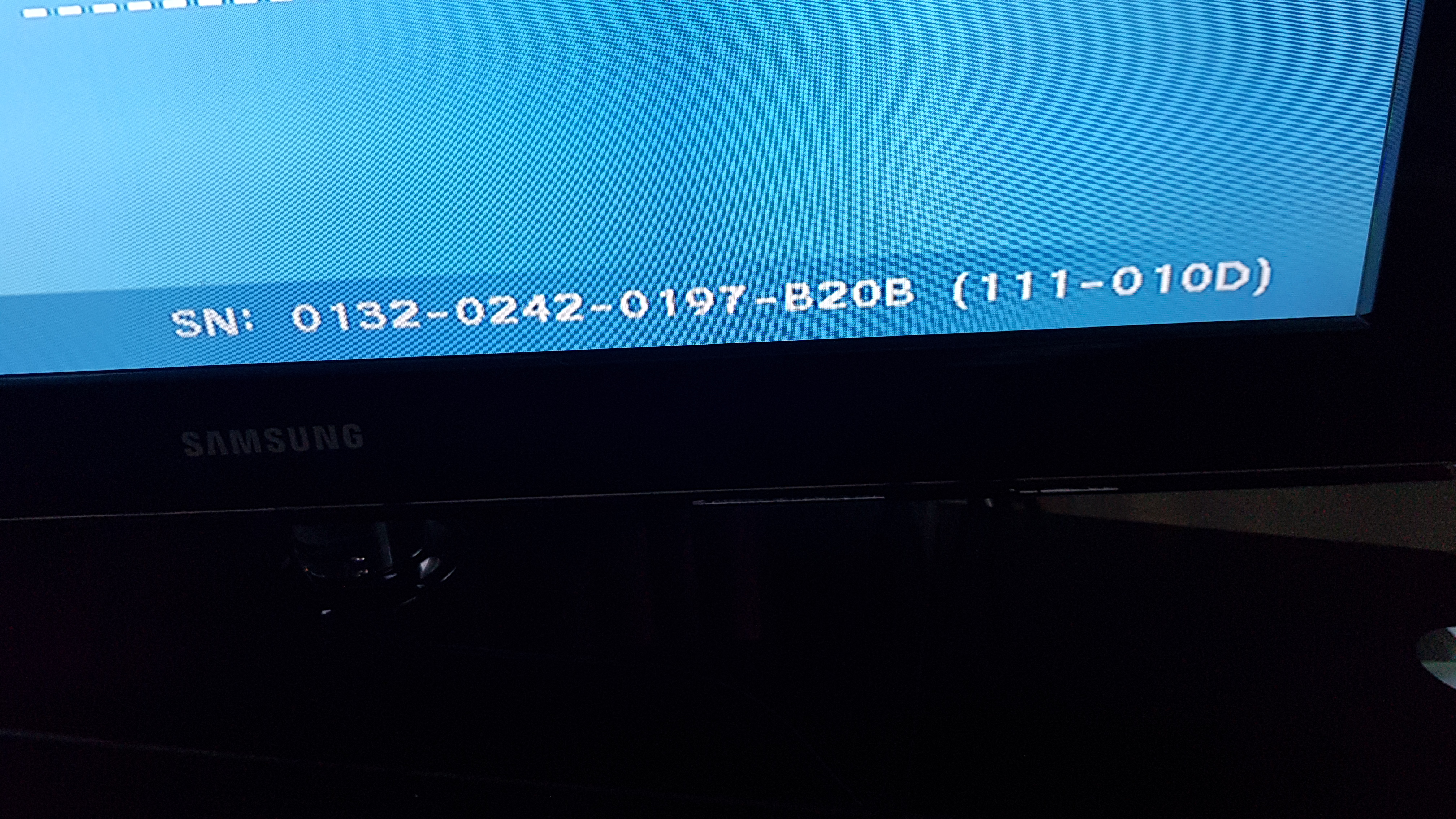

Not sure about the "F" . I think it stands for "firmware". Turn off the 5045 and turn it back on, check the SN, if correctly applied, it will show 0197 as the firmware and the 3 digits should read 110, if so, it's hacked but still need to change the region to 0.
It looks good. It does show 0197 and (111-010D)
[Attachment 54811 - Click to enlarge] -
YES!!! the middle 0 changed to 1 which means the unit is hacked. Now just do the remote region change (SETUP-scroll to EXIT and sit there and press 2960 to open region menu, set a region free and the digits should read 011). Now you have a hacked Liteon which will accept anything you feed it through the line inputs (DVD players, VCRs, laser disc). The 5045 is now also a hacked player if you wish to send the line output to another recorder's line input.
FYI. the SN, the first 2 sets of 4 digits refer to the motherboard and the CPU chip on board, the third one we know is the firmware, the fourth is the disc drive firmware which hasn't changed which means that there were no update made to the disc drive with the 0197 update.
