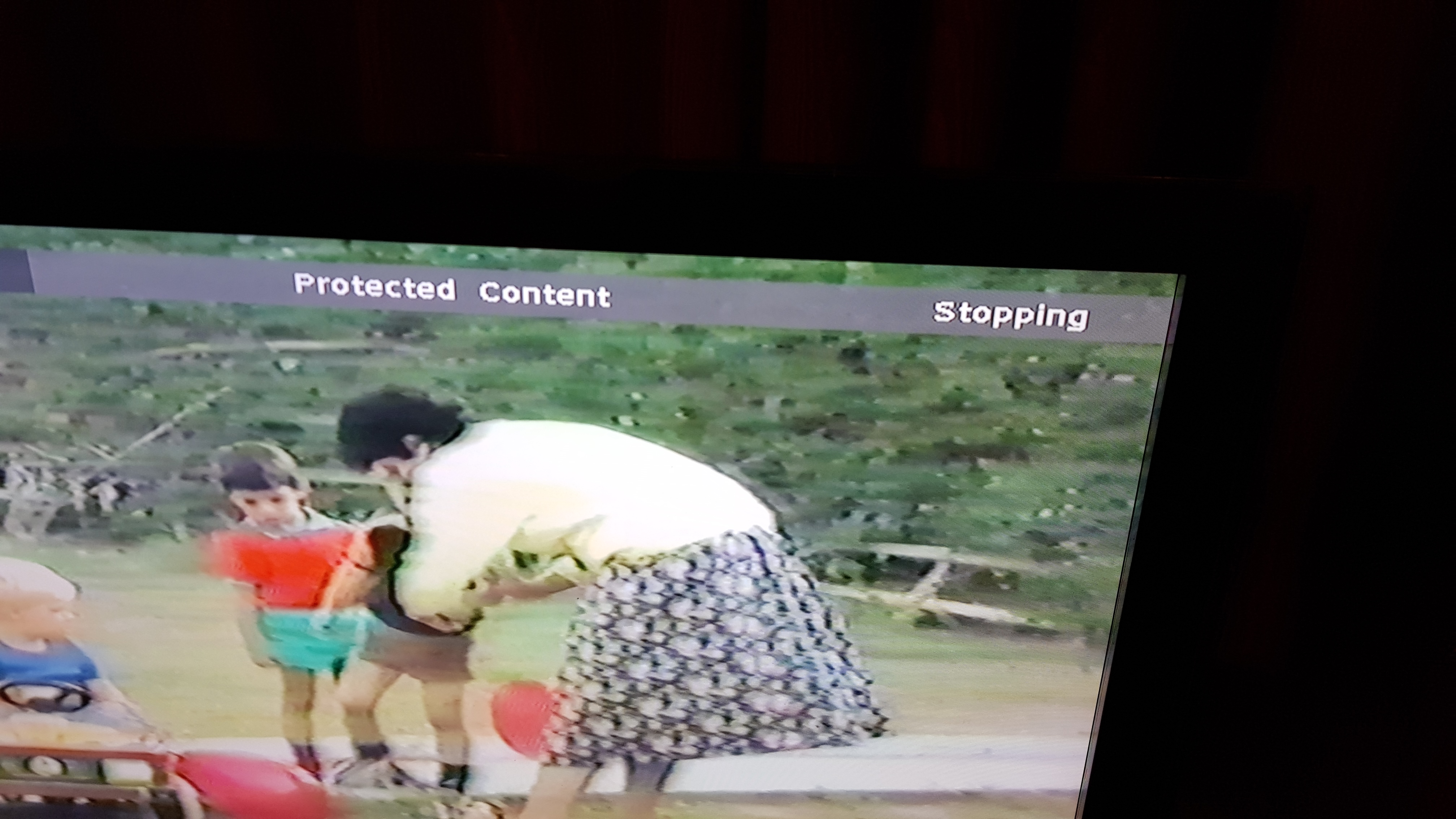

    Now I have more information. I watched when I restarted the recording, within a couple of minutes it displayed a message saying "PROTECTED CONTENT. STOPPING". All I'm trying to do is transfer a recording from a VHS tape which was recorded with a camcorder. I'm not trying to record anything copy protected.
    [Attachment 54776 - Click to enlarge]

    Quite possible that the vhs signal/recording is weak and producing a fake macrovision signal to the recorder.
    To ensure that it is not the recorder itself you should try another tape. If you have some commercial ones, UK releases rarely had mv.

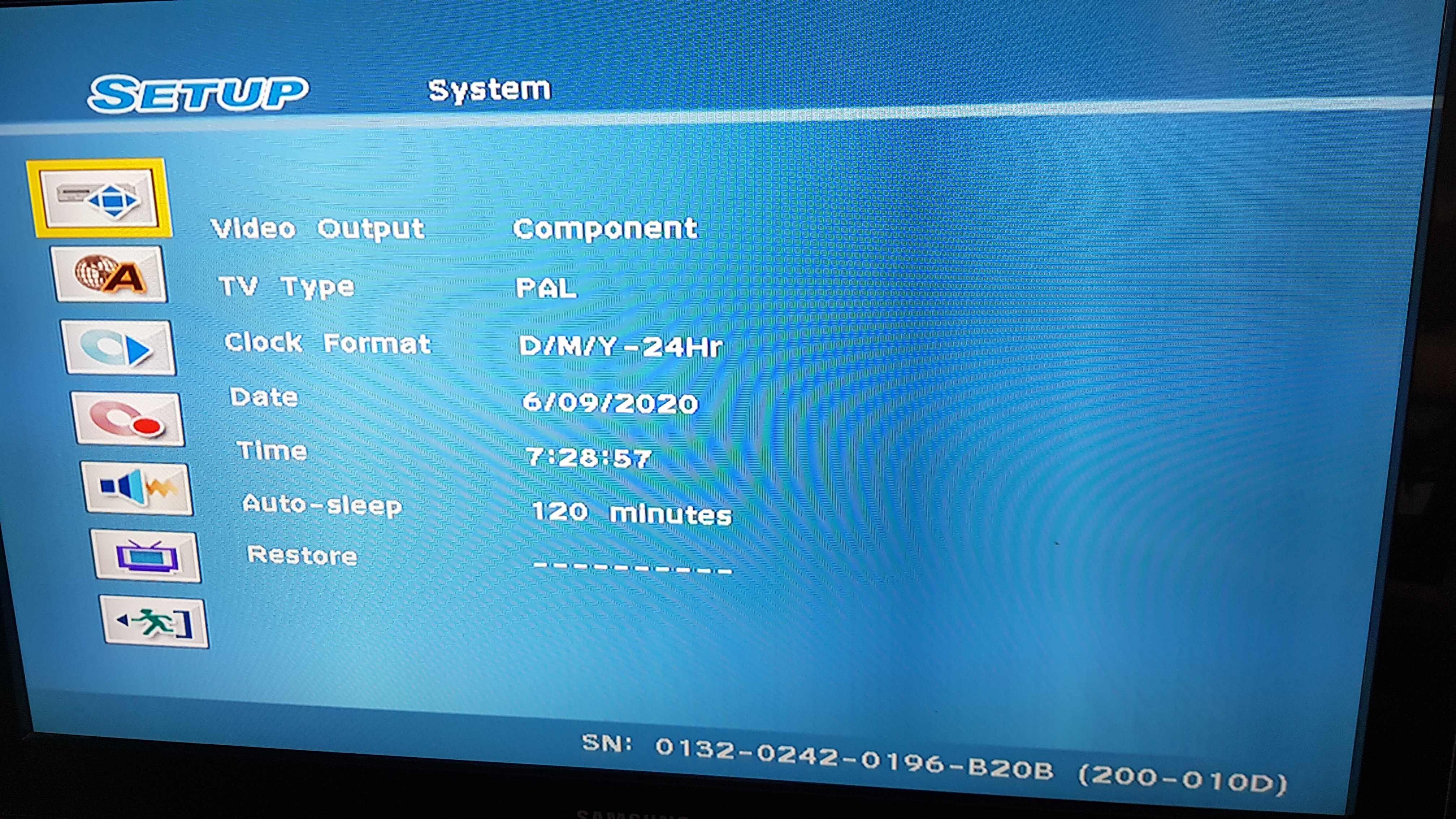

    Pressing setup, the details on the screen are... The third set of four digits says 0196, so is that the firmware number?

  18. Yes, the 0196 is the firmware version for your UK model. If you look at the first 3-digit sequence in the parenthesis (200) the "2" represents the region, UK being region 2. If you want to change it to region free (0) you can do it via your remote. For your info, the fourth series of digits "B20B" is the firmware version on the disc drive.
    1- press SETUP
    2- scroll down to the EXIT icon at the bottom and stay there (highlighted)
    3- on your remote, press 2960 and it will open up the hidden region menu
    4- choose "REGION FREE"
    5- to get out of the menu cursor left until you're out.
    6 press SETUP again and you will notice the digits will show "000". The second "0" in that group is the copyright indicator with "0" being copyright on, if you were to apply the hack. that digit would change to "1" meaning copyright disabled.
    User of the US models, I've got 2 5045s and 4 of its downsized clone (ILO HD04 80GB) which were produced by Liteon for Walmart in the US. All of them have now the hacked firmware version. The hack version I have on the Liteon 5045,
    1- disables the copyright flagging,
    2- drops the region code by 1 (in the US that drops it to "0" region free, in the UK, you might need to use the remote to drop the region to "0" as the hack would drop it from 2 to 1.
    3- allows a bigger HDD, up to 500 GB.
    The hack version I have on the ILO HD04,
    2- drops the region code by 1 setting it at "0".
    4- adds the LP (3 hours) setting for recordings as it is not available on the official ILO.

  22. Member
    Sep 2020
    London
    1- press SETUP
    OK I followed your instructions and now instead of 200 I changed it to REGION FREE and the code says 000
    You mentioned that the second digit of the 000 is the copyright disabled. How do I change that from 000 to 010?
  23. Some dvd recorder brands / models overdrive their copyguard detection circuits, often locking out legit camcorder personal videos: unfortunately your Lite On appears to be one of those units. Ordinarily the only workaround is to purchase a (now insanely expensive) outboard Time Base Corrector (TBC) box and connect it between VCR and recorder. Or, if you could still find one, one of the millions of "little black boxes" people used to use between VCRs to copy rental tapes. Either box type will patch over the signal glitches in the tape that are triggering the false copyguard detection in the recorder.
    In this case however, you caught a huge break in having Crazy Canuck see your post and reply with the firmware solution. If you can get that installed properly, it will cure the problem at the source (which always results in a better copy than patching thru additional hardware: I for one have never been the least bit thrilled with the fuzz-and-murk-inducing TBCs that are considered so "essential" by many enthusiasts here).
    If you are happy with the results you are getting from your workflow, theres no need to change it. The key advantage that made Lite Ons esp popular in Europe was this unique HDD file compatibility with PCs. While it is true capturing direct to a PC can (sometimes, not always) lead to notably better quality and more versatile files, it isn't nearly as easy, cheap and idiot proof as your "Lite On HDD in a USB sled" routine. Just tracking down a good PC video input encoding accessory can give you lifelong migraines, and finding a properly-functional TBC required to go with it is even harder. Thats before factoring in the thorny "theres no point in even bothering with this route unless you get a super duper deeluxxee long-discontinued premium VCR" rabbit hole, learning tricky software like VirtualDub, etc, etc, etc until your brain and wallet burst into flames from the stress.
    Your "recorder HDD to PC workflow" normally starts and ends in its native MPEG format, however. It is a little surprising that you're getting adequate MP4 files from that setup: most of us find recorder MPEGs made from VHS sources do not convert well at all to other compressed formats like MP4. Those interested primarily in MP4 or MKV final files do tend to grit their teeth and plow thru the tedious PC lossless capture workflow instead. Either your copy of Premiere has a magical ability to create decent MP4s from VHS MPEGs, or it just works better from a PAL tape source. American NTSC VHS>MPEG>MP4 conversion usually looks pretty dire.
  24. Member
    Sep 2020
    London
    The MP4 quality is acceptable, but that is probably due to Photoshop Premiere producing the MP4 fies. That is very good software. I import the VOB files, then edit and sometimes create DVDs from them and the final step is to export the file to MP4. It's also worth pointing out that these are recording made with a VHS camcorder in the 1980s and 1990s, so the quality matches that which is acceptable.
    The requirement to overcome the copy protection is to hopefully enable me to make a 3 hour recording of the VHS tape and then I'll be able to edit the bits where the picture rolls etc. I have no need to do anything other than home videos.
    Anyway it's nice to share thoughts with enthusiasts like yourself. the point is from my point of view I learn more by getting something wrong rather than it working first time, because one doesn't learn anything that way. Having said that, I'm just keen to get the job done now
  25. Unfortunately no hidden menu for the copyright flag. Only applying the hack will change that flag.
  26. Member
    Sep 2020
    London
    OK I understand, I found the notes on it so I'll have a go and see what it does...
