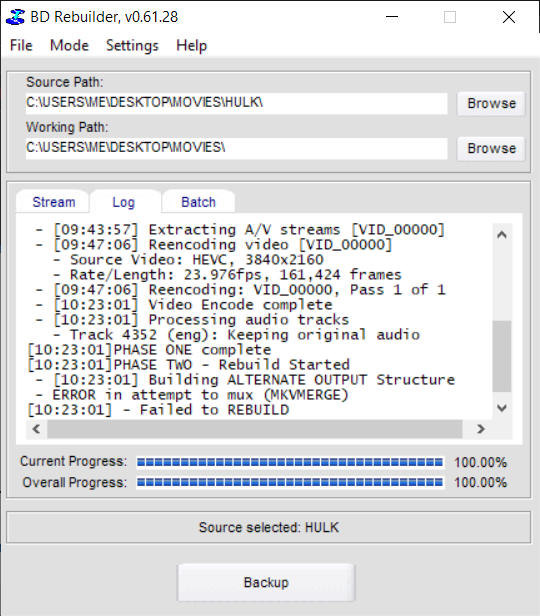

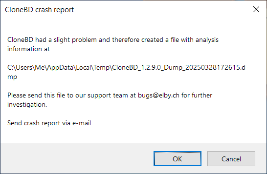

    I forgot to mention that I have been using TsMuxeR as well as the latest nightly from December last year, and while it "works" ostensibly, the resultant folder isn't digestible through programs like BD Rebuilder and CloneBD, whereas "official" 4K Blu-ray folders work without any issues.

    I see... I never tried to burn the resulting folders and I thought everything was OK. Thanks for saying.

    The missing ingredient to this puzzle is TSM2UHD. It's what you apply to the TsMuxeR Blu-ray folder to make it 4K UHD compatible. And the subsequent folder works for ingestion in BD Rebuilder and CloneBD!
    Mystery solved!

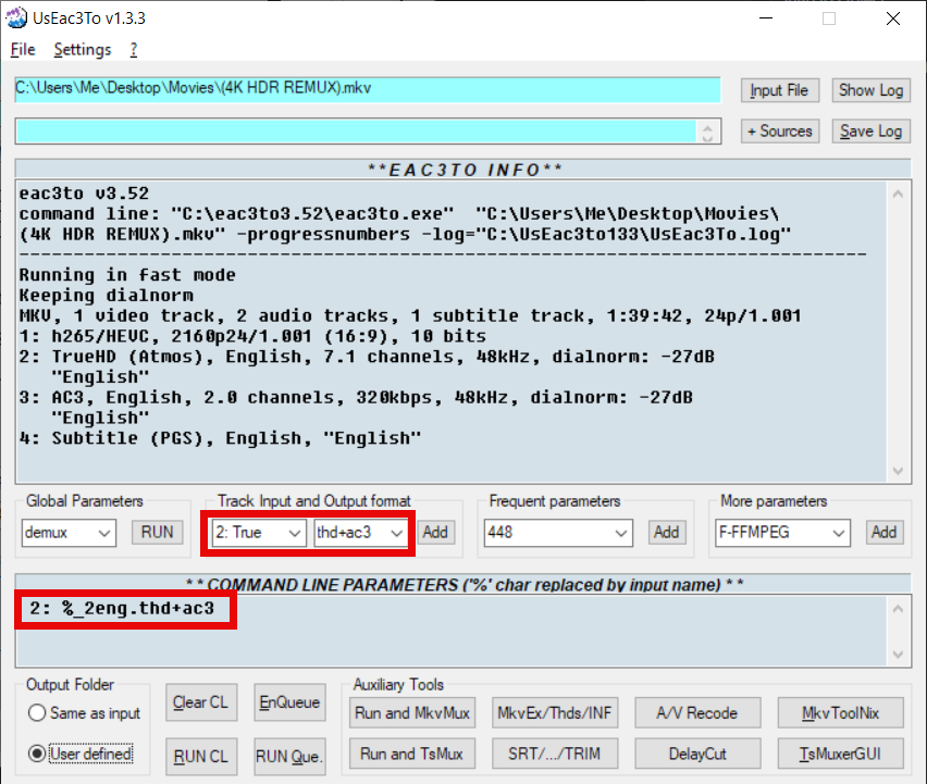

    I wanted to follow up and mention that with Dolby Atmos tracks, you still need to use UsEac3To (shown in the image below) to demux it with THD+AC3 for it to process properly in creating a Blu-ray folder within TsMuxeR. You just need to make sure you uncheck the normal Dolby Atmos that natively comes in the REMUX.
