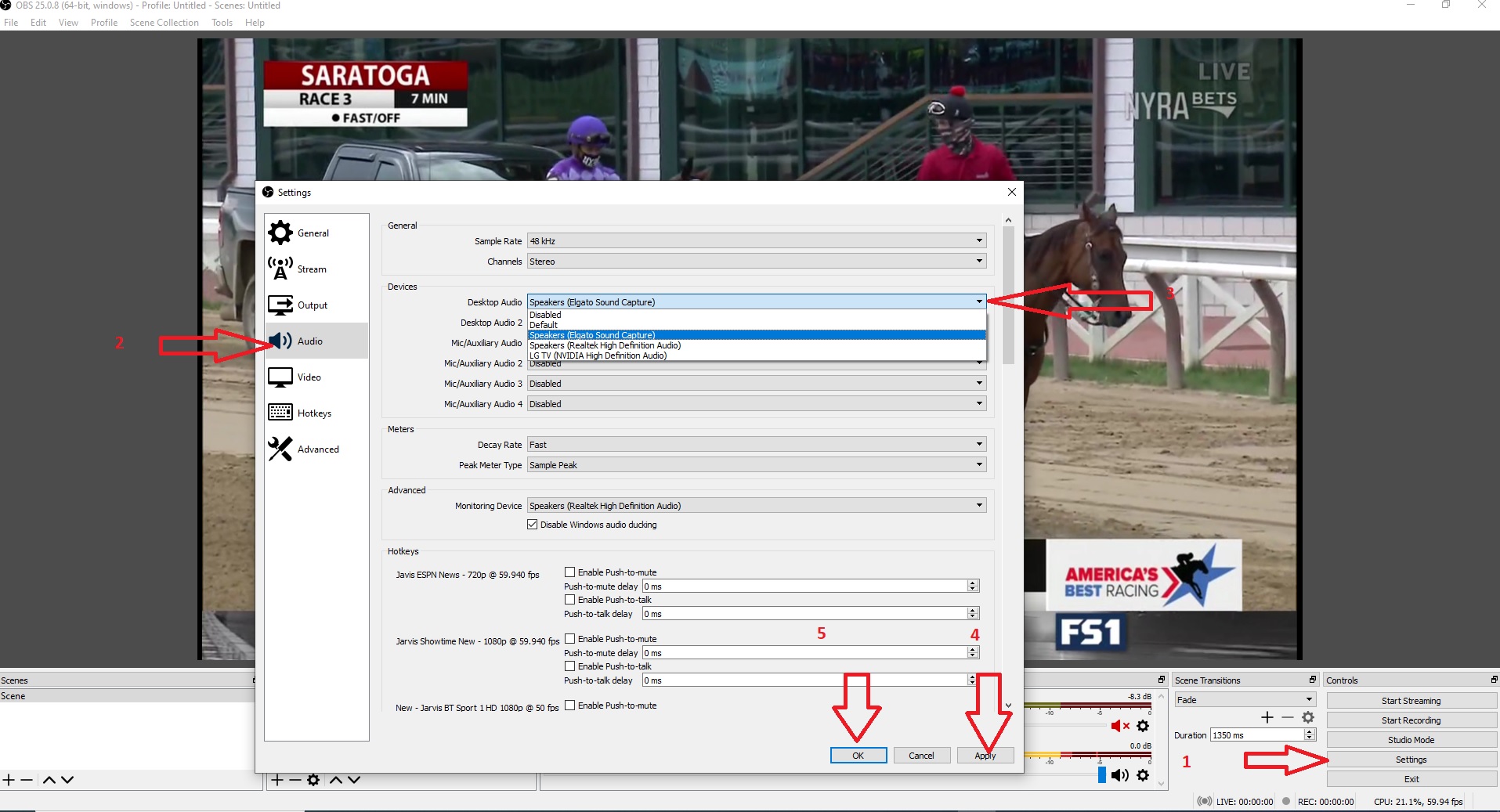

    The HD PVR 2 Gaming Edition Plus is basically the same as hardware as the HD PVR 2 with a green stripe and different accessories in the box. This YouTube video addresses HDMI video and audio set up for the HD PVR 2 within OBS. Both video and audio require setup with Crossbar. Have you tried what it suggests?

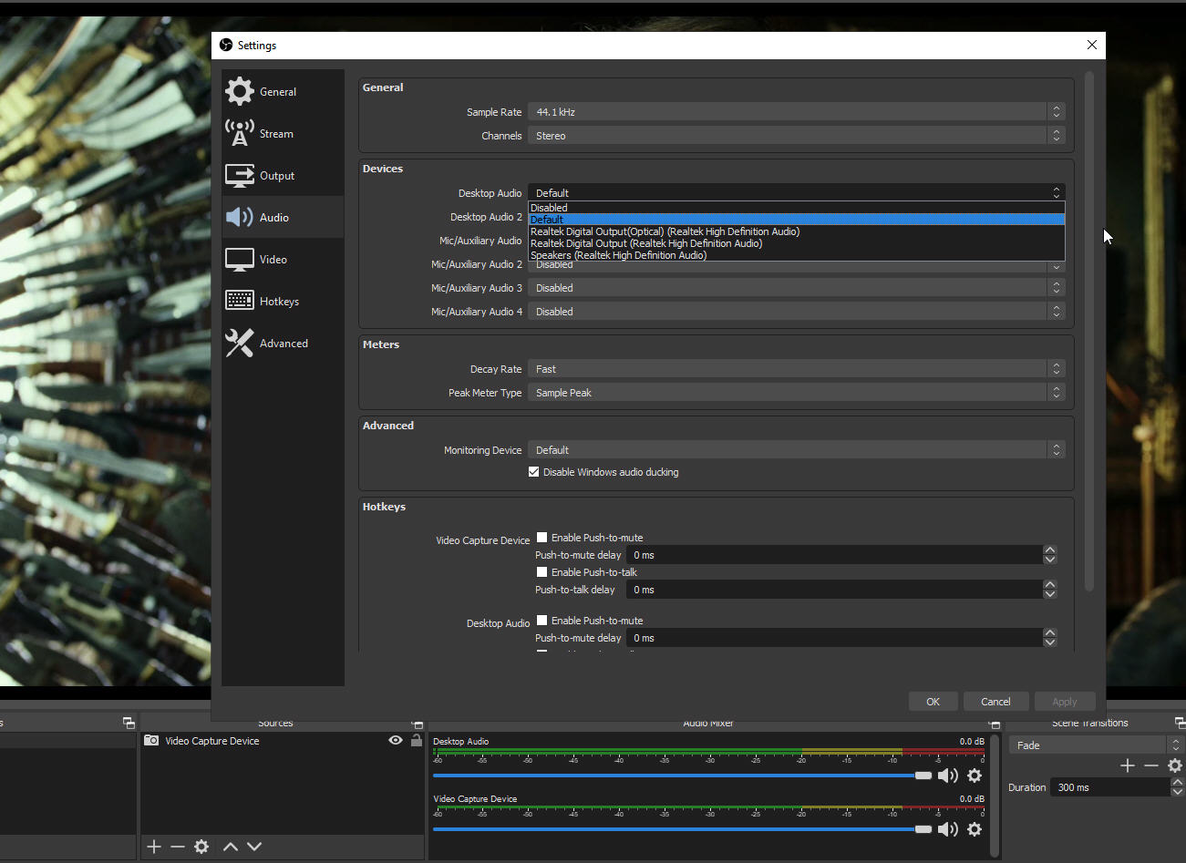

  5. OBS > Settings > Audio > Devices > Click dropdown > Select your PVR-2
    Is this what you mean ? (I use an Elgato card, hence the Elgato option in my dropdown)
    [Attachment 54742 - Click to enlarge]

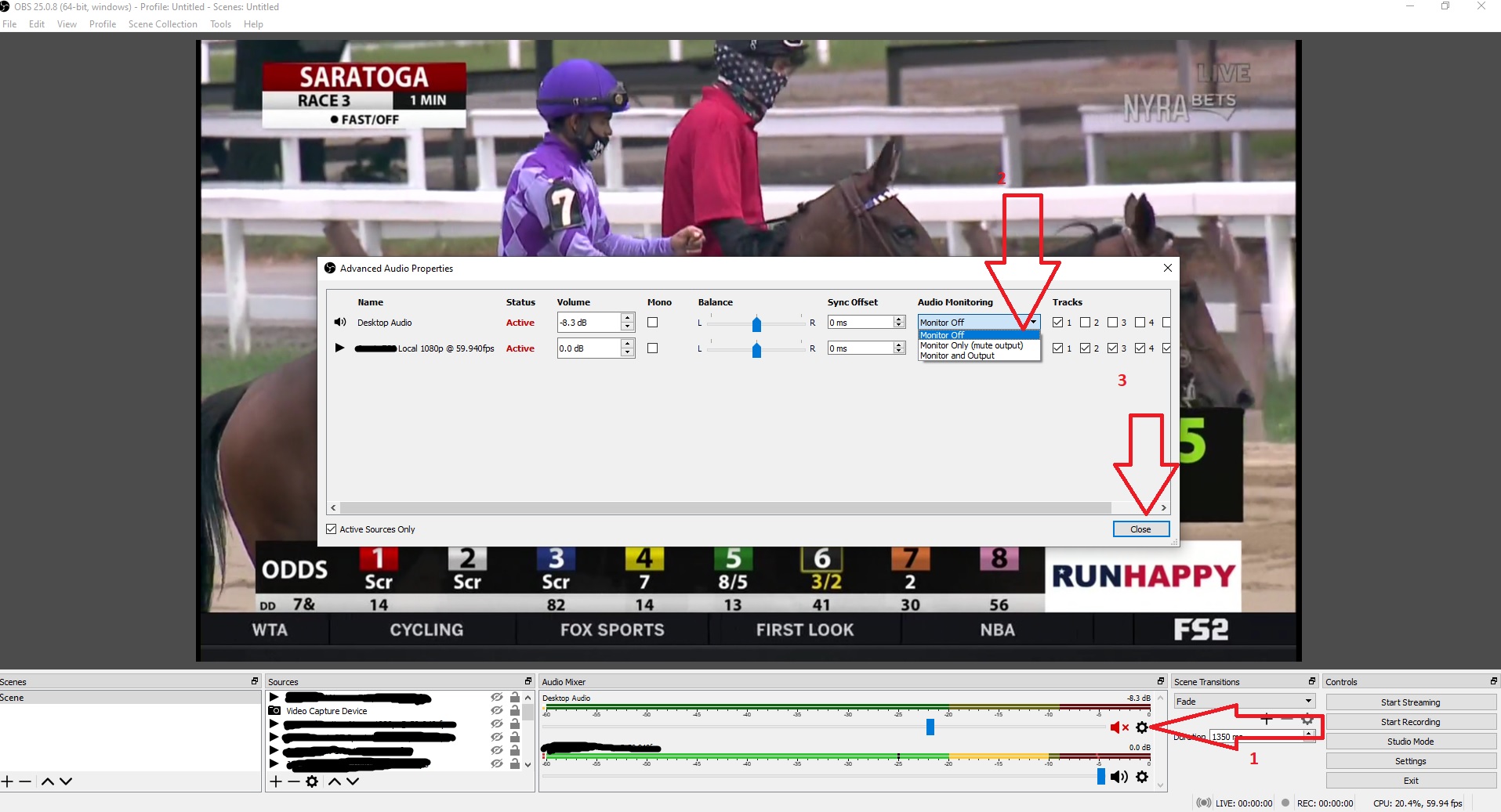

    Then go back to Audio Mixer > Click Gear icon > Advanced Audio properties > Select what you want (I select Audio and Monitor so i can record and listen on headphones too)
    Mute/Unmute icon next to Gear icon for sources you want/don't want
    [Attachment 54743 - Click to enlarge]

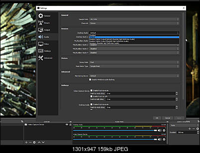

    I think you have shed some light on the no audio.
    When I look the Audio settings I don't see any choices that mention the Hauppauge PVR2.
    I'm not an expert but does this look like the PVR2 isn't linked to my Windows 10 sound settings somehow?
    Just to repeat, if I open the Hauppauge Capture app, there is sound/video. Leave it open, launch OBS and select Window Capture I get sound/video but I don't want that cluttered video window.

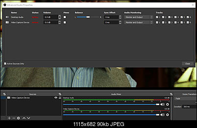

    Close Hauppauge Capture, launch OBS, select Device Capture, select the Hauppauge PVR2, I then I just see the video window (uncluttered), but no sound.

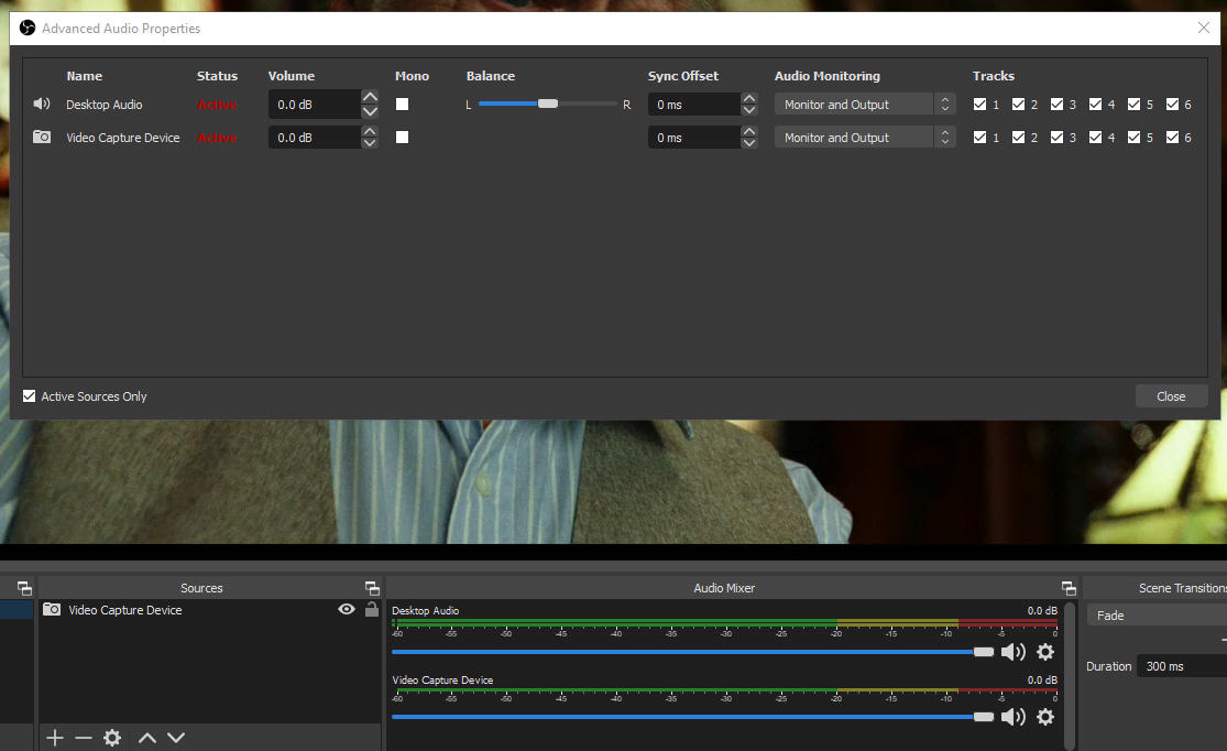

  8. In your bottom screengrab in the Audio Mixer you have both Audio sources active - null one out. (Mute) Try again. Then null the other out. You can't have them both active.
    PS what type of source are you trying to capture ? IPTV ?
    Aug 2007
    I just did it and still no audio

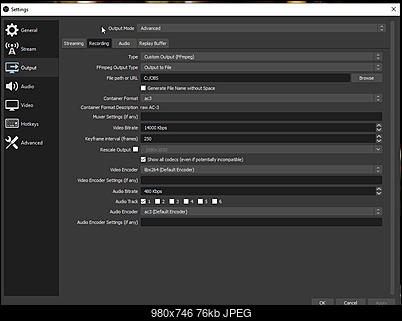

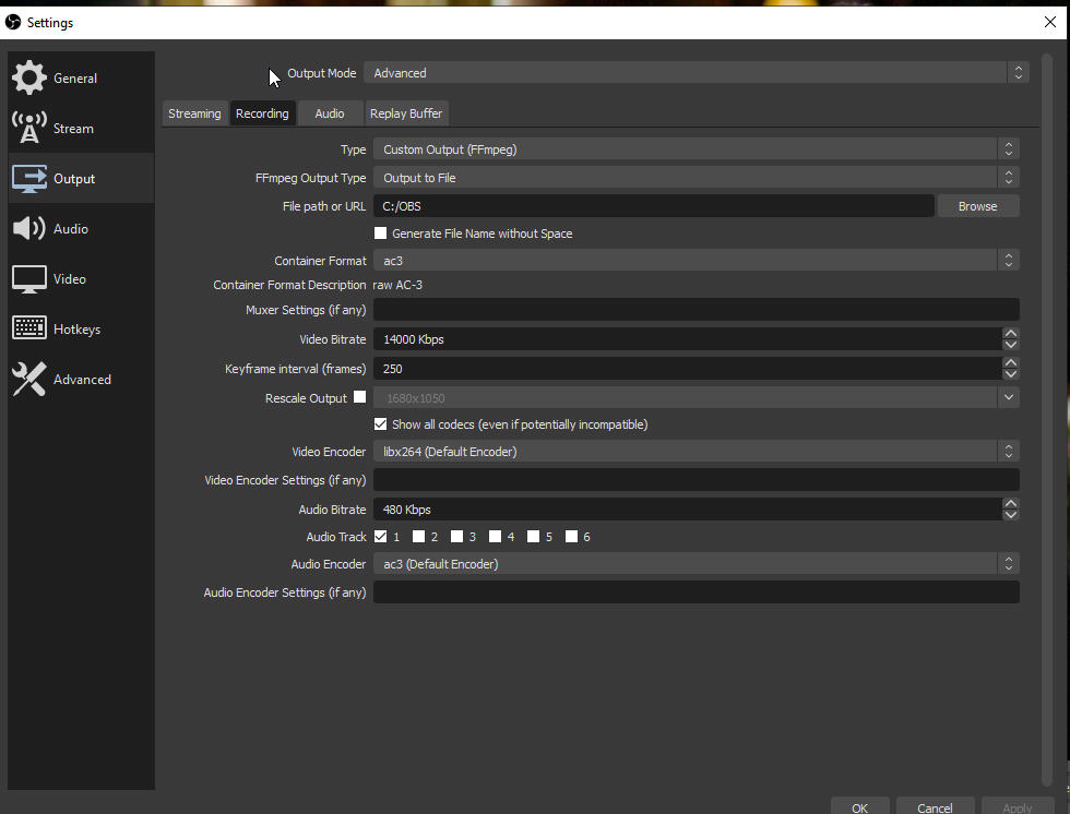

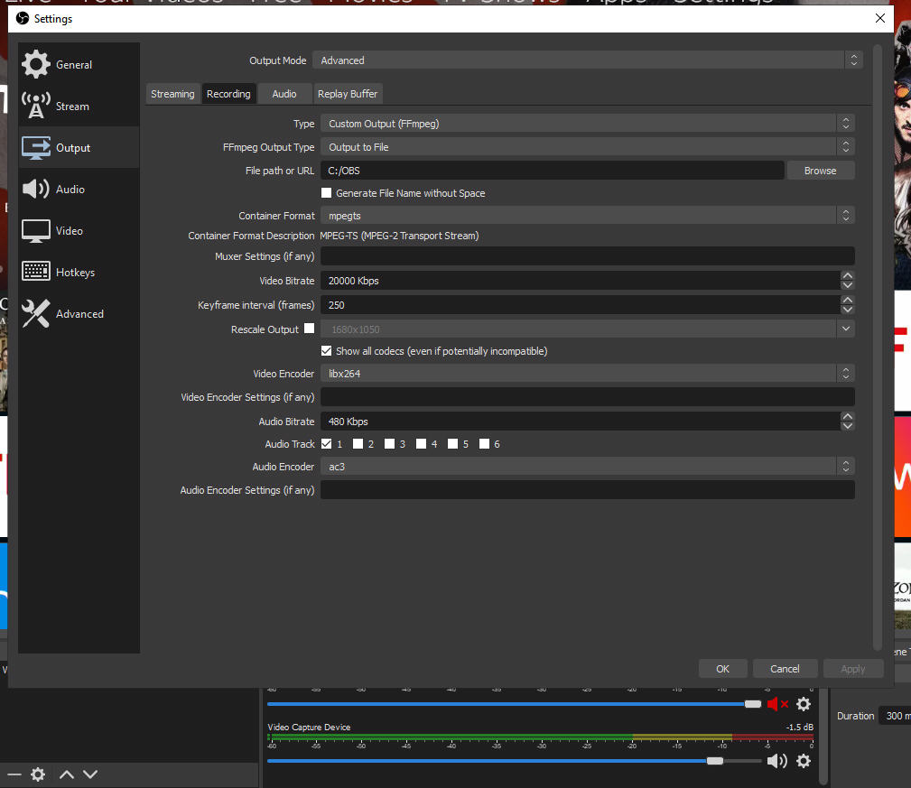

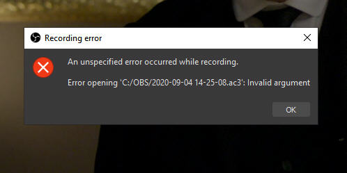

    So OK I set up my output as follows.....
    I get this error when I click on Start Recording....
    Is there a wrong setting? Do you know what could be wrong?

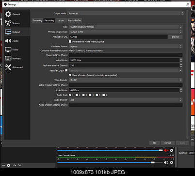

    I have success!!!!
    Here are my settings. Excellent no jerky video with the 20Mbps bitrate, sound is nice and clear. The files muxes into the Blu-Ray components, burns fine with Blu-Ray disk. Perfect video/audio sync.
    Disc plays in my set top Blu-Ray player. The only glitch, and it is minor is that I can not fast forward the BD disc in the set top player. I can skip chapters. I can try come other video/audio codecs later.
    Thanks again for all the help. I spent about 30 hours the last 2 days trying to figure this out. The OBS forums are kind of useless as no one responds.

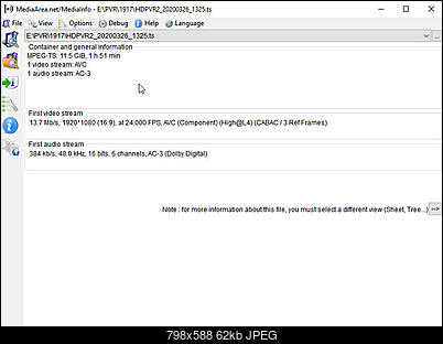

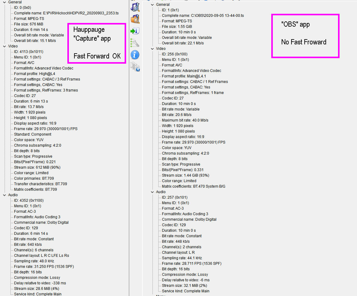

    OK to make this project a "complete" success. I can not Fast Forward the burned Blu-Ray disc with OBS captured video in a set top BD player(s). I can skip chapters ok. The Hauppauge Capture app captured video burned Blu-Ray disc can Fast Forward. I use tsMuxer on both captured videos to generate the needed BD components to burn the BD disc, and I use ImgBurn to burn the BD discs.
    Here is the MediaInfo data of the captured video from each app.
    Hopefully someone will know what be wrong to prevent FF in the OBS captured video?
    [Attachment 54775 - Click to enlarge]

    For the fast forward issue, I can only guess at how OBS Studio handles the PVR2 usb device drivers. I imagine that OBS can only "see" and play what comes out of the usb 2.0 port after the PVR2 hardware encoder is done with it. One thing for sure is that there is a 14000 Kbps hardware video bitrate limit possible using the capture programs supplied by Hauppauge. I don't know if OBS can get around that so using higher bitrates in the OBS post process capture seems counter intuitive. I have no idea if there is any adverse effect on the output file generated by OBS if the capture exceeds that boundary so I'm just spitballing. It might be worth a try to lower the bitrate accordingly and see if that has any effect on the ability to fast forward.
    EDIT: Just to add
    I'm not sure which version of tsMuxer you are using but the nightly builds have a number of fixes and some are Blu-ray related which I haven't researched but they'd be worth a look if you haven't already done so.

    OK, I now have complete success!!!
    FF/RW, chapter skip all work with the BLU-Ray disc on different standalone players.
    I should have listened to you earlier. I changed the Container to Matroska, kept my same .264 video codec, AC3 audio codec and got a MKV out compared to my prior TS file. I use the latest tsMuxer app. I still have the bitrate at 20 Mbps.
    I need to read more about Containers.
    Last question is there a video quality difference between TS(MPEG) and MKV capture?
    Thanks again for you help!
    I learned a lot
