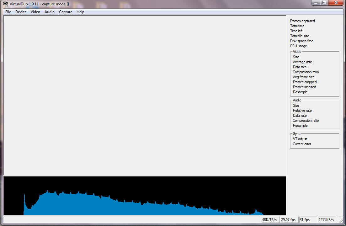

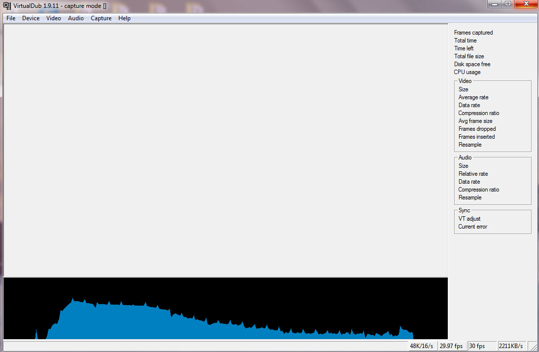

  8. Originally Posted by johnmeyer View Post
    It's interesting that you mention dropped frames. The only capture system I've ever used that never, even once, gave me a dropped frame, was DV.
    As I remember, VirtualDub is not the greatest client to use when capturing, specifically because it was tough to tune to eliminate dropped frames. Others can chime in with advice, should you find you have dropped frames.
    I would definitely recommend that you take the middle of one of your first captures, before you get too deep into the project, and put it on the timeline in your NLE. Then, walk through the video frame-by-frame, for a few hundred frames to look for duplicate frames. Dups are easy to spot (I have an AVISYnth script that finds them automatically). Even though you are looking for drops, almost all capture software, when it does drop a frame, will insert a duplicate a few frames later in order to keep the audio in sync. Since looking for the dups is easy, whereas spotting a drop can be tough, even when there is a lot of movement, and near-impossible in low motion scenes, I always look for dups.
    I didn’t drop any frames in about a 90 minute capture but it did insert 9.. I was watching it as it was capturing and it seemed to do that in the dead space when it was switching between events. If you care to share your script to find duplicate frames I can run it on my capture and see where exactly they are, if any. Thanks.

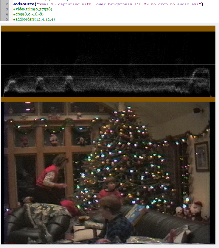

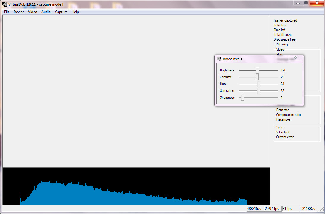

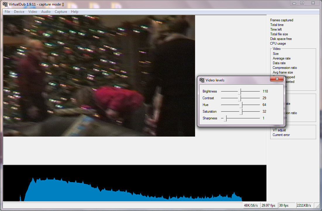

    I did my first capture without the ES10 and to my untrained eye I don’t see any blaring issues. No wavy lines or edges, no dropped frames and no audio sync issues. I can’t right now but maybe early next week I’ll post a short sample from that capture and you can tell me if you see any of the tell tale signs that a TBC is needed or would help.
    For now, the main issue I seem to be having is that the video just looks dull. It lacks depth and pop, even for an old home movie, and even when compared with the old DV capture which seems more vibrant in comparison with zero color correction or levels processing.
    I tried playing around with levels(), coloryuv() and tweak() but can’t seem to get it to look how I want. I don’t know that I would think it was that bad if I didn’t have the DV capture to compare it to, which in theory has a worse color space and would expect opposite results. So it must be something I am doing. (I will say that the finished processed deinterlaced file of the new capture when viewed on my tv shows a MASSIVE improvement in other areas when compared to the DV capture. Much cleaner, clearer, better quality. It’s just the colors and contrast I can’t seem to get right.)
    I never took my video out of the YUV color space - all edits were done in avisynth and the only conversion I did was to YV12 for QTGMC. Never brought into virtualdub or converted to RGB as far as I know. And then I used Jagabo’s sample ffmpeg x264 batch script which specifies color range tv and bt709 (I think, from memory). Do you think my issue is with the proc amp settings during capture that would make colors look washed out? Again, I will post a sample as soon as I can, as I’m sure you can’t answer that question without seeing it.

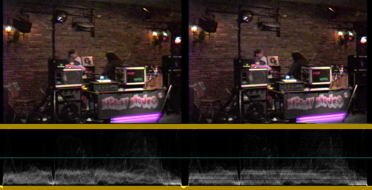

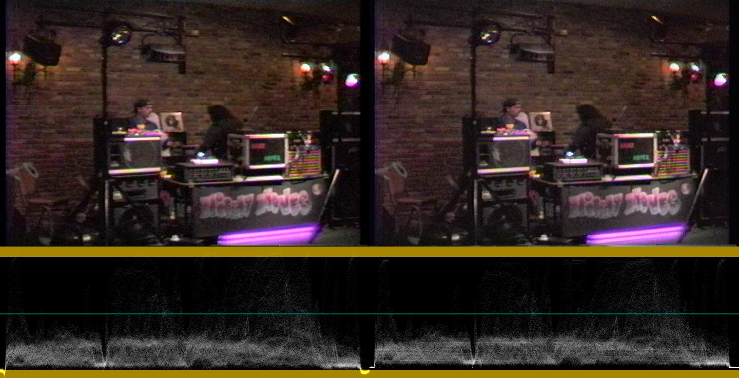

  11. Originally Posted by Christina View Post
    That shouldn't be the case. Here's a field (Bob()) of "DV sample capture.mov" and "check levels.avi" side by side with no adjustments (dv left, huffyuv right):
    [Attachment 54779 - Click to enlarge]
    The huffyuv cap has slightly higher black levels and slightly lower white levels. A small ColorYUV(cont_y=20, off_y=2) adjustment to the huffyuv cap makes the levels nearly identical:
    [Attachment 54778 - Click to enlarge]
    There ares some slight color differences but those could be adjusted too.

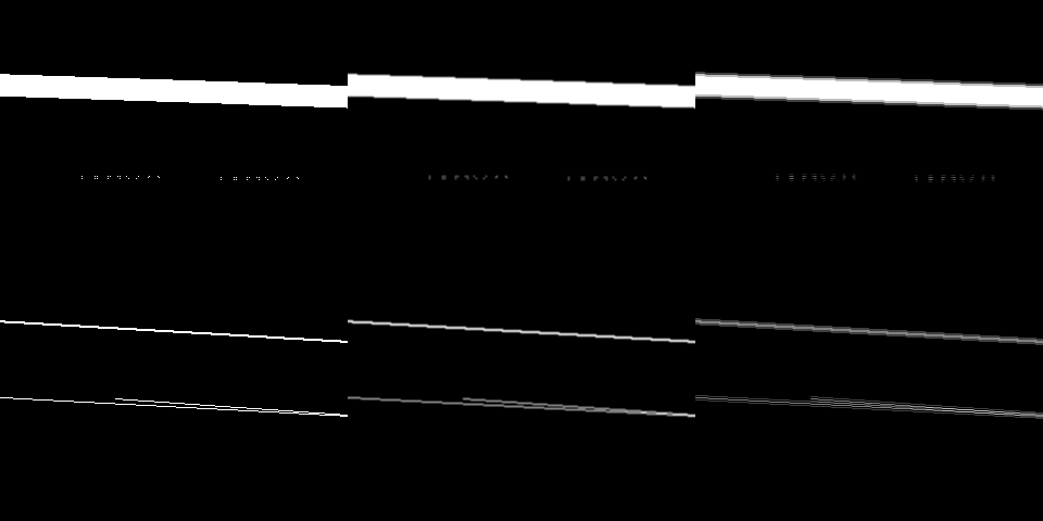

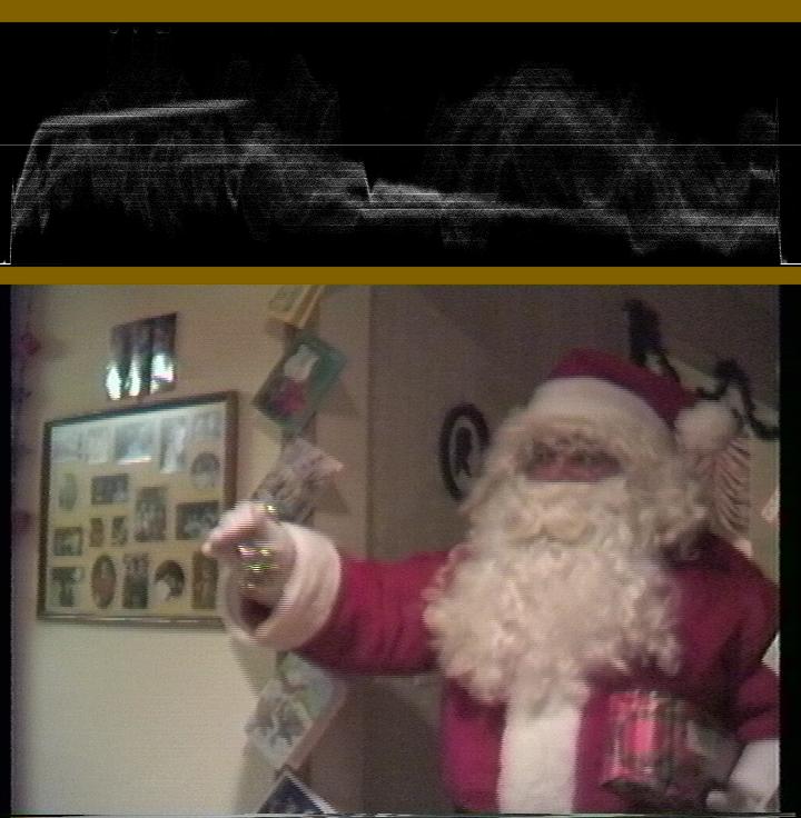

    I attached a part of my last capture that looked washed out to me ("8mm_27_1995_03_sample.avi"). With Histogram() I can see that the black level looks too high but when I was setting up the histogram in Virtual Dub, I raised it juuust enough so that there was no red on the left end (and yes I temporarily cropped off my black borders first, so not sure how they ended up being so high). Also this was the actual part of the tape playing when I set up my capture.
    Are you sure you cropped all the black borders? There's more than the usual amount on the right edge. There's also a little black at the bottom of the frame in the head switching noise. Also, I believe the capture mode histogram display is logarithmic. So small peaks appear much larger than they really are. And I'm not absolutely sure VirtualDub calculates the histogram after cropping. I don't have any analog capture devices set up to test anymore. As a quick test, try cropping large amounts (say, 32 from the left and right, 16 from the top and bottom) from all four sides and comparing the histogram with and without the cropping.
    But in general, this is why I don't like histograms for checking levels -- you don't know what parts of the picture are out of spec. Looking at a waveform monitor of your capture in AviSynth:
    [Attachment 54820 - Click to enlarge]
    You can see that only the black overscan bars are near y=16 (that's why I was thinking you may have not cropped enough, or the histogram is pre-copping). The part of the picture you care about doesn't have full blacks (and it's not just this frame, the entire clip never approaches full black).

    I ran the AVS script in VirtualDub2 to find duplicate frames. It found about 14 or so. I scrubbed to each of them and in 100% of the cases, it was when scenes were switching, i.e. the recording was stopped and started again. So it looks like I had a pretty good result from my capture with no actual dropped frames during normal scenes, as far as I can tell and as far as the script is reporting.
    Jagabo-
    I tested the histogram during capture in VirtualDub as you suggested, cropping off 32 from the sides and 16 from top and bottom and comparing that with the histogram with no cropping, and they're definitely different, so it does seem to take the cropping into account. I attached 4 screenshots here showing the differences. The filenames should be self-explanatory but you should see:
    1. histogram with no crop - using proc amp settings from original capture
    2. histogram with large crops - using proc amp settings from original capture
    3. histogram with large crops - adjusting brightness down by 2 (from original capture settings)
    4. histogram with large crops - adjusting brightness down by 4 (from original capture settings)
    I tried to keep using the same part of the video by rewinding each time but certain parts of the video showed blacks just starting to clip while others seemed ok with the lower brightness setting at 118.
    With brightness lowered by 4 to 118 (which does show some slight blacks clipping in VirtualDub histogram with 32/16 cropping as in screenshots here) I recaptured the same part of the video we've been looking at, disabling the cropping for the actual capture. I checked waveform in AviSynth and it still doesn't look like it changed all that much- still a pretty big gap of space at the bottom. I attached the waveform here as well. I don't know how much lower I should go, being that I'm already seeing some red at this level. Do I make it even lower and increase the contrast even more? At what point is this just going to make my overall video too dark at the expense of trying to makes the blacks truly black?
Name:	Vdub histogram cropping 32 and 16 off all edges.jpg
Name:	Vdub historgram no cropping.jpg
Name:	Vdub histogram cropping 32 off all edges adjusting brightness down from 122 to 120.jpg
Name:	Vdub histogram cropping 32 off all edges adjusting brightness down to 118.jpg
Name:	waveform- newcap lower brightness 118 vs 122.PNG
    Part of this issue may also be illegal blacks. What is referred to as "blacker than black" ("crushed blacks"), and falls in the non-YUV 0-15 range. What some refer to as "clipping black", but that term has a negative connotation that seemingly blames the card. But the card is correct, the video input is not. (I think "clipped black" is a photo term that has leaked into video.) Certain cards, namely ATI AIW, can capture those sub-blacks. The ATI 600 USB is an excellent card, but it's "normal" in this regard, capturing only the legal 16-235 values.
    The solution for this is to properly adjust the video with a proc amp.
    Understand that this mostly happens on underexposure, and the data tends to be lost no matter if 0-255 RGB or 16-235 YUV. VHS was analog, not digital, so it didn't always precisely record in the equivalent 16-235 range. Some tapes are too dark, other too light.
