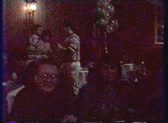

    Original:
    Brightened using Vegas Pro "Levels" fX, using only the gamma control:

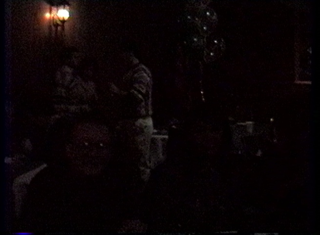

    Looks to me like the black levels are crushed, dark shadows disappeared.
    Assuming this is an analog capture directly from ATI 600 to HuffyUV, the proc amp settings adjustment may help
  4. You can make the left half of the image match the right half with ColorYUV(off_y=10). Unfortunately, blacks in the AVI file are crushed at Y=16 so you can't get back those deep black shades. You get something close to the other right half's blacks with a contrast stretch in the darkest areas:

  5. I saw the crushed (below 0) blacks in the Vegas histogram display, but I really don't think that contributes more than about 1% to the total problem because the video is obviously so dreadfully underexposed.

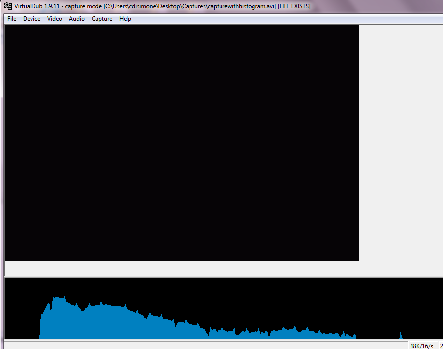

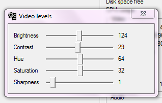

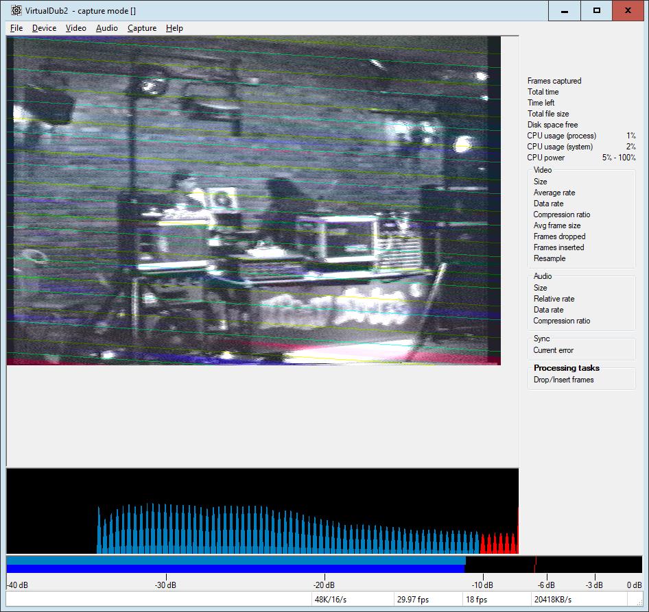

  8. Adjusting proc amp settings for capture device was good advice for me because it wasn't really on my radar doing this for the first time - so while it seems obvious to you, it wasn't even something I thought of until you mentioned it. So thanks.
    I went back and recaptured the same segment dialing the brightness way up and the contrast up a little. I assume if the lights get turned on later and the video source gets brighter, these settings will not work. How do you handle situations like this - just pick a happy medium?
    I uploaded my new capture - I guess this will need some tweaking as well but I think it's a much better baseline to start from.
    Can you guys explain to me the difference between using VirtualDub filters vs AviSynth plugins? Are there pros/cons? Do you do a combination of both? I read something about colorspace conversions and VirtualDub only working in RGB, and that not being ideal.. is that right? If I am ONLY doing a crop/mask in VirtualDub to hide tape noise and center video, does the video need to be re-encoded? (And which mode do I need to be in.. full processing, normal, fast, direct.. etc)?
    Also, the volume meter in VirtualDub during my capture was hovering between -10dB and -6dB. Is that where I want it?

    You can capture a short clip then access the file in Virtualdub using the levels filter. You can sample the
    file to get an idea of how close you are. This file went a little to far the other way, but this is much more correctable in Avisynth

    (Ignore the diagonal lines in the video preview -- I think that's some artifact of using a file is input to the capture module.) You especially want to avoid peaks at the very ends of the histogram. Those represent parts of the picture that are blown out. Detail cannot be recovered in those areas. It's hard to see in that image but there is a red bar at the far right edge. That's the blown out white areas of the image.
    In your particular case I think your capture device crushes blacks at Y=16 before giving the video to VirtualDub so you want to avoid a peak at the left end of the blue part of the histogram.

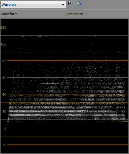

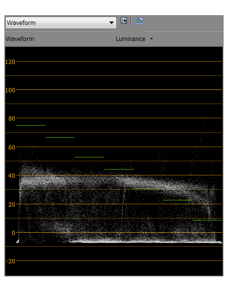

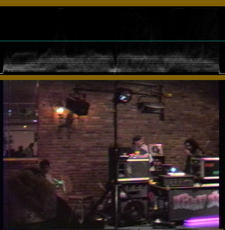

  13. Please don't take this the wrong way, but seeing what you did by using controls that you don't understand is almost certainly going to give you worse results than the DV capture. The one reason I continue to advocate for using DV, despite the chorus of boos I always get from those who correctly point out its color deficiencies (and sometimes the DCT compression artifacts, although the severity of those depends a LOT on the quality of the DV chip you are using) is that DV gets the levels right. I'll bet that if you posted one of your original DV captures of the same material, that it will not have the problems that everyone is complaining about with your ATI 600 captures.
    If you are going to continue using your ATI 600, you need to use software that gives you access to a histogram and you need to learn how to use it.
    The first picture shows the histogram of the first capture you posted, with the crushed blacks. Look at all the content that is below the zero line. What you did by setting the proc amp incorrectly was to map all of those dark pixels to completely black. This cannot be reversed because once a pixel is pure black, it can no longer hold any valid picture information.
    The second picture shows your latest capture. The good news is that there are no more crushed blacks, but the bad news is that you'll now see all sorts of bright spots above the "100" line, indicating blown-out highlights. When you transfer normally-lit scenes using these same proc amp settings, those scenes will be completely destroyed.
    As others have said, your goal in doing the transfer is to faithfully reproduce exactly what was on the tape, and then do whatever restoration is possible by using software in post production. AVISynth has a wider range of tools for improving video. This is because it makes it much easier to use video from multiple frames in order to improve the current frame.
    So, start reading up on what brightness levels 16-235 and 0-255 mean; what 7.5 IRE setup is all about; and what Studio RGB means.
    I would love to see you post the exact same video clip captured using DV. I'll bet its levels will be more accurate, and pretty darn close to the original.

  16. Note the images that johnmeyer posted are not histograms, they are waveform monitors, from Sony Vegas, I believe. The AviSynth filter called Histogram() gives a similar waveform monitor by default. It can display histograms for all three channels using Histogram(mode="levels"). It can also display a UV plot and several other things.
    http://avisynth.nl/index.php/Histogram
    Personally, I find a waveform monitor to be much more useful than a histogram. The former includes a lot of spacial information in addition to brightness information.

  19. OK, I attempted recapturing and setting brightness and contrast based on viewing the histogram alone (since I can't see the video while I am looking at the histogram in VirtualDub preview mode). I also temporarily cropped the black edges off while viewing the histogram, and then put them back for capture, and then subsequently cropped them off temporarily in my AVS script not to throw off the blacks when viewing histogram("levels"). Am I doin' this right?
    I attached screenshots of where the histogram was during capture process, as well as the histogram in levels mode in AviSynth.
    I had to bring up the proc amp brightness from default 110 to 124, and the contrast down from default 32 to 29, in order to not get any reds at the bottom or at the top. Everything is still pushed heavily towards the left, but I don't think I've lost the deep blacks this time, have I? We expect it to be pushed to the left since it's a dark video, right?
    It still seems pretty dark to me. Can I push the limits with the proc amp settings and make brightness a little higher, and then dial contrast down a little to compensate for any crushed whites? Or is that going just make the video way too flat, dull, and gray and require more post processing?
    Attached a part of the re-capture as well. How's this one?
Name:	Capture histogram vdub.PNG
Name:	histogram levels mode avs.PNG
    Image Attached Images
  20. I pumped up the gamma and applied a very strong denoise filter to the second video. This is probably further than you want to go but it gives you some idea what's possible.
    LWLibavVideoSource("firstcaptake2-trimmed.avi")
    AssumeTFF()
    QTGMC()
    ConvertToYV12(interlaced=true)
    MCTemporalDenoise(settings="very high")
    ColorYUV(gain_y=70, off_y=-72, gamma_y=300) # full range and gamma
    ColorYUV(cont_y=-40, cont_u=600, cont_v=600, off_u=0, off_v=-17) # back to limited range, color adjustments
  21. Oops, I didn't see your latest sample. I took a quick look at it and the levels are pretty good. The black level could stand to go down a little lower because the black borders at the left and right are the darkest part of the frame -- and you don't really care about those. That's where a waveform monitor is helpful:
    [Attachment 54754 - Click to enlarge]
    In case you don't understand a waveform monitor:
    https://forum.videohelp.com/threads/340804-colorspace-conversation-elaboration#post2121568
  22. I agree with Jagabo. As I expected, and as I constantly say, DV is how people should transfer their VHS tapes. This thread provides all the reasons for why I recommend this.
    In particular, your DV capture looks exactly as it should, with levels that are normal. The video is still dreadfully underexposed, but I was able to make the result brighter in Vegas using just the levels control. For the really dark portions of the scene I also used color curves. The next step would be to then denoise the result.
    Since Jagabo already posted the results of his efforts, I chose to make mine brighter. It isn't necessarily any better this way, but I thought you should see something different.
