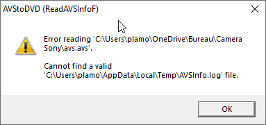

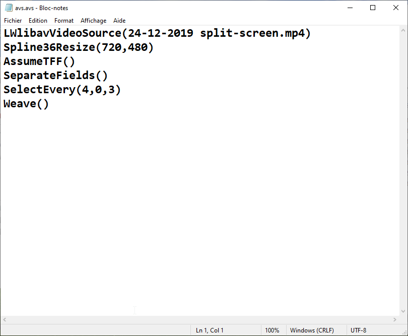

  12. So I created an AVS file in the same folder as my video file and put in there jagabo's script. I tried to open the AVS file in AVStoDVD just like I would open a video file, but it won't open.
  13. Did you change the path and filename for the file in the script?
    You need a better diagnostic error message that contains more information. Open the script in vdub2 or mpchc and report what the error message says
  14. Does AVStoDVD come with LSMASH? LWlibavVideoSource() and LWlibavAudioSource() are included in that package, not as part of a basic AviSynth install. I used those just because they open may types of files and many different codecs. Depending on your source you may be able to use another source filter that comes with AVStoDVD. I don't know what in includes -- maybe AviSource(), ffVideoSource()... Or you can probably add LSMASH to it's AviSynth filters.

    This is the .avs file, which is in the same folder as the video file, and the error message when I try to open it in AVStoDVD.

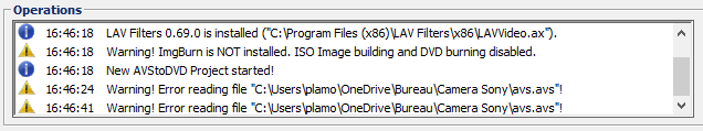

    At the bottom of the main window (left of the start button) there is a window of messages.
    Are there any warnings or errors there?
    Did you run the install or are you trying the portable version ?

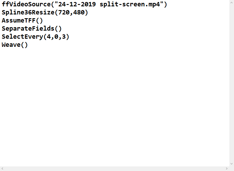

  18. Try changing LWlibavVideoSource(24-12-2019 split-screen.mp4) to ffVideoSource("24-12-2019 split-screen.mp4") -- and be sure the filename is in quotes.

    There are other messages in that window not visible.
    What is before the LAV filters line

    Yes, but add the full path to the script - eg.
    FFvideosource("c:\mypath\file.mp4")
  22. Above the LAV filters line it says : AviSynth 2.6.0 is installed ("C:\WINDOWS\system32\avisynth.dll")
    and
    AVStoDVD Release 2.8.6 loaded
