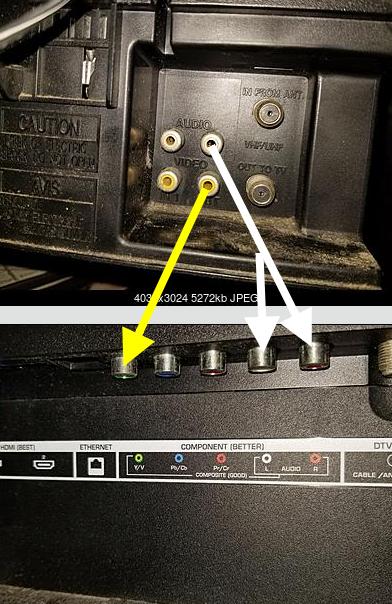

I have a Vizio (about 4 years old) and I'm trying to hook up a dinosaur of a VCR. Back of device pictures attached.

The Y input of the component section of the TV appears to also be a composite video input.
https://www.lifewire.com/shared-composite-component-video-input-connections-4103732
Get a male/male RCA A/V cable like this: https://www.amazon.com/iMBAPrice-Audio-Video-Cable-Plated/dp/B00BDYK1Q0/
Use the yellow cable to connect VCR's yellow RCA output to the Y/V RCA input on the TV. Then use either the red or white cable to connect white RCA output of the VCR into either the red or white RCA input on the TV. You'll have to select the A/V input within the TV's menus (or on the remote) to see the VCR output on the TV. That's all you need. But don't be surprised if the VCR no longer works.
[Attachment 54640 - Click to enlarge]Last edited by jagabo; 25th Aug 2020 at 13:29.
There is an alternative to what jagabo suggested. Consider using a short piece of coaxial cable. Connect the VHF/UHF OUT of the VCR to the CABLE/ANT input on the TV. Switch the TV to OTA channel 3 or 4 to view the VCR output.
While I actually have not tried that on a newer Vizio, if it can also receive analog TV channels in the digital tuner, that should work, howbeit not always the best picture, but OK for viewing. -
