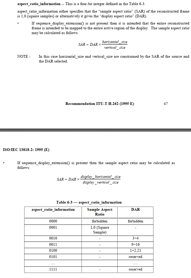

We can collect some details from here, which is however not the official DVD spec. The 3 Aspect Ratios (DAR) are 1:1, 4:3 and 16:9, and the sequence_display_extension is also mentioned. We would have to assume that this mpeg-2 part is included in the DVD spec although it is not explicitly said so. The DVD spec includes only a subset of the mpeg-2 spec.
http://dvd.sourceforge.net/dvdinfo/mpeghdrs.html -
