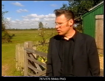

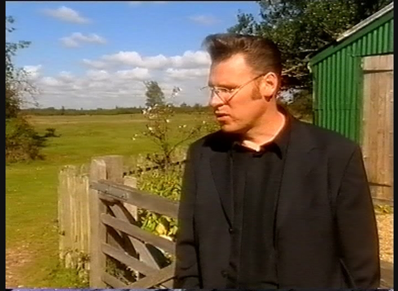

  18. Originally Posted by DB83 View Post
    Consider the following quick sample mpeg2 (dvd-compliant) which is sourced from a DV original - cropped 18 pixels but then 18 pixels added back.
    While this, if I read you correctly, confirms to your 'idea' of compliance, those 702 pixels will not, nor can not, end up displayed as 768 pixels.
    It's not my idea, it'a an ITU-R standard, I didn't come up with this stuff.
    If the active image is contained in 702 pixels intended for 4:3 aspect ratio, then it's correct and compliant.
    As you can see it is expanded properly to square pixels, they can and should be displayed as such, however the blanking is not cropped, as it does not have it encoded in Sequence Extension.
    Just because you have software and hardware written by morons that have no idea about ITU does not mean I have identical software.
    Oh and it's clearly analog video converted to digital, so there was no need to crop pixels and pad them with black, it was already acptured like that, because like I said, REC.470 spefifies active image as 52 µs and according to REC.601 analog signal is sampled at 13,5MHz and the 53,333 µs of the line is sampled so it ends up with blanking sampled in 18 pixels either way.
