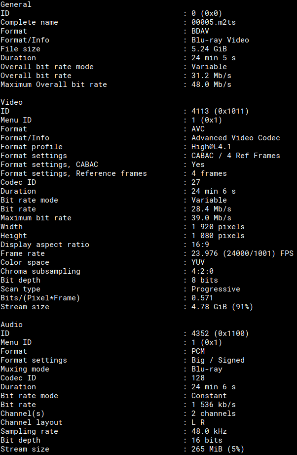

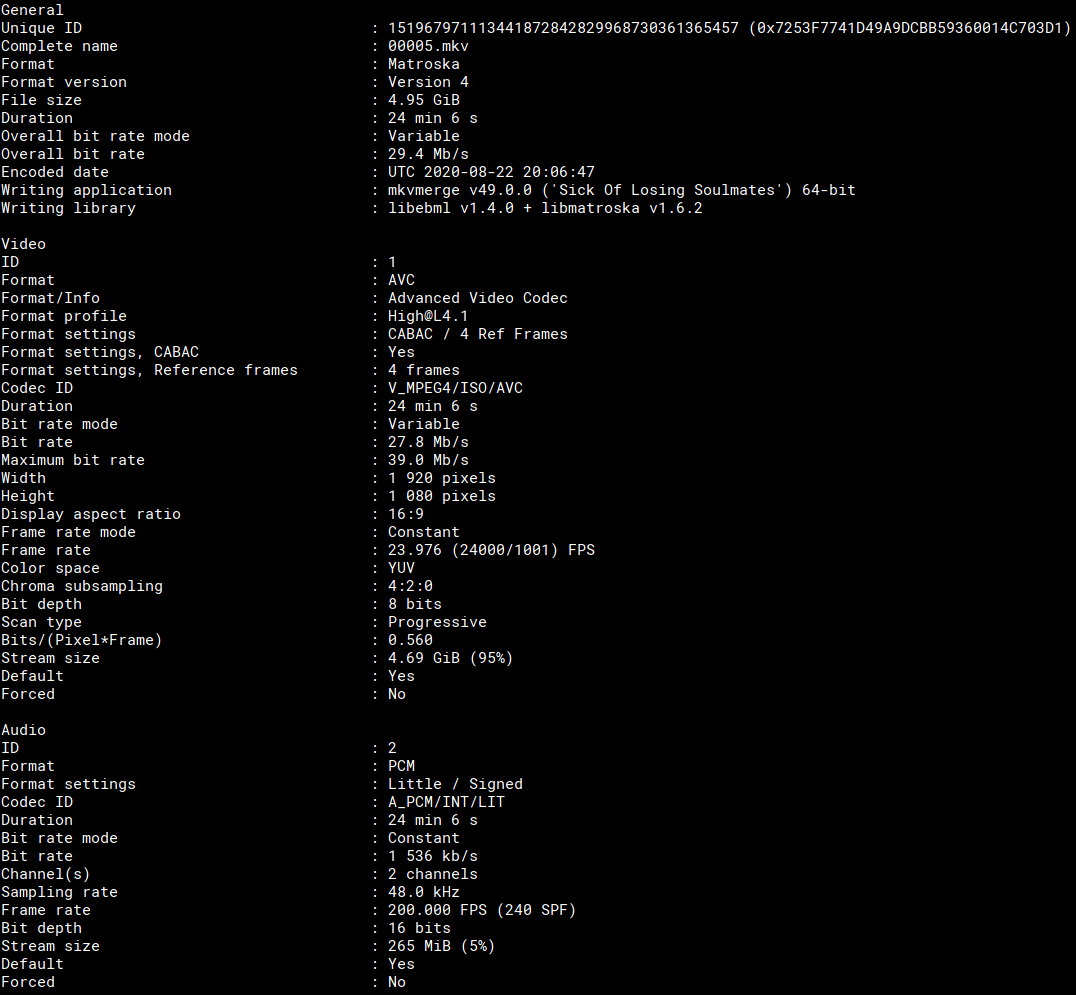

  1. So I noticed that after using mkvtoolnix on the .m2ts file, the .mkv output was a bit smaller. I took a closer look at them with mediainfo and saw that the video streaming size got smaller.
    [Attachment 54598 - Click to enlarge]
    [Attachment 54599 - Click to enlarge]
    From what I read on another thread, this could be because of MKVToolNix removing empty filler NALUs. But I also read that by demuxing the video stream from both the .m2ts and .mkv file with something like tsMuxeR, I could compare the two and see that it's the same data/size, but it wasn't the case.

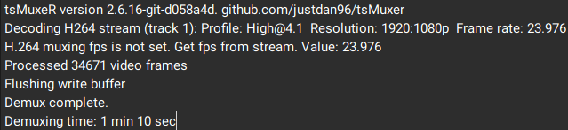

    .m2ts tsMuxeR demux output:

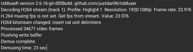

    .mkv tsMuxeR demux output:
    [Attachment 54601 - Click to enlarge]
    Size comparison:
    [Attachment 54602 - Click to enlarge]

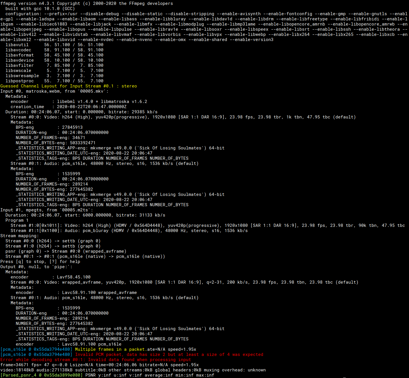

    I also tried to check the video integrity of the .mkv file with ffmpeg: ffmpeg -v error -i 00005.mkv -f null - 2>00005mkv.log
    but what I got was this:
    [Attachment 54603 - Click to enlarge]
    even tho while doing the same integrity check on the .m2ts file: ffmpeg -v error -i 00005.m2ts -f null - 2>00005m2ts.log
    did not result in ffmpeg giving me any kind of error.

  2. Not sure about the audio warning that ffmpeg gives - but a change in container and elementary stream size is "normal" and expected when using MKV
    mkvmerge removes filler packets, sync bytes, AUD NALs, and strips repeated headers(uses global header instead) and sequence headers. The stripped sequence headers from the elementary bitstream is the main explanation for the small difference when demuxed. This is well documented for AVC, because this causes compatibility problems with AVC BD authoring in strict/professional programs such as Scenarist BD (thus people avoid MKV container when authoring, and always use elementary streams)
    The actual video data - the decoded bitstream - will be identical. eg. You can check with PSNR. (If it's not infinity/lossless, then there is a problem.)

  5. The PSNR did result in infinity.
    [Attachment 54605 - Click to enlarge]
    Thank you very much for your help and for being so smart because I would have never been able to make such a command to find what I needed.
    ffmpeg -r 24000/1001 -i 00005.mkv -r 24000/1001 -i 00005.m2ts -lavfi  "[0:v]settb=1/AVTB,setpts=PTS-STARTPTS[main];[1:v]settb=1/AVTB,setpts=PTS-STARTPTS[ref];[main][ref]psnr" -f null -
