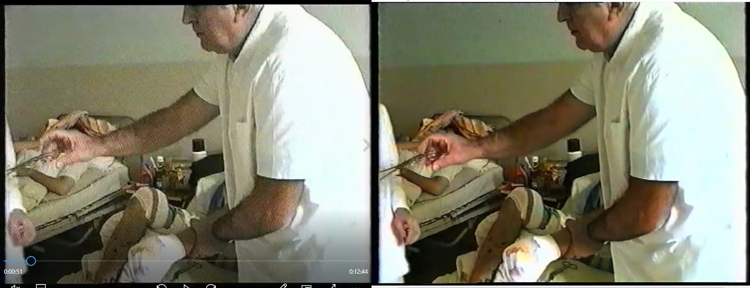

    Hi, I just got the Terratec AV 350 MX. Looks like a fantastic capturing device, so far I'm enjoying it.
    I tried both the Scart input and the S-Video input. For whatever reason I don't know, the S-Video quality is very bad, I see a lot of artifacts so I'm now only using the Scart capturing method.
    But, I seem to have the same stuttering issue you have too. I might try going Windows 7 to check if this could resolve it.
  15. Capturing Memories dellsam34's Avatar
    Jan 2016
    SCART will only have composite or S-Video, If you are not using S-Video that means you are using composite, I don't think for a second that composite will look better than S-Video, Unless your VCR is limited to composite only and the adapter is converting from composite to S-Video which leads to a slight degradation. What VCR are you using?
    Dec 2012
    Greece
    Yes, obviously my VCR can't output S-Video.
    Check this screenshot for yourself.
    Apart from the color range that seems to be different, look at the hand of the doctor.
    Left Image is S-Video and Right Image is Scart (Composite)
    [Attachment 57958 - Click to enlarge]
    I have tested capturing on Windows 7 and it works! No more stuttering!
    Too bad, the second time I tried to capture the VHS I get some glitches from the VCR heads. I just ordered a VHS Wet Cleaning Tape.
    My VCR is an LG BC205P.
