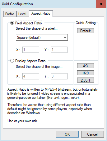

  16. Originally Posted by MasterNe0 View Post
    I just don't understand why the videos are going from a 16:9 ratio to a 4:3 ratio as I set the settings to use the original ratio during the conversion.
    Presumably there's a setting in the program that will let you specify 16:9.
    [Attachment 54564 - Click to enlarge]
  17. Originally Posted by jagabo View Post
    Not for the encoder it using for xvid. Their no setting to change it.
  18. Originally Posted by MasterNe0 View Post
    And there's no aspect ratio setting elsewhere? What a useless program. Why don't you use one of the open source converters like HandBrake, VidCoder, VirtualDub2, etc. They're better, completely free, and don't show ads.
