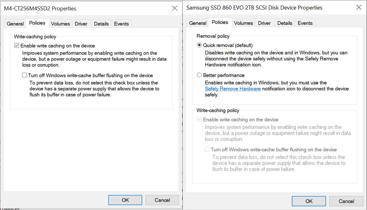

	Check in control panel-device manager-disk drivers and see if enable write caching on the device is checked on the concerned drives. I think,therefore i am a hamster.
	Here's the write caching comparison.
 The file is in the external Samsung SSD. The OS is in the Crucial.
 Would say the problem is in the Samsung then?
 In fact, I just processed a video file in an internal HDD with MKVmerge, and the processing took 30 seconds.
 Should I change the Samsung to "Better performance"? This is new for me.
	OK. Did the test, selecting "Better Performance", instead of "Quick Removal".
 Then processed the file again, which is 8Gb. It took 6.30 minutes, which is just 30 seconds less than yesterday.
