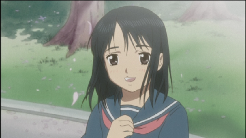

  8. heres the image of the video at hand, its kinda fuzzy, blurry and i dont know how to filter this video
    [Attachment 54553 - Click to enlarge]
  9. First of all, VirtualDubMod has no problem opening AviSynth scripts. So your original problem wasn't VirtualDubMod but rather something wrong with your D2V file -- rebuild the file yourself with DgIndex.
    VirtualDubMod was almost certainly a 32 bit version. I suspect you ran 64 bit VirtualDub2 and don't have 64 bit AviSynth installed. The 32 bit and 64 bit video systems under windows are completely separate. Neither environment can see the other. So you must have 64 bit AviSynth (and filters) if you use a 64 bit editor/encoder, 32 bit AviSynth (and filters) if you run a 32 bit editor/encoder.
  10. ok but what filters should i be using?????
  11. What do you want to do? Upload a sample of your source without any conversion. Use DgIndex to extract a short sequence with motion, especially a panning shot: mark-in, mark-out, File -> Save Project and Demux Video. Upload the resulting m2v file.
