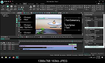

  1. I'm new to video making, but I think I've got a hang on VSDC, or the parts I'll care about anyway, but I'm having a problem with the text.
Name:	Text Problem.JPG
    The text on the left is from an image I made and the right is from VSDC's text tool. (Ignore the middle. It's probably hopeless and makes this question kind of ironic.) It's easiest to tell with the X, but it's a little blurry. If I zoom in out out any it becomes obviously blurry. How do you make it less blurry? (If you need to know the font used, it's from text boxes in Pokemon. Look up Pokemon Pixel Font.)
    I'd say sorry if this is in the wrong area, but this is the section for newbies and if you don't know what area to use. I would've asked in the subtitles section, but a look in there gave me a feeling this is different.

    It's going to get zoomed in or out on Youtube, so that's not really an option. I want it to be "more perfect" so it gets less distorted.
    The main problem is this. See the Capital Ts on the right side? They look like the pillar part is two pixels of white, but it's actually one pixel of white, a lighter shade of grey on the left and an almost invisible dark gray on the right. The left side's Ps really are two pixels thick so they blur less when zoomed.
    By the way, if there's no easy way, an idea I had is to use a combination of filters Black and White and Pixelate are ones that look promising. (Please let me know if, for some reason, someone found a combo that works with this text.) If that doesn't work, the worst case scenario is type everything, take a screenshot and edit out off color pixels in Paint, (It's way easer than it sounds if you use copy/paste and change the background color.) save it as an image, then add the image to the video... It would work and I've had worse ideas.

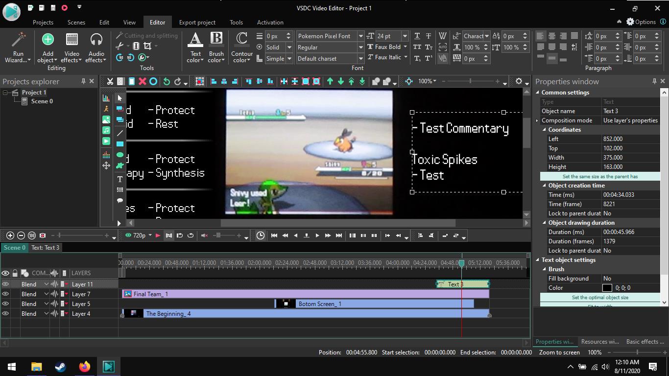

  4. It looks like text antialiasing, or subpixel sampling. Check if there are options to change antialiasing
    Your coordinates are all integer numbers in the screenshot, but check if it makes a difference if you keep even numbers. e.g. instead of width of 375 try 374. For height try 162
  5. Maybe I misunderstood. I thought you originally had small text like on the left and it became blurry when you zoomed into it on the right. There's no way to avoid blurring or distortion when you do that. If you are using the programs text tool to create new text, yes, turning off antialiasing may give you sharp text.
  6. Originally Posted by poisondeathray View Post
    I tried adjusting the pixels and odd numbers are blurrier. I'd try antialiasing, but I can't find an option. I right clicked and looked through all the options and it isn't in basic effects either. The annoying part is the website says it's a thing.

  7. Originally Posted by CTNC View Post
    http://www.videosoftdev.com/video-editor-doc/editor-objects/standard-objects/text
    Are you using the "free" version? It might be one of those "paid" features that "force" someone to upgrade . Check their user forum too , if they have one
    Text
    Antialiasing – this parameter determines if the edges of the text should be smoothed or not.
    If that is the cause - it's most likely a setting with the text itself, not a global setting, otherwise your applied image text would be antialiased as well
    Scaling - certain types of scaling algorithms can produce more blurring, or ringing, or antialiasing. If you are scaling the text outside of the text parameters, check if there are options to adjust the scaling parameters

    I didn't see a forum, which is why I came to this general help forum.
    This is the free version, but if something's part of the paid version, it says so but still applies it as a preview until you export the video. Also, picture in picture in in the free version, so why would antialiasing for text of all things be locked behind the paid version? (I know weird things are sometimes locked behind paid versions, but this?) I'm kind of suspecting that part of the site is out of date.
    Scaling only has horizontal and vertical, no different types.
    I think the real problem is I'm trying to remove a quirk with how programs process text. For example, if you take a screenshot of this post and zoom in, you'll see the black pixels have light red on the left side and light blue pixels on the right. The [ doesn't even have pure black pixels in the vertical bit! I think I'm asking something that sounds simple, but is actually stupidly hard or impossible.
