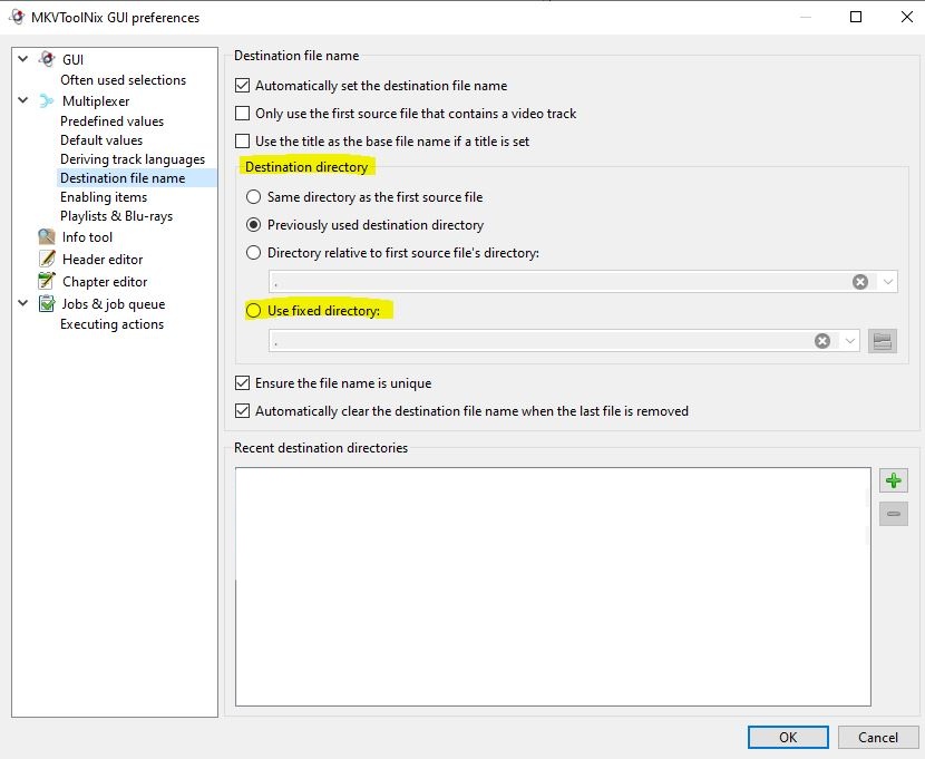

Apologies for asking such a basic question, but I've been using mkvtoolnix for years to add subtitles to video files, and I have always used the same destination folder for all outputs, a location where I can check I've got everything right before committing to a final destination.
I've upgraded to a new PC, and installed mkvtoolnix, but I can't find a way to set a default destination folder. Instead, mkvtoolnix seems determined to output files to the same folder as the input file.
I have a 50-episode Korean TV series to which I want to add subtitles, and it's frustrating to be constantly overriding the output location to prevent the output files from getting mixed up with the input files.
I suspect I've missed something obvious, but I'd be very grateful if someone could tell me how to set a default destination folder!

It's in the Preferences
[Attachment 54523 - Click to enlarge]Last edited by ronmaz; 13th Aug 2020 at 18:06.
