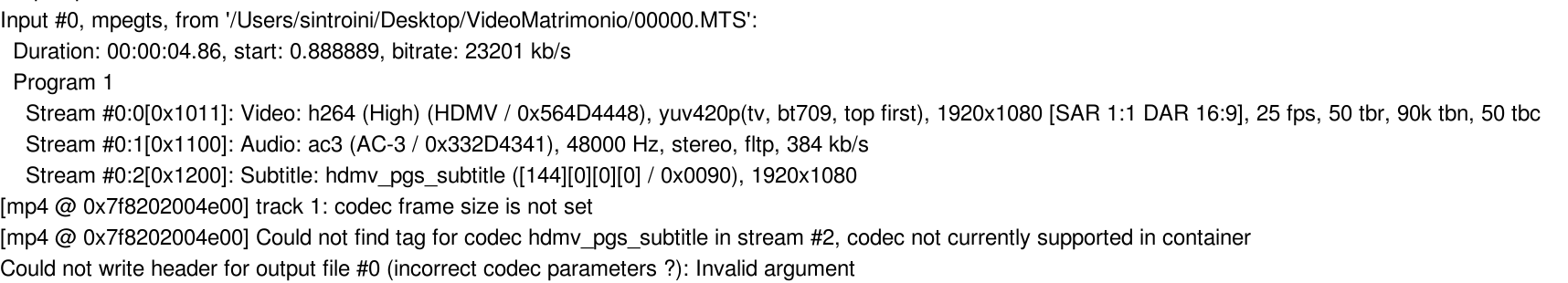

  9. I tried to rewrap with shutter but I have an issue. Sorry but I cannot understand why I cannot copy&paste from Shutter encoder console window
    I attached a slice of screenshot
Name:	Screenshot 2020-08-15 at 10.33.17.png
  10. Looks like ffmpeg is choking on your subtitles while trying to rewrap (most likely the subs are simply a time code overlay.)
    Two options -- rewrap to .mov rather than .mp4, which will make no difference in the actual video and audio (-- and then optionally. rewrap again to .mp4 form the .movs.)
    Or use a simple command line in ffmpeg:
    -i yourfilename -codec copy -o yourfilename.mp4
    (I've tested this before posting. I got a similar error in Shutter, but both of the methods I described worked fine. My MTS files are from a Sony camcorder so I don't know if they are identical to yours.)
