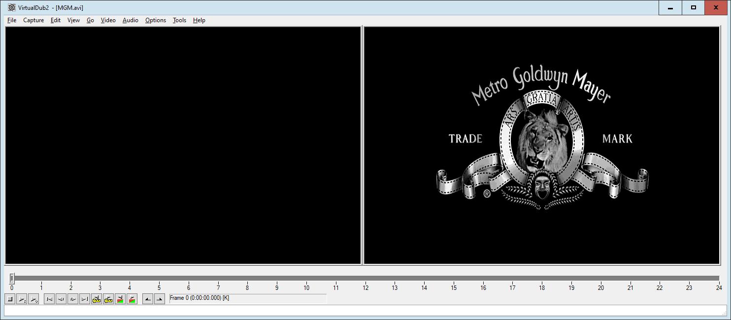

  25. Here's an extreme example. See what you can get out of the attached Lagarith AVI.

  27. Every pixel in that AVI file has a luma value of less than 16. It's possible to recover those pixels with the right filters. That's what I showed in the screen cap. Obviously, you wouldn't capture a VHS tape like this. But if your VHS cap contains Y<16 values they can be made visible as very dark shades of grey, not just a flat black.
