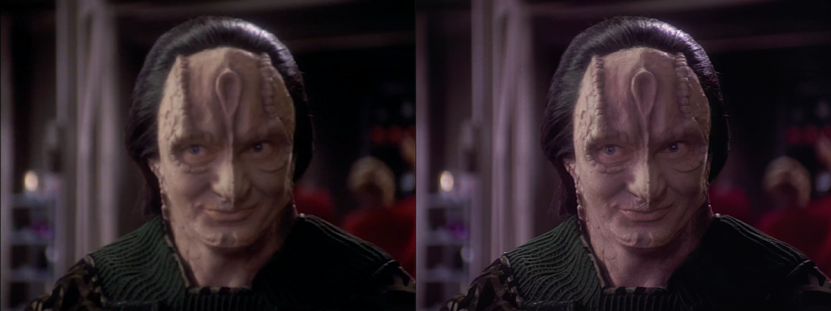

    [Attachment 54505 - Click to enlarge]
  2. If I play the DVD straight in VLC, I can step through frame by frame (actually probably field by field, but looks like frames since deinterlacing is turned on) and I can see every frame as it should be, no interlacing artifacts, and no combined frames at scene cuts. But so far no conversion method I've tried preserves this.
    What deinterlacing mode is VLC using ? If it's set to "Automatic", do you obtain the same result by specifying one of the available modes ?
    As for the screenshots, what do they show ? Is the DVD version on the right or the left ? There seems to be a color discrepancy between the two.

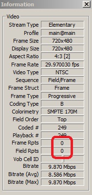

    No, it doesn't. No flags at all. It's hard telecined, meaning the repeated fields are encoded into the video.
    I have a workflow there I can use to manually IVTC each scene, though it's time consuming.
    You'll be much better off using the AviSynth IVTC, TIVTC. If there are any anomalies, you can set up override files to fix them.

    Yeah it's set to automatic. Just went through all the modes and I can't tell a difference between any of them.
    The left is from iTunes and the right is my (current) final upscale product. Topaz seems to do some kind of color shifting or correction as well in it's processing. I personally like it better, looks a little more lifelike, less yellow/green.

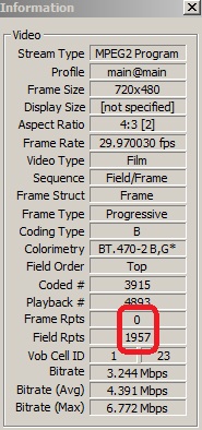

    I'll enclose a DGIndex pic from a film with real pulldown flags. I don't know the reason because I don't know what you're using to make it 23.976fps, but you're probably using it wrong.
