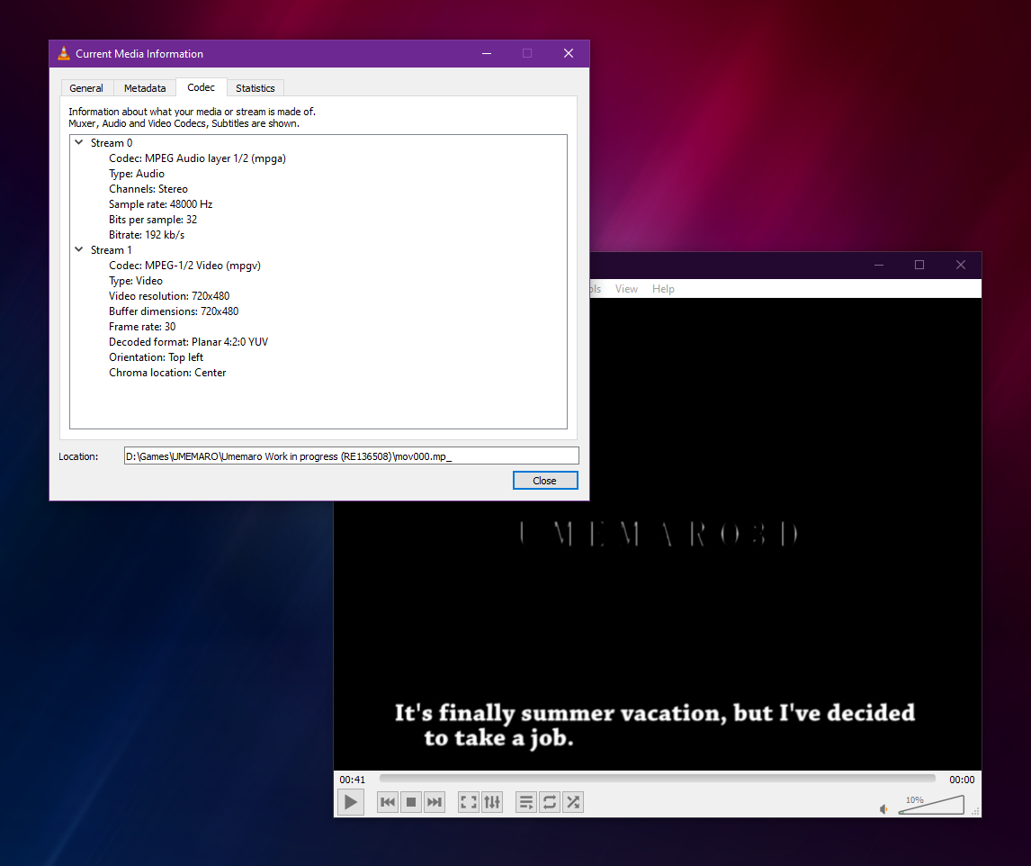

    vlc media/codec info
    [Attachment 54469 - Click to enlarge]

  4. Since VLC can play the video and the audio the files aren't encrypted. The files have the extension .mp? but are MPEG Program Streams -- which is usually .mpg. In all likelihood all you need to do is concatenate all the files into one big file.
  5. Originally Posted by jagabo View Post
    how do I do that.
    how do I mux them all ? format factory cant do the job.

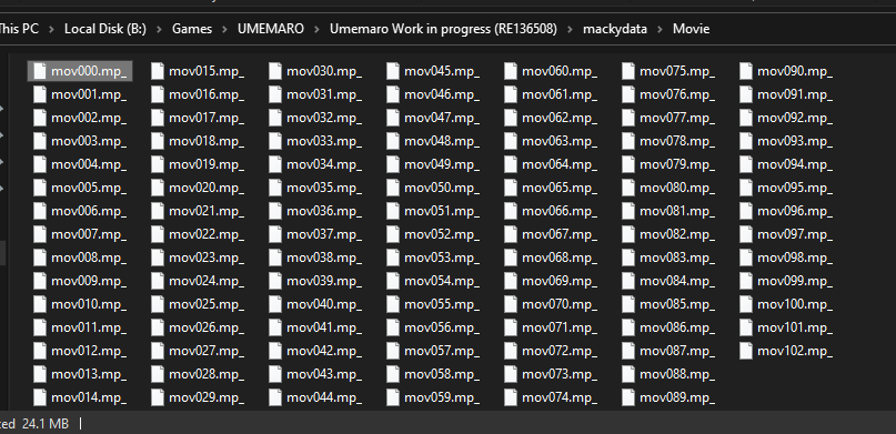

    Mar 2008
    Use a command like this:
    copy /b file1+file2+file3 targetfile
    presumably the first part has the file header. Does this part play or give any further info in mediainfo ?

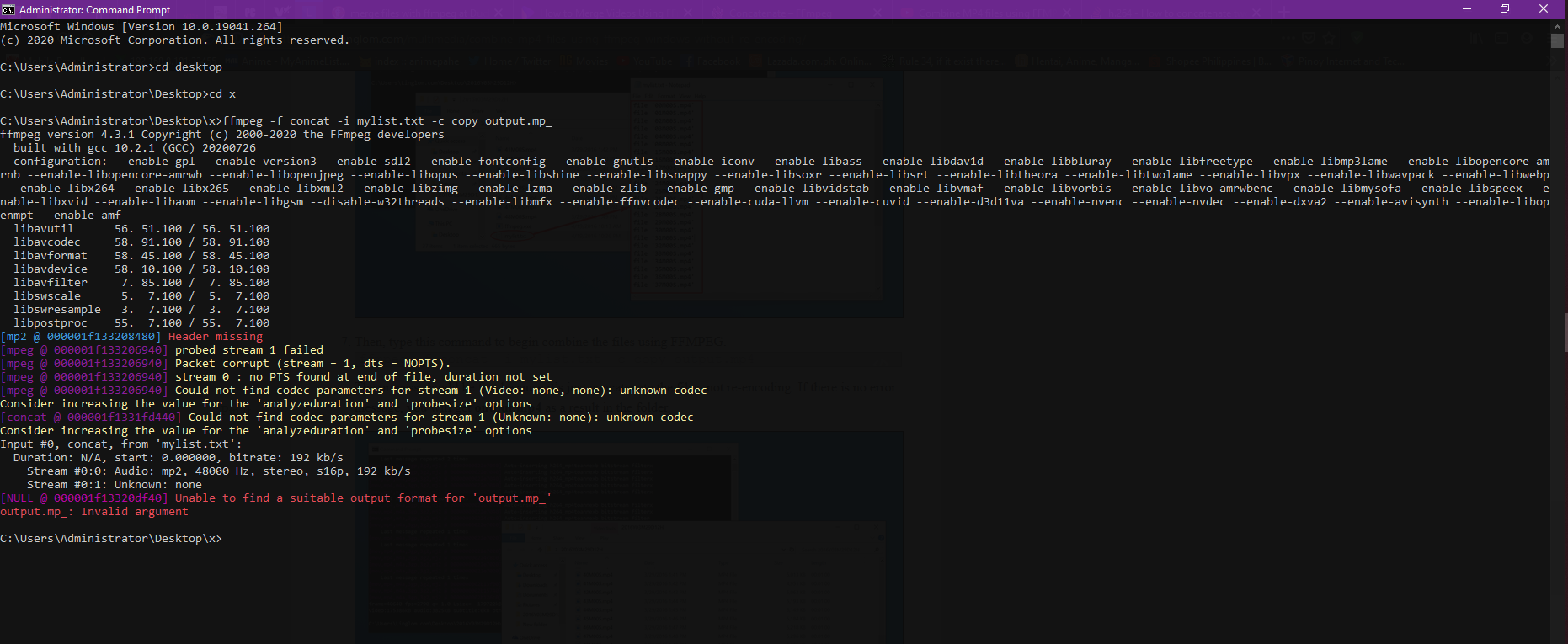

  12. Originally Posted by johnmeyer View Post
    ffmpeg can also concatenate (join together) individual video files, in case the copy /b doesn't work (which it often doesn't). Try the copy /b first, however, because it's easier.
    i downloaded ffmpeg from that link
    tried opening the files from bin but it wont.
    I dont know how. the readme file doesnt contain instructions
    Mar 2008
    You open a command prompt and type in the commands. Similar to the copy /b situation

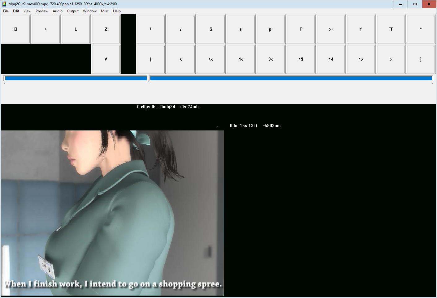

  14. I didn't notice the sample in the first post. It's not a "normal" mpg video. At least the first GOP is corrupt. But Mpg2Cut2 can see and play the video (though there is some minor corruption) but doesn't save properly:
    [Attachment 54470 - Click to enlarge]
    Mpg2cut2 can concatenate segments if you want to try it yourself (I suspect it wont' work properly though). Or if you can provide the next two files in the sequence I'll see what I can figure out.

  18. A few random observations :
    – None of those files have a standard MPEG header / signature. A standard MPEG file begins with hexadecimal bytes 00 00 01 BA. Here only the first one begins with something close but not quite right : 02 01 B0 02. MPEG signatures are found within the files however, but at variable offsets (+1228 for mov001, +1635 for mov002...).
    – Simply merging the five files doesn't result in a readable file, although it does align the headers at sector boundaries for the second file -- but not for the third.
    ffmpeg doesn't properly recognize the files.
    [mp2 @ 0000000000385580] Header missing
    [mpeg @ 000000000036fd40] probed stream 1 failed
    [mpeg @ 000000000036fd40] stream 0 : no PTS found at end of file, duration not set
    [mpeg @ 000000000036fd40] Could not find codec parameters for stream 1 (Video: none, none): unknown codec
    Consider increasing the value for the 'analyzeduration' and 'probesize' options
    Input #0, mpeg, from 'G:\mov000.mp_':
      Duration: 00:00:00.35, start: 4.891078, bitrate: 587452 kb/s
        Stream #0:0[0x1c0]: Audio: mp2, 48000 Hz, stereo, s16p, 192 kb/s
        Stream #0:1[0x1e0]: Video: none, none, 30 fps, 30 tbr, 90k tbn
    [mpeg @ 000000000014fd40] probed stream 0 failed
    [mp2 @ 000000000015b2c0] Header missing
    [mpeg @ 000000000014fd40] stream 1 : no PTS found at end of file, duration not set
    [mpeg @ 000000000014fd40] Could not find codec parameters for stream 0 (Video: none, none): unknown codec
    Input #0, mpeg, from 'G:\mov001.mp_':
      Duration: 00:00:00.26, start: 6.643078, bitrate: 356541 kb/s
        Stream #0:0[0x1e0]: Video: none, none, 30 fps, 30 tbr, 90k tbn
        Stream #0:1[0x1c0]: Audio: mp2, 48000 Hz, stereo, s16p, 192 kb/s
    [mpeg2video @ 0000000000565580] Invalid frame dimensions 0x0.
    [mp2 @ 0000000000552000] Header missing
        Last message repeated 8 times
    [mpeg @ 000000000054fd40] stream 1 : no PTS found at end of file, duration not set
    Input #0, mpeg, from 'G:\mov002.mp_':
      Duration: 00:00:00.21, start: 5.227078, bitrate: 114114 kb/s
        Stream #0:0[0x1e0]: Video: mpeg1video, yuv420p(tv), 720x480 [SAR 200:219 DAR 100:73], 4000 kb/s, 30 fps, 30 tbr, 90k tbn, 30 tbc
    MKVToolNix doesn't recognize those files.
    mplayer can demux them, but only the audio stream is recognized by MKVToolNix or ffmpeg.
    Avidemux 2.6 can open mov000, and suggests to append the other files. After so doing, the chunks seem to be out of order indeed. It shows a total duration of 01:01:933. Audio and video don't seem to be in-sync, though -- at several points the video suddenly jumps from some part of the action to another, while the audio seems to be continuous (or rather, the discontinuities are located at different spots), and at about 00:56 there's a sound of a zipper opening, while the pixellated c-o-c-k is already out and being thoroughly blown...
    If not appending the files automatically, and rather indexing them separately, then adding them one by one in number order, the result is different : the total duration is 00:31:833, the video doesn't become pixellated (except for the c-o-c-k obviously) when jumping from a segment to another, some parts seem correctly synchronized (there's a pee sound while pee is being peed and a brush sound while a brush is brushing), others not (there's a sound of a c-o-c-k being forced into a not-so-eager mouth while said mouth is shown still empty and half open at this point in time, while the aforementioned brush falls on the hard floor without making a sound). It's all very confusing.
    [EDIT] Tried MPG2Cut2, it shows parts which are not shown by Avidemux.
    doing it with Avidemux right now.
