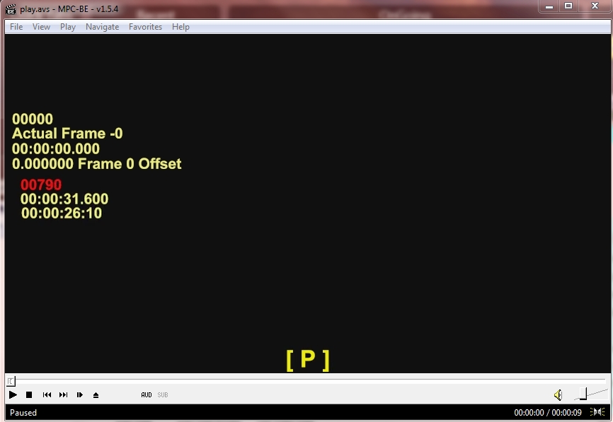

    Thanks for the help and it allowed me to follow your suggestions and found the problem. FFmpeg will indeed cut at other than an I frame ('P' frame) since they made the input -SS frame accurate. I know I'm going to hear a lot of criticism for that last statement but it is true.
    In my example the frame 790 is a 'P' frame and FFMpeg will cut that as pts 0.000000 without any freeze frame, audio w/o video, glitches in timing when joining to another segment from that video:
    [Attachment 54445 - Click to enlarge]
    As you can see the first frame of the resulting cut of 790-1040 shows during playback and ffprobes show_frames as a 'P' frame and plays in all my players without incident.
    HOWEVER... it appears like ffmpeg cuts at the 790 'P' frame and makes it's pts 0.000000 but it begins counting the 250 frames from the previous I-Frame. In this case it is at 750 so 40 must be added to the frame count (790-750=40)
    Using this method accurately cuts from 790 - 1040. It also appears I was incorrect that only 5 REFerence frame videos fail this was, it's just that most of the videos I have been using have had a GOP of 50 or less so I just never realized i could have been missing up to 2 seconds at the end of the cut.

  5. Originally Posted by Budman1 View Post
    I don't think this is true for "normal" videos, let alone ones with buggy timestamps . Unless they made it "frame accurate" in the last few days?
    Here is a sample video. 0,250,500,750.... are IDR frames. It's just default x264 encoding settings, nothing special . I want to cut on frame 398 inclusively, which is a P frame, for an output 120 frame clip. Clip is 24.0 fps . -ss 16.583 should correspond to frame 398
    ffmpeg -ss 16.583 -i "blank.mp4" -c copy -vframes 120 cut398_120.mp4
    You end up with a glitchy video that does not play at all in some players, and starts at 250 in others
  6. To start a cut (without reencoding) at anything than a key frame is bound to produce a damaged stream,... that's MPEG basic knowledge,...
    You can end a cut a P-frame since none of the frames before the P-frame can reference anything behind it.
  7. Originally Posted by Selur View Post
    Exactly .
    I was thinking that there was some "overhang" at the beginning (it actually cuts at the previous IDR frame) , But the timestamps shift so the display actually starts at the later frame . But an "overhang" is going to cause problems with joining/ editing . Anyways, what I see there is it starts at the previous IDR frame
