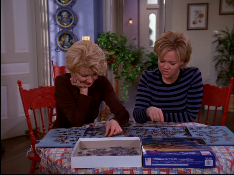

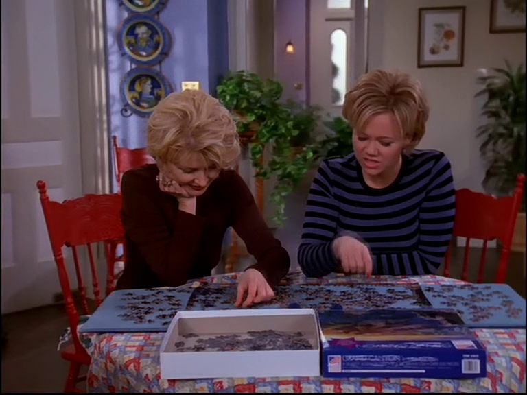

  1. I've been using a Avermedia EzRecorder 130 capture device to capture footage from my PVR (and having to use a hdmi splitter to bypass the hdcp)
    I hooked up my Blu-ray player, captured a DVD playing and compared it to a rip of the original DVD and notice a slight difference in the colour, which seems darker when capturing on the Avermedia device.
    Original DVD

    AverMedia
    [Attachment 54369 - Click to enlarge]
    What would be the correct level/script to use to restore the original colour back in Avisynth?
    I've also attached both files for reference.

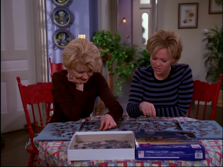

  2. This is closer , but still slightly off
    LSmashVideoSource("AverMedia.mp4")
    ColorMatrix(mode="rec.709->rec.601", clamp=0)
    SmoothLevels(1,1.02,255,0,255, chroma=200)
    SmoothTweak(saturation=1.05, hue1=1)
  3. Thanks for that! It's virtually identical now.

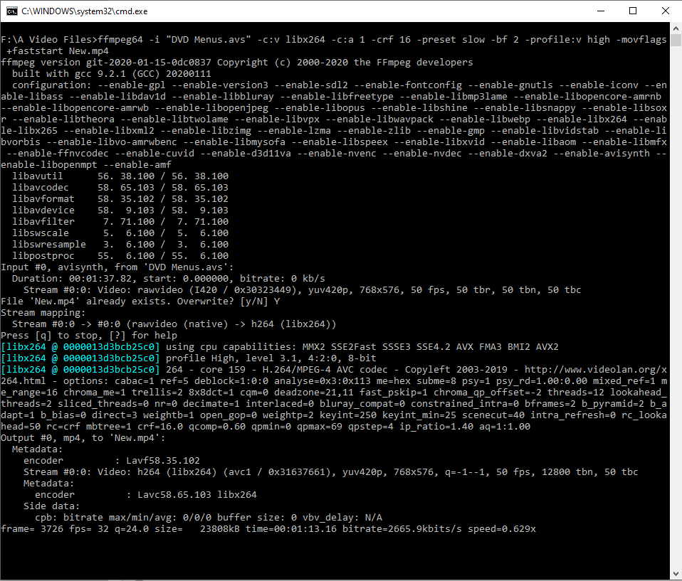

    LSmash seems to be causing the render to freeze at a certain point without finishing. I usually just decompress mp4 files to avi just to get it to work in AvsPmod, and have had issues using other source filters. It would be good though to just load the mp4 directly into AvsP without issue.
