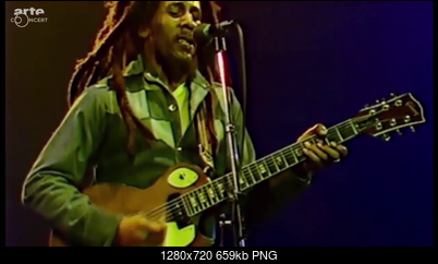

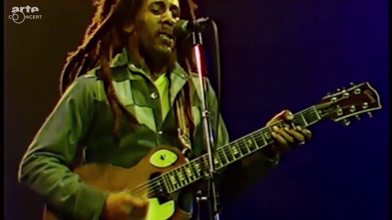

    ...and claustrophobically frames actors from their eyebrows to their waists
Name:	201512270125 - Arte - Bob Marley Uprising live !.mp4 - 00_07_58 -_2020-08-05-09h27m22s018.png
