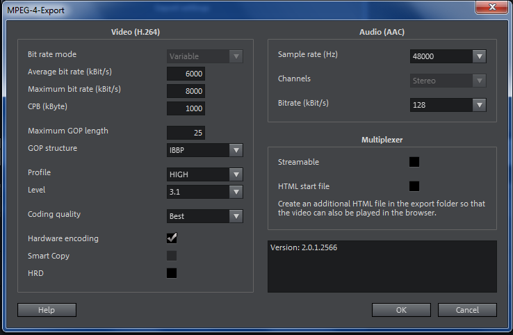

    I took a screenshot where you can see my advanced options before exporting the video:
    [Attachment 54360 - Click to enlarge]
  5. Your bitrate is too low. GoPro's native 2.7k is encoded at 60-100 mbps in H.264. So start with about half that.
