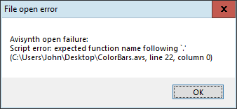

"Cannot render the file" error msg with Avisynth+
I might be missing something basic here, but I'm getting this error a lot:
- try loading a plugin that isn't at defined path
- use a variable that hasn't been defined (was commented out)
- use LWLibavVideoSource with cache=true + cachefile="c:\Temp\temp.lwi"
- syntax error on if statement: if doAudio vs if (doAudio)
Does Avisynth+ provide useful error messages somewhere ?
I modify my code, launch the avs, and then see this message on the Output, and each time have to debug with return statements. -
That message is probably coming from the editor/encoder you're using. AviSynth usually gives a line and column number of the error in the video it outputs. I usually use VirtualDub2 to check my scripts. It passes those messages along:
[Attachment 54417 - Click to enlarge] -
>> I'm getting this msg in the video player, when there is a syntax error in the avs script.Originally Posted by butterw
With AvsPmod, I do get more info about the actual error if I launch in the integrated video player (Shift-F5) rather than the external video player (F6).
This does suggest however that editing an Avisynth+ script with a standard text editor isn't practical and that the end-user should install AvsPmod (or equivalent) to be able to configure the script.
Is there a way in Avisynth+, to get the error output by launching the script from commandline ? I'm getting no text output by simply calling the script name.
Can the following feature be used: http://avisynth.nl/index.php/AviSynth+#Logging_Facility ? -
Nonsense. You can use Notepad to edit the script, VirtualDub to check/preview it. If you need to edit script to fix and error VirtualDub you reload reload the script by pressing F2. VirtualDub2 even has a editor for AVS scripts built in (Tools -> Script Editor. It's automatically invoked on errors). You can reload the script by pressing F5 from there.
