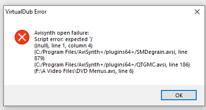

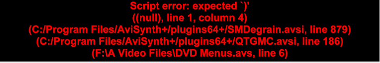

Well everything was going swimmingly well, when AvsPmod decided to spit an error at me when i tried to load up another video (and any avi video for that matter, even ones that loaded fine before)
[Attachment 54349 - Click to enlarge]
I've updated to the latest version of AvsPmod, but still getting an error. No idea what to do..Code:SetFilterMTMode("DEFAULT_MT_MODE", 2) SetFilterMTMode("QTGMC", 2) AVISource("F:\Video Files\Video.avi") AssumeTFF() AssumeFPS(25) QTGMC(preset="slow", matchpreset="slow", matchpreset2="slow", sourcematch=3, Lossless=2, TR2=2, EdiThreads=2, border=true) Spline36Resize(1280,720) Prefetch(5)

Do you have current version of Zs_RF_Shared.avsi ?
Also check your pathsCode:https://github.com/realfinder/AVS-Stuff/raw/master/avs%202.5%20and%20up/Zs_RF_Shared.avsi
eg. F:\A Video Files\... is printed in the error message... but that does not match your script F:\Video Files\ -

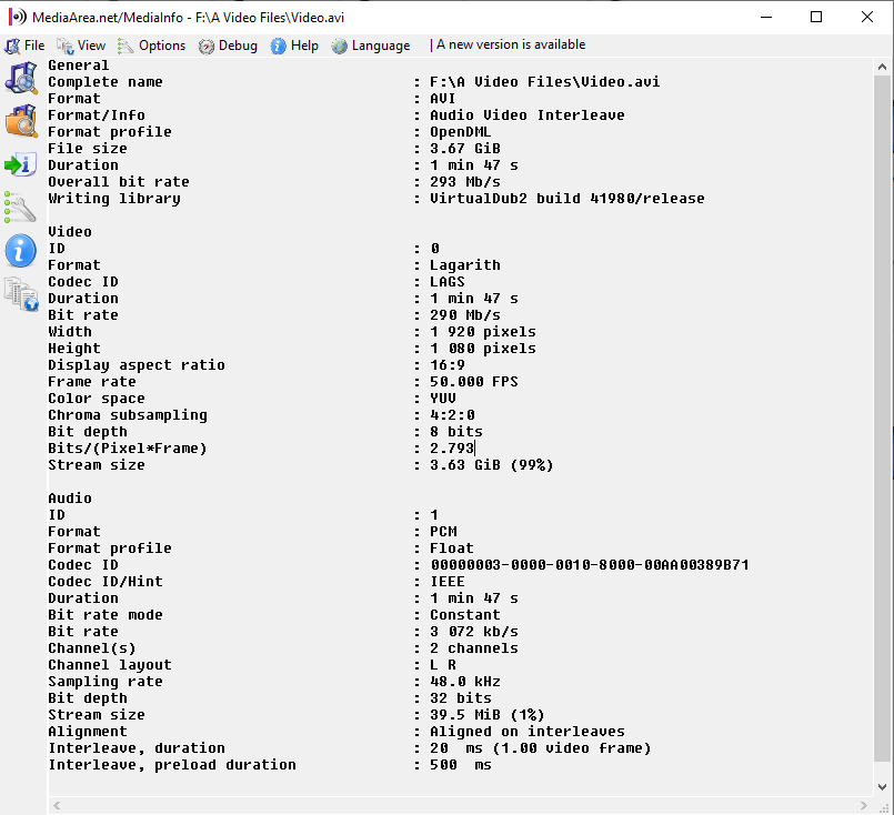

I always make sure to change the pixel format to YUV420 when the default is left on RGB, and export as loseless AVI via Lagarith.

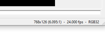

Though here's something interesting i just noticed. AvsPmod is recognising the file as RGB with 24fps.

And here is the MediaInfo to show it isn't the case.
[Attachment 54357 - Click to enlarge]

When lagarith is left on "RGB (default)" it actually uses the input colorspace . eg. If it's fed YV12, output is YV12 , assumuing "full recompress" was not selected
768x126 is weird too
What do you get with AVISource() only ? Or other source filter only , such as FFVideoSource() only , or LWLibavVideoSource() only

AVISource() only loads fine. FFVideoSource() and LWLibavVideoSource() loads the avi after a bit of hesitation. But with QTGMC on, always get the same error either way.768x126 is weird too
