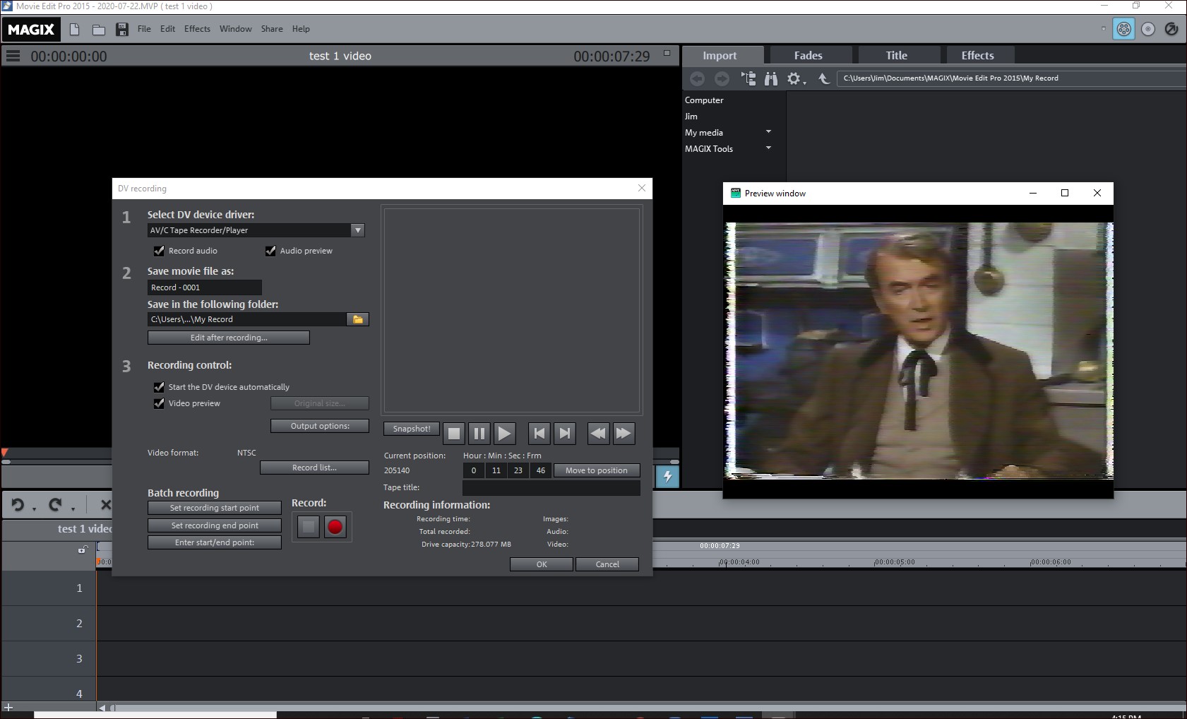

  1. I have a problem with capturing VHS tapes to MEP 2015 via Firewire. I have installed the Legacy Firewire driver for my WIN 10 desktop computer, and have used my Canon Elura 60 camcorder to capture the tapes made with the camcorder with MEP, with no problem. However, when I attached my VCR to the camcorder to use that device to capture the VHS video via Firewire to MEP, nothing was captured or even shown on the MEP preview screen. (The camcorder manual specifically says that it is designed to capture and digitize analog video with the camcorder.) The MEP interface shows that the device is recognized (“Microsoft DV camera and VCR” – see screenshot).
    My ultimate goal is to use a recently purchased Canopus ADVC300 video converter as the interface between the VCR and MEP, which also uses a Firewire connection. When I hooked up that setup, MEP also seemed to recognize the device (“AV/C Tape recorder/player”-see screenshot, with Canopus window showing VCR feed). I am not sure if this is the correct device designation, however. Other posts suggest that different selections can be made with the dropdown box, but MEP doesn’t offer any selections, it just chooses one for the connected device, with no other options.
    Any suggestions as to how to fix this? I am willing to upgrade my MEP if needed.

    For any camera to work in this way it has to 'pass-through' the analog signal from the vcr to the PC. So you have to check your camera's manual for any input setting.
    Rather than try to use that software, I would suggest using WinDV to transfer the video to the PC and use your software for the editing. That you can see the video in the preview shows that the ADVC is working and is correctly set for analog-in (I found that I had to invoke the Picture Controller software that comes with the ADVC (simpler to use than fiddle with all the buttons in the top)
    The device name is correct.
  3. I will certainly give that a try, if it is still available for download. When using the Canopus device, I was connecting to the PC directly via Firewire, bypassing the camcorder. I mentioned the camcorder (which was set up properly, per the manual), as I thought that this may be a Firewire issue that I was unaware of, since both methods weren't working.

  6. Thanks for your help. I was able to capture the video using the ADVC300 directly to the computer with WinDV, just as you suggested (and needed to use the ADVC software to make it all work). Do you know of any good tutorials for the ADVC? I am new to this, and find the manual confusing, with jargon I don't understand. When I try to adjust the various settings with the software, I can't see any real change in the video (other than the basic color/contrast, etc adjustments), at least not as far as getting an overall sharper video. It is definitely better than the USB capture cards that I first used, and got rid of OOS errors. Or am I expecting too much with the basic VHS material that I have?
