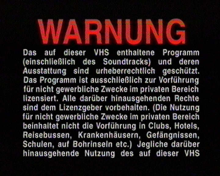

    I captured a PAL VHS with both EasyCap and Hauppauge USB-Live2 using AmaRecTv 3.10 on a Windows 10 PC. Now the problem is that the result of USB-Live2 looks very bad. Even totally still images are jittering, and it looks like there is a fly screen all over the picture. Also the audio of the USB-Live2 has constant static noise whereas the EasyCap sounds clear.
    On AmaRecTv I set: w=720, h=576, fps=25.00, fcc=YUY2, bit=16
    I set the USB-Live2 to PAL_B video standard which should be fine for a German VHS. I didn't set anything for EasyCap when using it because it showed up as a webcam and I could only set some basic options like contrast.
    For both devices I'm using Huffyuv codec and for the USB-Live2 I'm using the latest Windows 10 drivers from https://hauppauge.com/pages/support/support_usblive2.html#drivers
    I bought the USB-Live2 after the EasyCap to get better quality but it looks like the total opposite.
    Something I also noticed is that the EasyCap picture is more zoomed in. I guess it's a resolution problem.
    I attached screenshots of the same still image from both devices. The first one is from EasyCap.

    Upload an actual 10-20 secs sample from each device - the same sequence if possible. A single picture does not say anything.

  10. @Sharc Here are the files as recorded by AmarecTv. I just saw that I used Lagarith for the EasyCap version and Huffyuv for USB Live2 if that makes any difference.
    @ DB83 I set the lossless Huffyuv encoder in AmaRecTV. I don't know if I can also set lossless in the USB settings.

  14. I would assume that the VHS source is interlaced. The Huffyuv .avi is interlaced acc. to Mediainfo, whereas the Lagarith has no flag, maybe Amarec deinterlaced it?. So it's unclear what the encoder will do as per default, and the comparison is not very meaningful.
    The Huffyuv should either be encoded as interlaced or should be (bob-) deinterlaced for encoding.
    It would be more helpful to have a sample with horizontal motion or a camera pan rather than just rolling text.
    The codec and the capture settings should be the same for comparing the 2 devices.
    Do both use the same interface? Or is USB via Composite Video and Easy Cap via S-Video? The USB shows a lot of dotcrawl but keeps also more picture details.

  20. Originally Posted by DB83 View Post
    Actual quality can not be the same since the bitrate is different as is the codec.
    No. They are both lossless codecs. If handled properly the YUY2 video that comes out of the decoder is exactly the same as the YUY2 video that went into the encoder. Of course, the size of the compressed video may vary depending on how much the codec was able to compress the data. But the output of both is identical to the data that went into them.
    Well I just did test VHS capture using lagarith in vdub to compare with one I did earlier today in Amarec for a different topic.
    Neither show any interlacing flag
    The AVI container doesn't really support an interlaced flag (the ODML 2 extnsions do but few programs use those). And neither codec has a private interlace flag. It's up to the user to keep track of interlacing.
    I've only really looked at the mp4 files. Although the EasyCap has better horizontal time base and less noise it's inferior in almost every other way. The EasayCap has less noise because it's been through a noise reduction filter. It's much fuzzier than the USB2 cap. The noise in the USB2 cap can easily be reduced with much better results. The EasyCap has also been deinterlaced and zoomed, loosing the four edges of the picture. It has blown out brights which cannot be recovered (maybe this can be adjusted with the capture device's proc amp settings).
