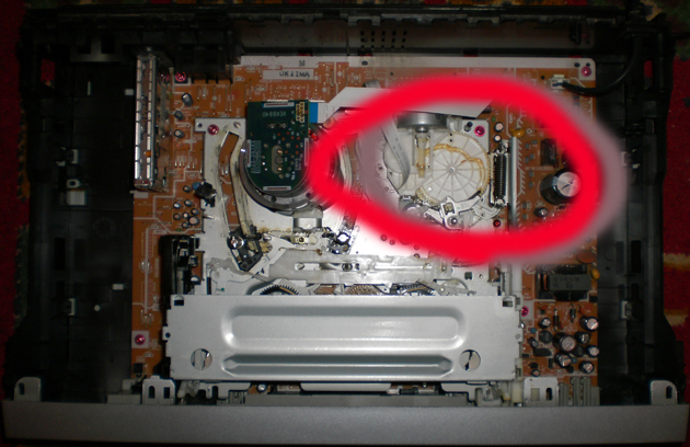

  1. Hi guys how can i get rid of this blue screens https://www.youtube.com/watch?v=ciPUJ1h8GRQ
    Using Easycap.Tryed many software,in VirtualDub even cant choose video source(empty space)

    The problem is your VCR not locking on tracking, Clean the VCR tape path, just google it if you don't know how.

    Cleaning tape does not clean a severely dirty VCR, You need to clean the stationary audio/sync pulse head with qtips and alcohol until all the gunk is removed, also check the sync pulse head ribbon cable, firmly attached and no corrosion in the pins. Look up your model to learn all parts locations.

    On the right side of the video drum, it looks like an audio cassette head with a ribbon cable attached to it, clean all the area that touches the video tape.

  9. Done,audio is better but still problem with image,blue screen appear and disappear

    If alcohol couldn't get the gunk out of the stationary head try WD-40, wet the q-tip away from the VCR and clean the stationary head, The sync pulse head is the one on the bottom, finish up with alcohol to remove WD-40 from the head. Don't worry about the video head it's already clean as seen in your video.
    If the problem persists, possibly bad pinch roller, Observe the tape while moving across the audio head, does it look stable as it moves or wavy?
    Another possible reason is that the VCR is trying to lock in automatic tracking but it can't due to badly recorded tape, Try to disable the auto tracking if available, Some VCR's use Ch+/Ch- to engage manual tracking.

    It looks like a newer Panasonic VCR, as far as I know they don't let you turn it off.
    Another things you can try is to re-seat and clean the ribbon cable that goes from the A/C head to the PCB, including the contacts. (WIth isopropyl alcohol or contact cleaning spray).
