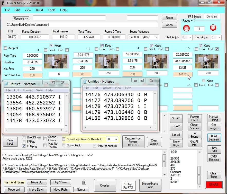

    Notice in the example below, the end cut is made 1 frames in front of the 'P' frame 14176 because FFMpeg usually requires 1 frame to stop.
    ffmpeg -ss 0.000000 -i "C:\Users\Bud\Desktop\cgop.mp4" -vframes 14176 -c:v copy -c:a copy -y "C:\Users\Bud\Desktop\3_0_cgop.mp4"
    The above string will cut from time 0.000000 through 447.985342 exactly
    [Attachment 54283 - Click to enlarge]
