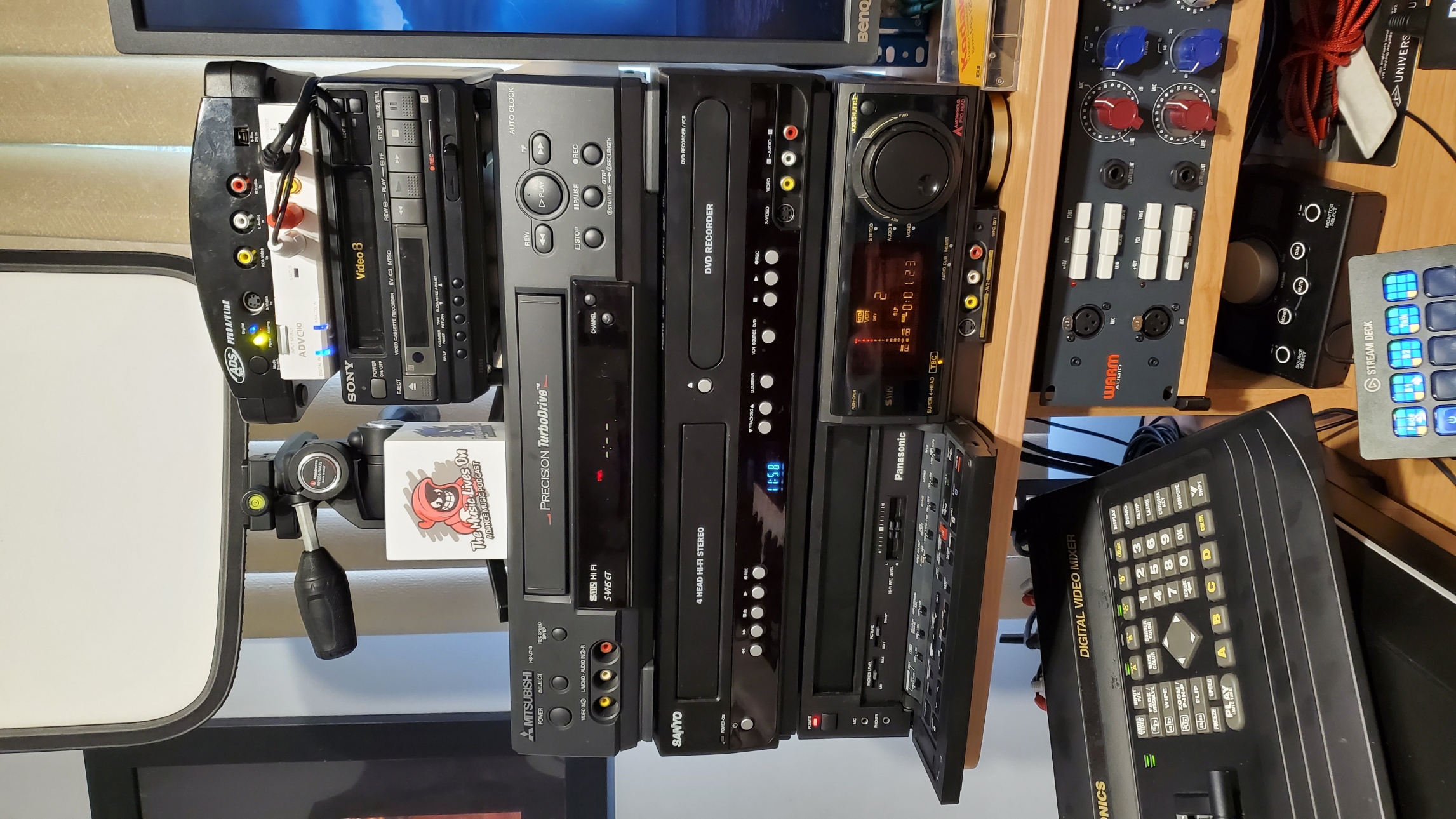

    OK all is going great. Started converting old VHS family movies and they look amazing. You were right the AG-1970 looks amazing. Also converting the DJ tapes and they sound great too. One question.
    The Manual says to reset the tape counter to zero press reset. I do not see a reset button anywhere on the unit ?
    [Attachment 54415 - Click to enlarge]
  11. The one function you cannot operate from the front panel of the AG1970 - 1980 -5710 is the counter reset: that requires a button on the remote. Usually not a problem since the VCR will automatically reset the counter when you load a tape, but if you tend to use the counter in a non-linear fashion you'll want a manual reset function.
