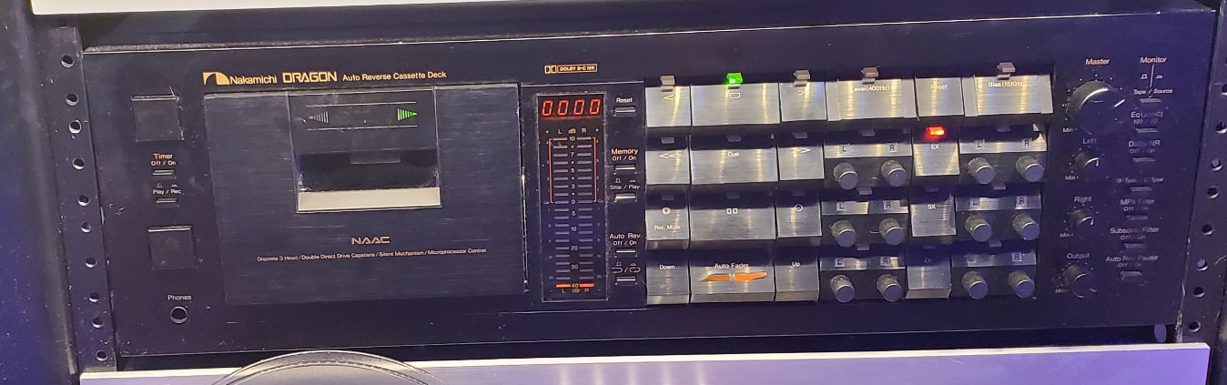

    Yes I purchased a Nakamichi Dragon and it did not work. I had to send it out and have it serviced. They replaced all of the Caps and put it back into tip top shape. I dont blame Southern Advantage for selling new old stock but agree with you that all the caps are probably in need of replacement after this many years just sitting in a box. I also saw one on that site for $1,800 which is crazy.
    I do have some older VHS family tapes I would like to restore but I dont think I need a 1980 for that and as you know, I am more interested in the audio playback at this point in time. I used to own a Mitsubishi but I think I threw it out (how dumb) But thanks for all of the options. I hear that JVC were the developers of TBC (not sure if that is true) but I do own the Videonic that has built in TBC so I can always use that in the signal chain. I guess I am looking for something around $300 that is a good value and will be better than my current Sanyo which I bought from B&H. If I found this site earlier I probably would have skipped the Sanyo. I bought it for the silly DVD burning capability but now that I have a canopus capture card using fire wire and a fire wire card in my PC I dont actually need the DVD burning capability.

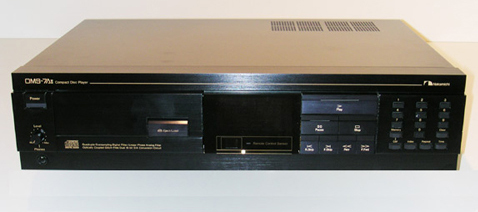

  17. JVC didn't invent the TBC/DNR feature from scratch, but they did flog the hell out of it on their higher-end SVHS VCRs to a degree no other mfr attempted (JVC offered countless VCRs with TBC/DNR over two decades). Panasonic had it in maybe two utterly forgotten (and dismally unreliable) consumer SVHS models from 1992-1995, Hitachi and Toshiba put oddball versions in one or two models that few remember (and fewer purchased), Sony never bothered at all in their VHS VCRs. The feature is a bit tricky to implement properly: Panasonics early TBC version was weak and also hamstrung by the horrendous color mistracking that plagued their 1992-1994 lineup. JVC updated their circuit occasionally but it remained fundamentally unchanged, and no other mfr wanted to sink the money required to truly equal it (or pay to license it).
    Panasonic put a slightly improved TBC/DNR in the AG1970, but by JVC standards its vestigial. The one and only serious challenger to JVCs dominance was the single Panasonic AG1980 model, which arguably betters JVC in some respects that some tapes greatly benefit from. Unfortunately the AG1980 TBC/DNR was a rattletrap bespoke trainwreck of unreliability, very expensive to mfr or service, so Panasonic never refined it or offered it in other models aside from the one forgotten AG5710 (which is merely an AG1980 with obsolete computer interface and no tuner). The JVC TBC/DNR is efficient and microchip based, Panasonic's AG1980 TBC/DNR is huge board full of discrete bits, similar to a Tandberg 3100 FM tuner (IOW, an engineering disaster). Very very late in the game, Mitsubishi randomly decided to market their lone HS-HD2000U DVHS: this has a TBC/DNR that operates and performs so much like JVCs its either total plagiarism or they licensed it. The Mitsu 2000 is one of the most rock-reliable VCRs I've ever owned, but it isn't great at HiFi tracking or 6-hr video tracking.
    The Nakamichi Dragon cassette deck is indeed kinda like the Panasonic AG1980: incredibly high performance when it works, but they didn't survive the decades well and repair people who truly know how to restore them are scarce and expensive. I didn't prize cassette performance enough to rob a bank for the Dragon, but back in that era I did blow a months paycheck for the amazing top-line OMS-7AII CD player (which I still have and still prefer over any high-end player I've heard since I got it used from a dealer in 1988). One of the few occasions when my timing was lucky: the 7AII had recently replaced the original 7, which quickly became a cult CD player and repairman's nightmare (unobtanium vital replacement parts). Aside from periodically needing a new hard-to-source belt for its suspended-sub-chassis laser drive (and the headphone pot failing last year), my 7AII has been remarkably reliable for a vintage Nakamichi product.
