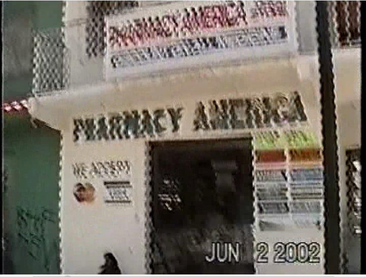

  1. I'm in the process of transcoding a bunch of DVDs of old home movie captures for use on a Plex server. The first half of DVDs contain footage from a camcorder that recorded directly to VHS tapes, circa 1989 to 1998. The second half are filled with footage from VHS tapes which themselves were captures of DV cam footage (from about 1998 to 2005). I know this capture approach was not optimal for a variety of reasons, but I wasn't involved in the initial captures, so this is what I'm stuck working with. All footage is interlaced, but only the second set looks terrible when any sort of de-interlacing is applied to it. I tried every de-interlace option in VLC, as well as playing with interlace options when I transcode in Handbrake, and every single one of them looks terrible--the non-deinterlaced footage looks much better. The reason is that whenever there's any sort of fast movement in the camera short (a quick pan or someone moving quickly), the de-interlacing makes the image look like it's "swimming":

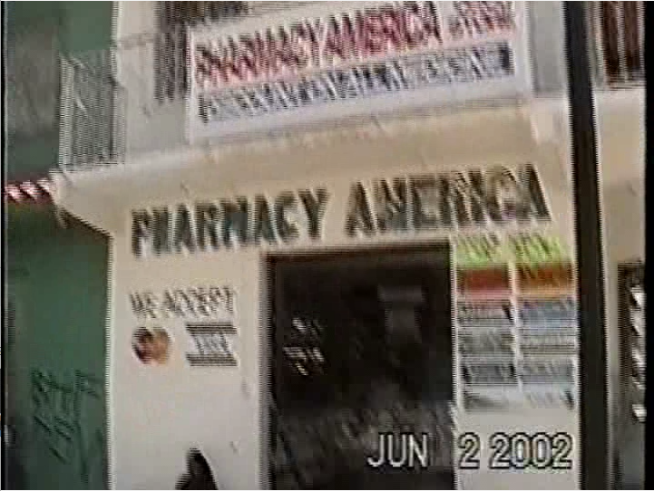

    If I turn off de-interlacing, it looks like this:
    [Attachment 54248 - Click to enlarge]
    Still not great, but considerably better than the first image. My question is: how do I de-interlace this footage so that it doesn't look terrible?

  2. Those artifacts are usually the result of interlaced video being resized vertically without consideration for the interlacing. The two fields are no longer separate images and can't be deinterlaced properly. You should upload a short sample of your MPEG 2 video for further analysis. Use a program like DgIndex or Mpeg2Cut2 to select about 10 seconds with the problem (medium speed horizontal panning shots are good for this). Upload the sample here.

    As jagabo speculated, it was resized while still interlaced at some point, perhaps from an original 352x240.
    Using this script:
    MPEG2Source("test.d2v")
    BilinearResize(360,240)
    separatefields().SelectEven().AssumeFieldBased()
    Weave()
    QTGMC()
    BilinearResize(720,480)
    I got this (which can probably be improved upon):
  6. Yes, the MPEG 2 video was resized vertically while interlaced. My guess is somebody removed the head switching noise at the bottom of the frame and resized what was left to refill the screen. About the best you can do with video like that is fully blend the two fields together (leaving what looks like double exposures). Here's what I did in AviSynth.

  7. Thanks! This looks pretty good. Is there any way to tell what the original resolution was? Like I said the before, the VOB shows a resolution of 720x480 in VLC.
    Jagabo, how much fidelity am I losing by doing that blend you're suggesting? It's possible that I may try to get all these videos re-captured from their original source, and if I do it this time, I want to make sure it's done right.
  8. Originally Posted by P-Rock View Post
    You're losing a little vertical resolution, losing half the temporal resolution, and getting frames that look like double exposures -- which is essentially what they are.
    The original video was almost certainly 720x480. I suspect someone enlarged it to 720x540 (a 4:3 frame size) then cropped away 60 lines (some from the top, some from the bottom) leaving 720x480. If you have them re-captured you should get 720x480 (or 704x480), 29.97 fps, interlaced. That's the international standard for NTSC capture. That can be encoded directly to MPEG 2 for DVD (if you filter you need to be sure to use interlace aware filtering). When done properly you will have two clean fields in each frame. You will not see comb artifacts on playback, you won't have those scalloped edges, and you won't have images that look like double exposures. If you don't want DVD, but rather progressive video for upload to youtube (or whatever) you should use AviSynth and QTGMC to deinterlace the video.
