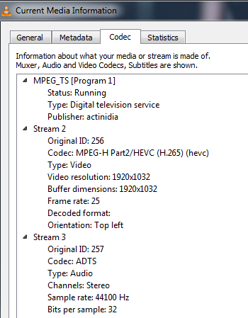

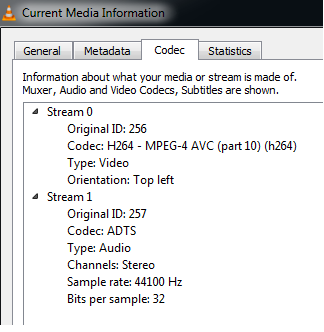

1. The blank screen's codec info:
[Attachment 54242 - Click to enlarge]
2. The MPEG_TS codec info:
[Attachment 54241 - Click to enlarge]
